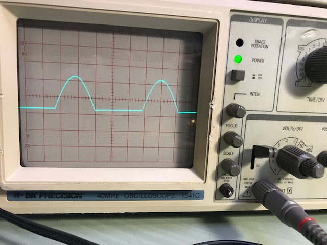

I did get the scope, and looked at the speaker out on all the channels. The two bad ones are putting out the upper half of the sine wave only.

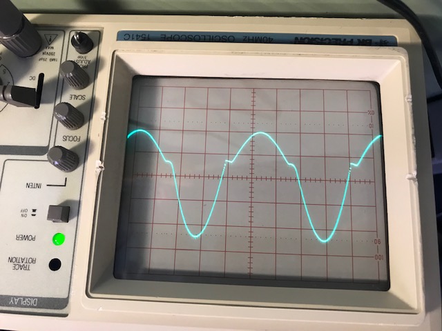

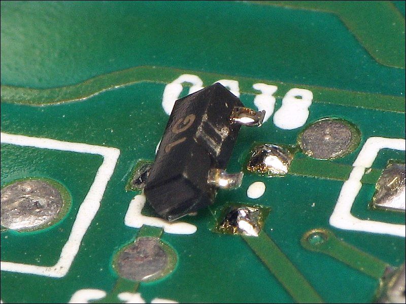

No obvious problem with Qx19. I don’t think I can pull it to really check without destroying it because it’s all surface mounted. I probed around and distortion starts at Q104, the input is clean, the output is a misshaped wave with a smaller bottom than top, and a notch in between. The good channels look clean on three pins of this chip. Kind of lost on this, but it seems that the problem is in the low level circuit.
Don't describe the waveform, post a photo.
You don't have to harm the SMD transistors to desolder them. Apply extra solder to two legs and heat both at the same time and lift the transistor. Then desolder if there is enough to bridge to the raised terminals.
OK, posting pics, hope they work.
Looking at Qx04:

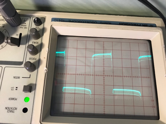

Pin 5 has this:
Pin 3 and 4 have this:
Pin one and two have this:Sign in - Google Accounts
Pin 4 goes to the collector of Qx07, which has no signal on the base or emmitter.

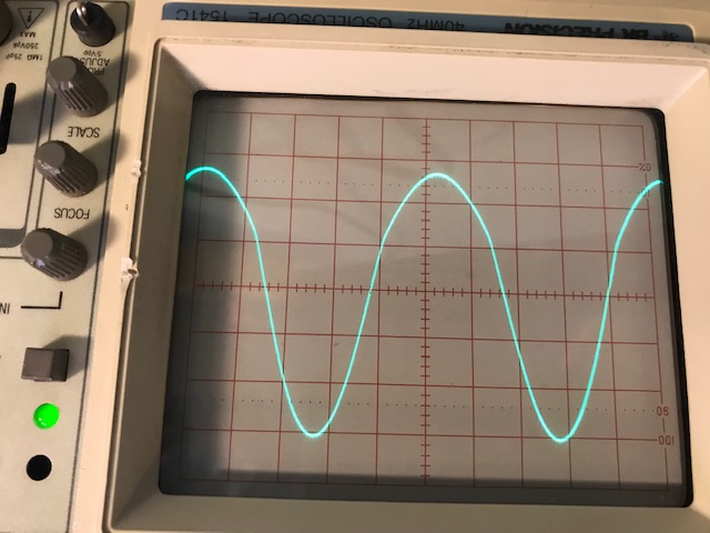

On the good channels pin 3, 4, and 5 of Qx04 have a sign wave on them, and a the same signal as pin 1 and 2 on the bad channel

Pin 5 has a good sine wave
Pin 3 and 4 have the weird looking sinewave
Pin 1 and 2 have the squarish looking wave

I don't know how we got to those transistors. The output isn't clean so the feedback to those transistors won't be clean.
