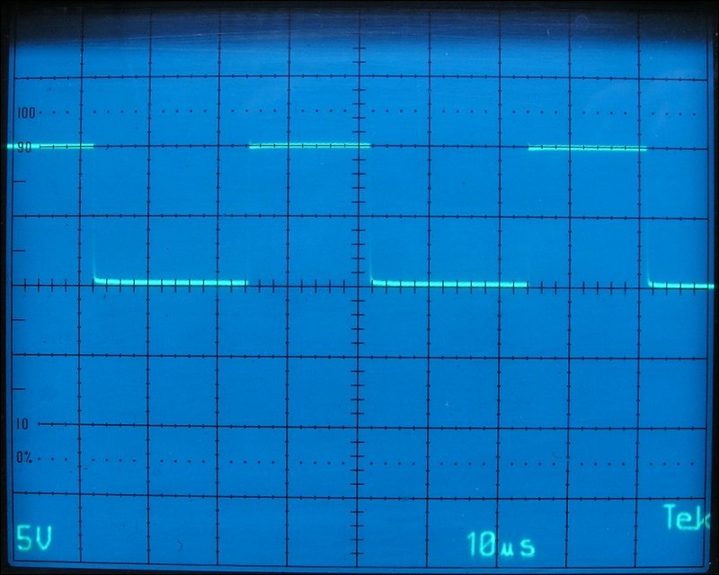

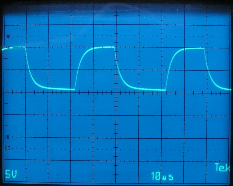

When you load the FET location, you look at the curve produced by the drive circuit and make sure it's pulling up and down as expected. The first image below is an unloaded drive signal and even though it looks OK, it may not be if the driver components are working 100% as they should. Loading it changes the signal to what you see in the second image. You can see that it's changed but it's being pulled up and down. If it had a bad drive component (most commonly a bad PNP driver transistor), the signal wouldn't go down nearly as far as it does in the photo.

If the output FETs are out of the circuit, that doesn't look unexpected. Why do you think that shows a problem?
yes no outputs on board, put them in and give it a go? scope - wire was connected battery negative, is that right place? i tried to measure irf3205, it kinda looked like your second picture but wasnt that clean, havent use this type of "scope"
Without seeing the waveform, I can't comment on it.
Install the outputs for the previously good channel and confirm that it's still OK, then install the ones in the other channel. Set the bias pots fully counter-clockwise before powering the amp with the outputs.
