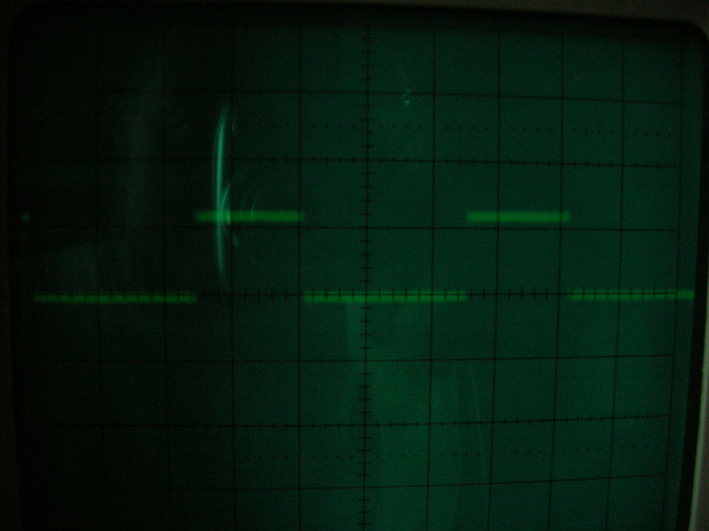

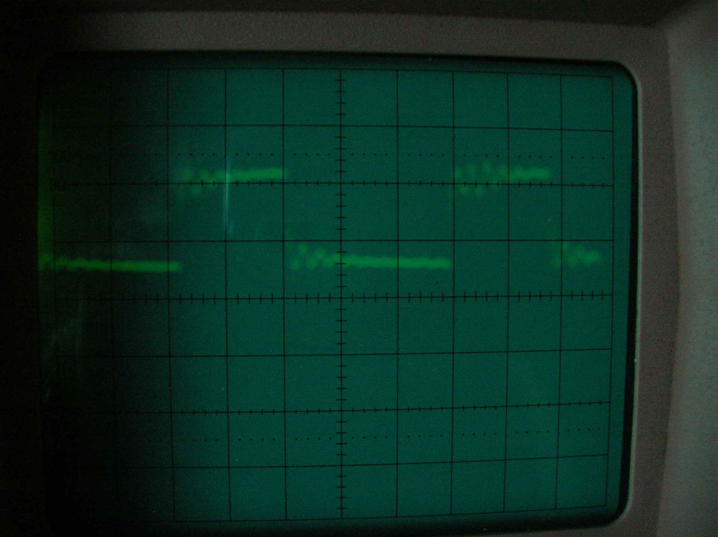

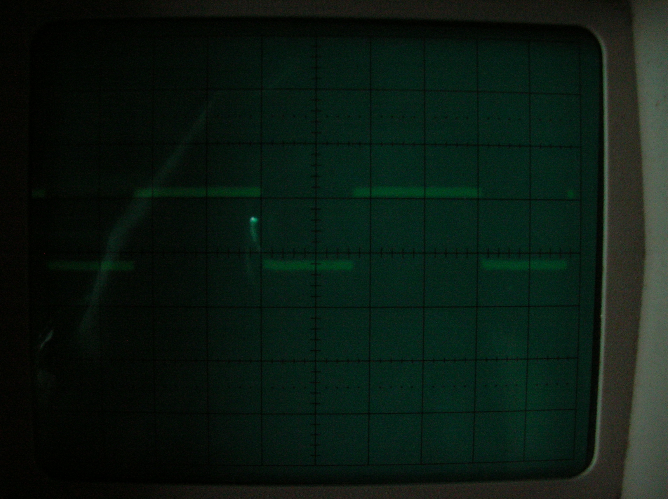

Checking the signals without the output transistors will help determine if the driver circuit is working properly. The use of the potentiometer helps find major faults but does nothing to determine the high-frequency performance of the driver circuit.
Were you driving an audio signal into the amp?
If so, remove it and post new photos. If you did not, touch your probe to either of the two test points below the display and adjust the scope so that you get a clean square wave. Post a photo of that test signal.
I have adjusted the best I could, (if not well, let me know, Perry)
first photo pin1: Q106
second photo pin1: Q103
(note: in the two signals, the line is swinging two or three millimeters on each side)
Thanks, Perry

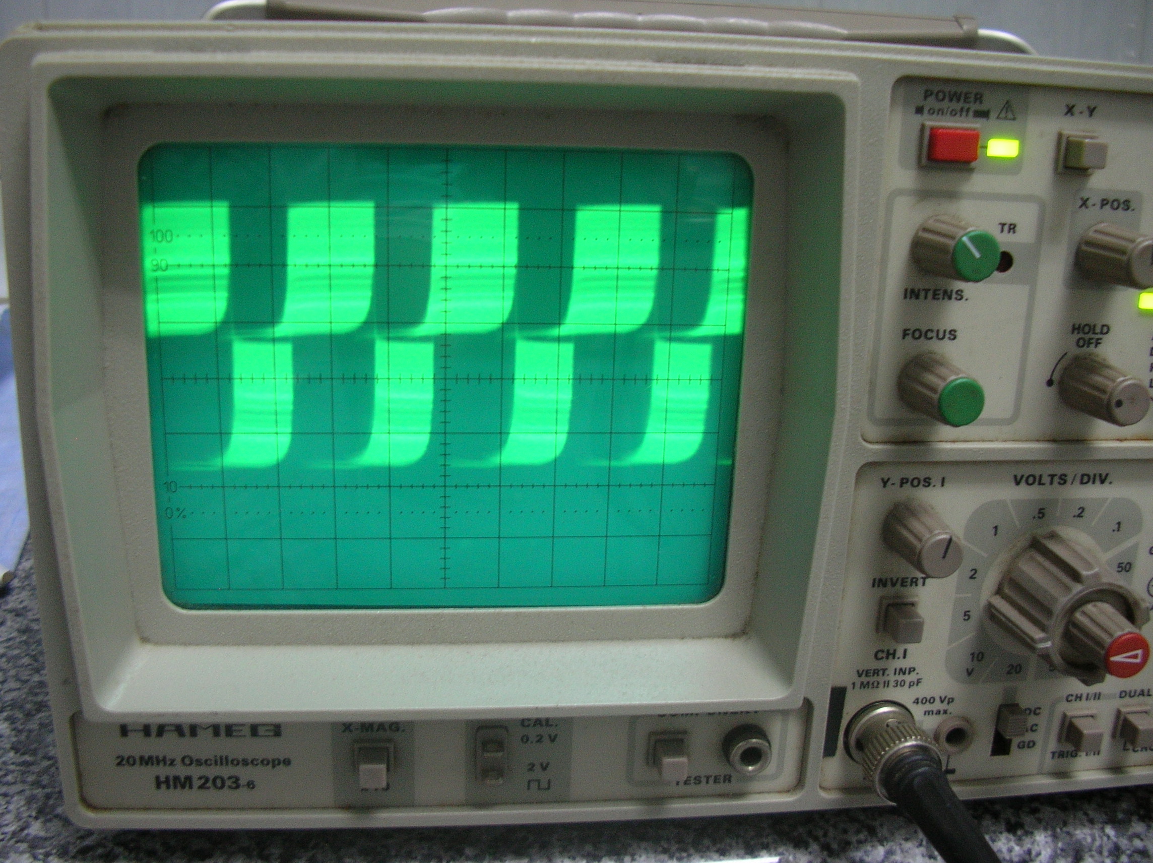

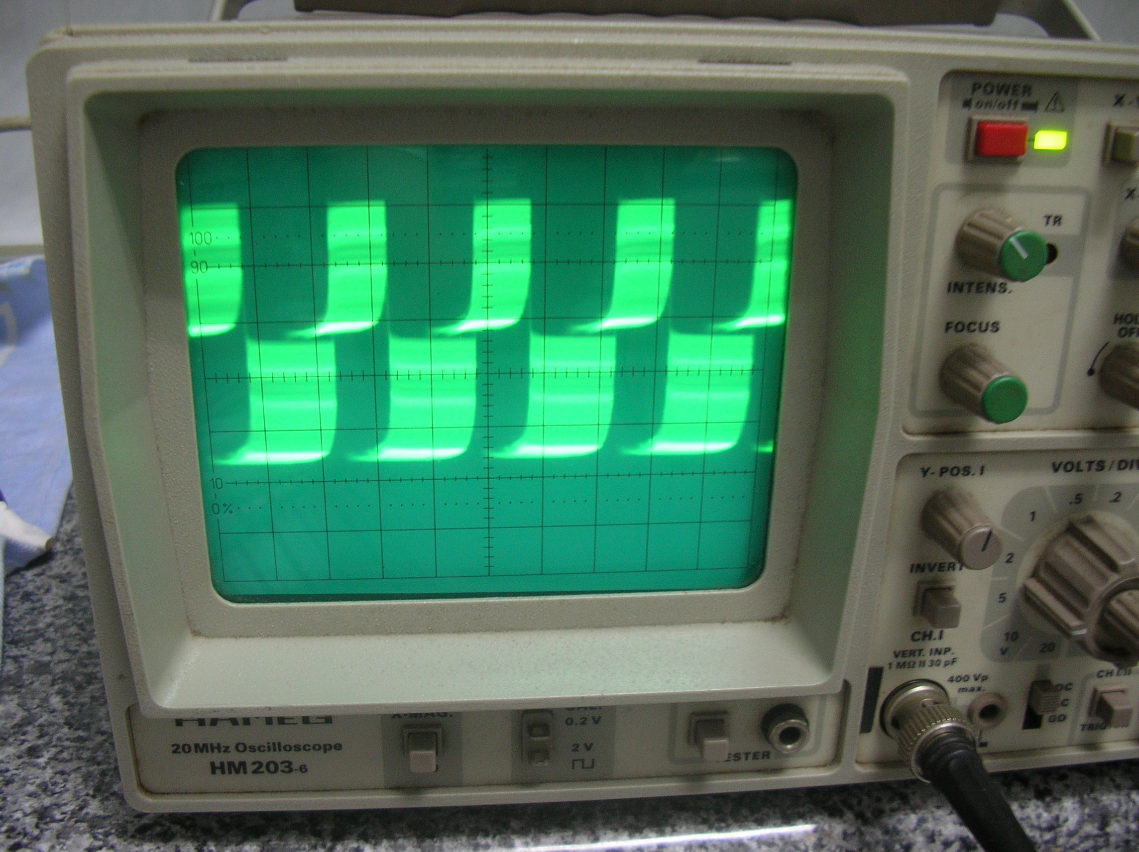

By checking the waveform with the scope, in Q103, I have seen that in the beginning of the cycle, saturated a bit, and wanted to know if this is permissible, before installing the mosfet, (see photo) (Q106 is correct)
What do you think, Perry?
I wanted to make sure, before, everything was like last month ...
Did you have the 3rd pad for Q103 connected to the negative speaker terminal (no outputs in the circuit)?
True, Perry,,, I forgot ... what a head I have!
Fortunately, that is always there to avoid my mistakes, again, thank you.
I've rechecked and is perfect.
