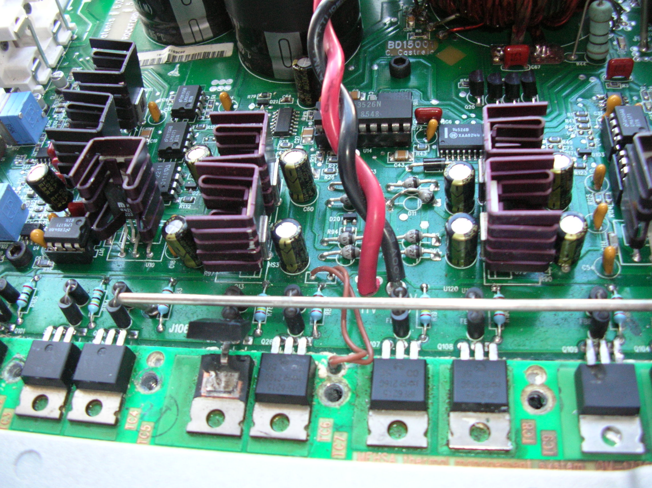

When connecting the speaker produced a bit of pink noise (sssshhhhs and 0.5 V at the terminals) but I had to remove it soon, because I saw some smoke out around R180 or R181 (not sure, but next came there )
I disconnected the speaker and I started to check voltages, for example, I saw that tensions had risen U5 (pin 2: -5.09 and pin 6: 8.26) also in U17 (pin 6: -5.75)
The explosion:
When I was checking U8 (pin 2: 5.77) and touching the pin 3, not sure if I have a short between pin2 and pin 3 with the probe (I have inspected the probe and the IC pins and no trace of the spark), the case is, who have exploited Q12 and Q109 (see picture of how they have been)
Do not know what could have happened, I unsoldered the group of eight mosfet, and found six in short, in its three terminals!
What do you think Perry?
I'll start from scratch, and I will order more parts ...
Again, I again thank you for your help, Perry
The day I get repair this amp, I'll open a bottle of champagne ...

The voltages on U7 were better.
Desolder and remove the other 8 FETs from the board (don't desolder them from the MEHSA insulator).
Do you have a spare potentiometer (4.7k ohms to 100k ohms will work)?
A potentiometer 4.7 k, or 100k? What value?
Do you mean? tell me the value and buy it tomorrow ...
Buy a 10k potentiometer, preferably one that you can hold easily (not too small) and with a shaft that you can turn with your fingers.
Well, I have the 10k pot, and I removed all of the output MOSFET.
Now, do you want to solder the pins on the potentiometer pins 2, 4 and 7 of U17?
