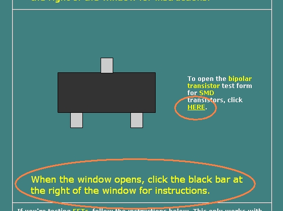

I don't know where the transistor is but it's likely near the bias pot.
I don't know if it's the same as the ix. I have the x2 schematic. Email me if you want it.
babin_perry@yahoo.com
Go to the following page and click the circled link. Read the circled text also. Send me the screen cap for Q221.
Basic Amplifier Repair - Transistor Test Applet Link
