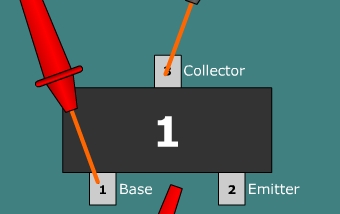

From the screen cap, Q221 appears OK (assuming that it was checked in the board).
Check R265. Is it within tolerance?
If so, pull Q212. Does the amp still have positive rail voltage on the speaker terminal (black probe on chassis ground)?
With the amp powered up and the black probe on chassis ground, post the DC voltages on Q219, 220 and 224. For the SMD transistor, the pins are 1 and 2 on the bottom (left to right) with 3 on top.

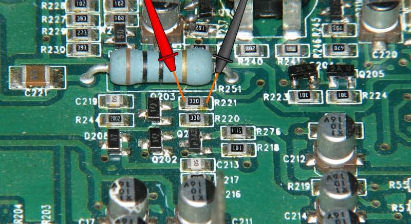

What is the voltage on the terminals of Q202 and Q203 (see attached for layout)?
Q202
Pin 1:
Pin 2:
Pin 3:
Q203
Pin 1:
Pin 2:
Pin 3:

Should i test Q202 and Q203 with the black on the amp ground?
Pin 1: .89v
Pin 2: 14.47v
Pin 3: 31.90v
I test this with the black on amp ground and red on the Q212 pins. Is this right?
Q212 pads
Pin 1: .089v
Pin 2: 14.48v
Pin 3: 31.90v
Q212 pads
Pin 1: .089v
Pin 2: 14.48v
Pin 3: 31.90v
It appears that Q203 could be defective. What's the DC voltage measured directly across R220 and R221?
