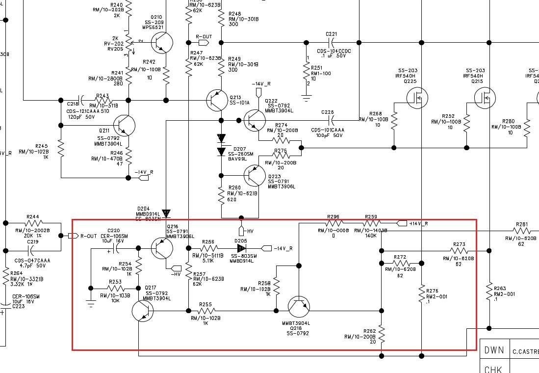

With D202 and D204 removed the channel plays clear and it seams a little louder then the other channel.
I understand that you don't have a scope but for instances where a scope was available, this thread would have stopped about 120 posts back. That's how important having a scope can be.
Reinstall one diode at a time and re-check. For the diode that returns to a distorted output, check the protection circuit transistors that are connected to that diode.
Ok Is there a scope that you would reccomend that wont brake the bank? Iam just working on a couple amps trying to lean a little more about them and doing this as a hobby.
The static came back when D204 was re-installed. What diodes would be the protection circuit D206 and D207?
That's not static. That's the entire bottom half of the waveform being clipped off.

I tested A couple of the resistors in the boxed area and I think there are 3 or 4 resistors that are bad. Could this be the issue?
It's unlikely that all are defective. Slide them off to one pad and remeasure.
It's far more likely that a transistor is leaky or shorted.
