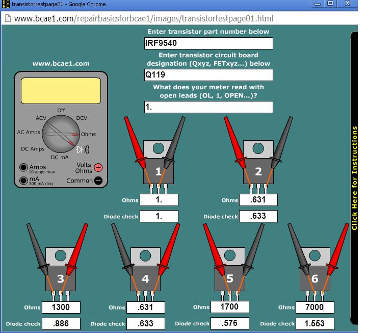

Q112 does not appear shorted. Diode check mode. Red on leg 1 (looking at the flat side of the FET) Black on 2= .995V Red on 1, Black on 3 .823V
Q212 1.896 and .821 Quite a bit different on the the first check. Pretty much the same on the second.

Q119 needs voltages on all 3 terminals.
Q119 11.2, 30.8, 30.8 VDC
