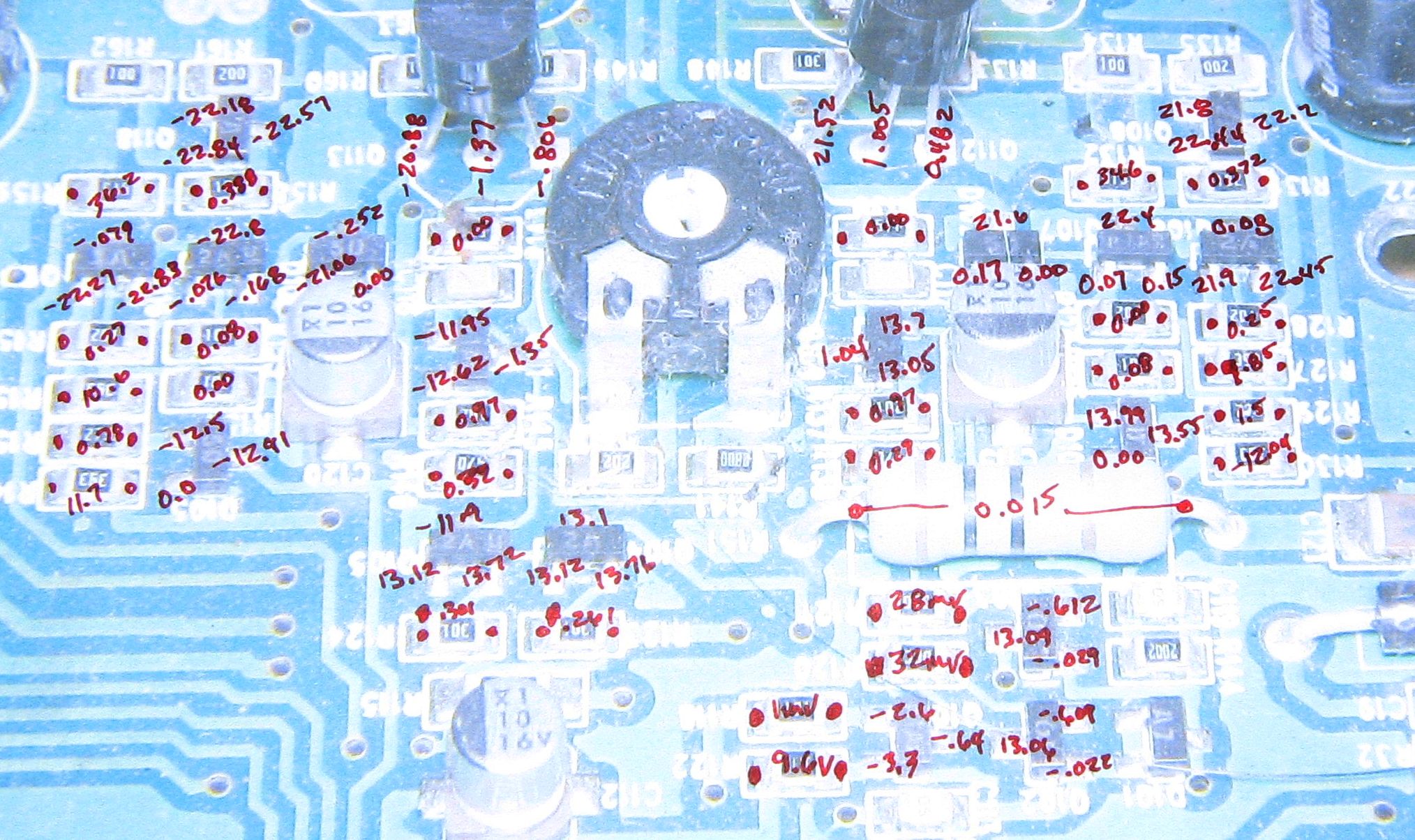

Confirmed the IRF540 and 9540 are in the correct locations. I've found that Q215 is shorted again. The short is between the drain and source. I lifted the source leg and the short remains. I'm certain I checked all legs for shorts when I received the last order and finished the soldering.
Find R122 and R276.
Before the voltage goes high on pin 14, the voltage across those resistors should be low (0v?). After the voltage goes high on pin 14, you should read approximately 10v across those resistors (both probes on the resistor). Is that what you have?
O volts to start. It then goes to 11.7VDC

Remove Q107 and Q116. Does the left channel produce clean audio?
The attached image is for a 40x2. It may be close enough to your amp to be useful. The components with a dot on each terminal have the voltage measured with both probes on that component. The transistors have the voltage measured with the black probe on the non-bridging speaker terminal which is directly connected to the primary ground. Do you see any great differences in the readings on the left channel of your amp?
I had a hard time making out some of the board designations. This is what I have so far. There are definite differences in Q112 and 113.
Q112= 11.29, 11.97, 11.26
Q113= -30.8 -30.1, +2.8
Q110= 11.95 11.95, 10.38
Q118 C= -30.6 B= -30.1 E= -30.8
Q108 C= 30.6 B= 30.1 E= 30.8
R147 -15.10 R154 0V R153 -0.49 R155 0.38 R156 0V R157 -15.15 R158 0.47
R159 44V R161 OV R160 0V R149 0V R143 0V R145 1V R146 0.38 R140 0.71
R141 0.09 R152 0V R150 0V R142 0.08 R128 0.38 R127 -15.12 R129 0V
R130 15.16 R126 0V R125 -0.74 R151 0.43
