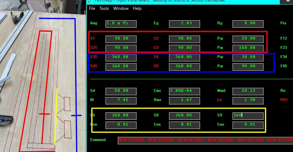

Stop please….

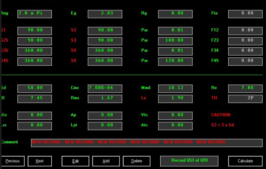

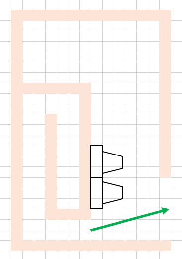

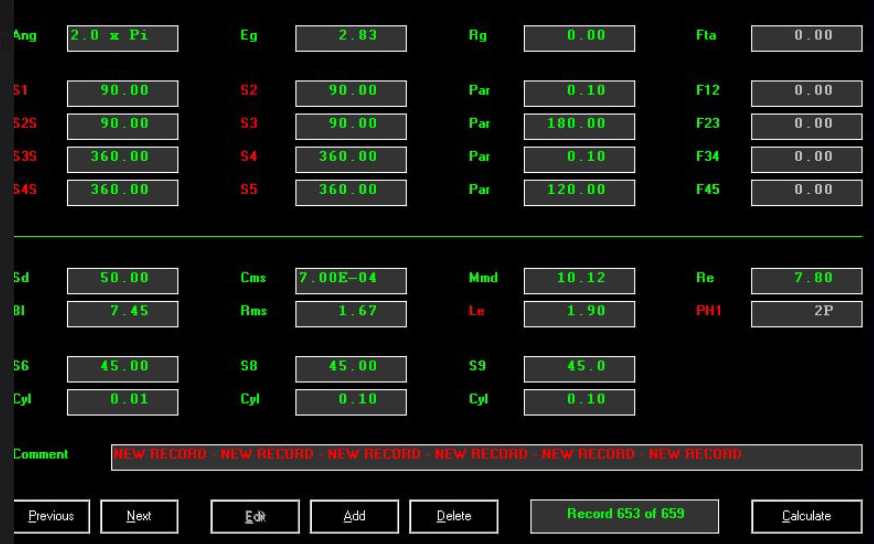

What you DREW was different from what you MODELED.
If the green is the mouth, then left pic is a stepped TH and right pic is a Paraflex enclosure.
Also, your tap point CANNOT be in the MIDDLE of a step transition.
You are basically stating that 1 driver is on the 90cm2 side and the other driver is on the 360cm2 side of the enclosure.
These 2 models prove my point.
You should NOT be able to ACCURATELY model a Paraflex enclosure with the TH function.
You can ACCURATELY model a TH enclosure with the PH function.
The PH function allows you to move the mouth regardless of the tap point.

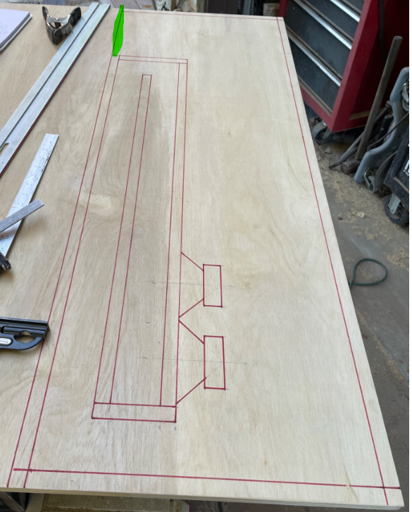

Maybe if you would build some of these boxes and measure the electrical impedances and Frequency response and overlay them with the horn response simulations in REW or something you would realize the things that you’re pointing out are completely irrelevant?What you DREW was different from what you MODELED.
View attachment 1371547vs View attachment 1371548
(or simply realize what the driver position in a resonator does and if the offset is so minuscule and high frequency , there’s no need to describe it or even worry about those detailed details)?? It’s a rabbit hole of things that don’t change anything . It seems horn response only needs to know the size and length of your resonators. And unless you’re going to do something drastically different with the driver position, then put it near the closed end none of that junk matters.?

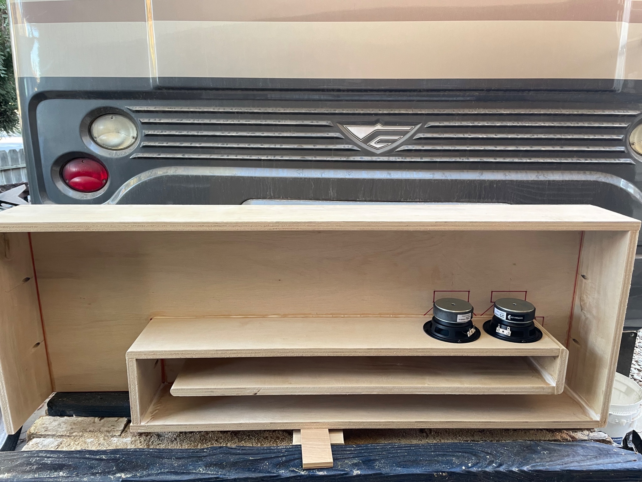

I don’t know what/how that picture you drew with a huge offset resonator has anything to do with what I built or described to horn response
It’s pretty simple ? 20cm (432hz) of offset/details isn’t gonna tickle pickle
Because YOU drew out a stepped TH and modeled it with the PH1 function, I was showing you the difference between a stepped TH and Paraflex.Maybe if you would build some of these boxes and measure the electrical impedances and Frequency response and overlay them with the horn response simulations in REW or something you would realize the things that you’re pointing out are completely irrelevant?
Using the PH1 function to model a stepped TH is the hard way of HR modeling, but it can be done.
I only build when I need to build.
New car, new build.
Damaged enclosure, new build.
Someone paying me for labor, new build.
HR modeling is fun to me. If folks choose to build or not build my models, so be it. I just like trying extract good performance out of any driver.

It’s just a tapped 1/4 wave pipe.Because YOU drew out a stepped TH and modeled it with the PH1 function, I was showing you the difference between a stepped TH and Paraflex.
The top of the paraflex section is identical to the top of the tapped horn section as far as I can tell.
Whatever it is all of these things I keep building using that section end up measuring exactly the same as the horn response simulation. That includes parallel helmholtz resonators.
A tapped 1/4 wave pipe = stepped TH in HR.
READ, the whole issue is you modeled a stepped TH with the PH1 function. It made me think you were contradicting your drawing by using a Paraflex function in HR. Most people would model that enclosure with the stepped feature within the TH function. Plus, you had a stepped transition between the 2 drivers in the PH1 model that did not line up with your drawing.

It's just a representation of driver location in 2d. just imagine it turned 90°. It's no different than asking why the driver doesn't fit the pipe.How is half the driver outside the throat?
This description of the shape of that box is very inaccurate. Maybe they (Brian Steele, etc) were trying to use that angled shape to describe some of the volume that the motor and magnet are occupying instead of air?How is half the driver outside the throat?

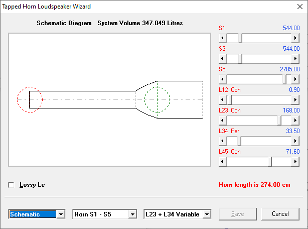

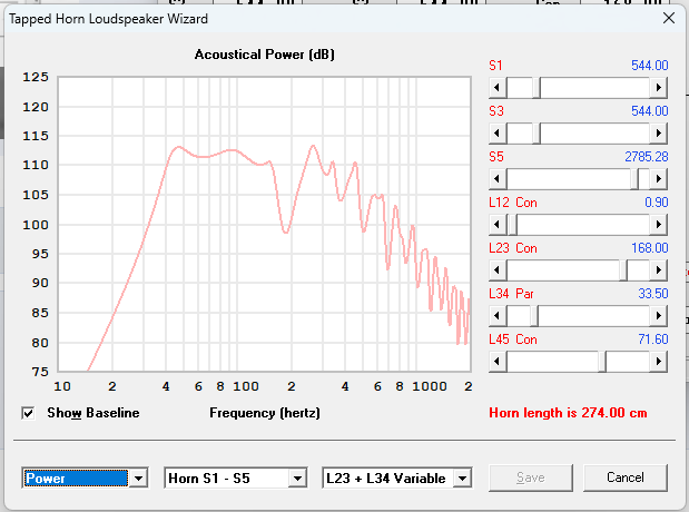

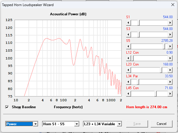

L12 = 0.90cm says different.
Let's see the HR input screen.
