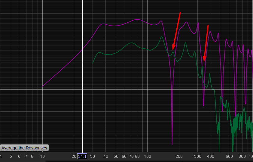

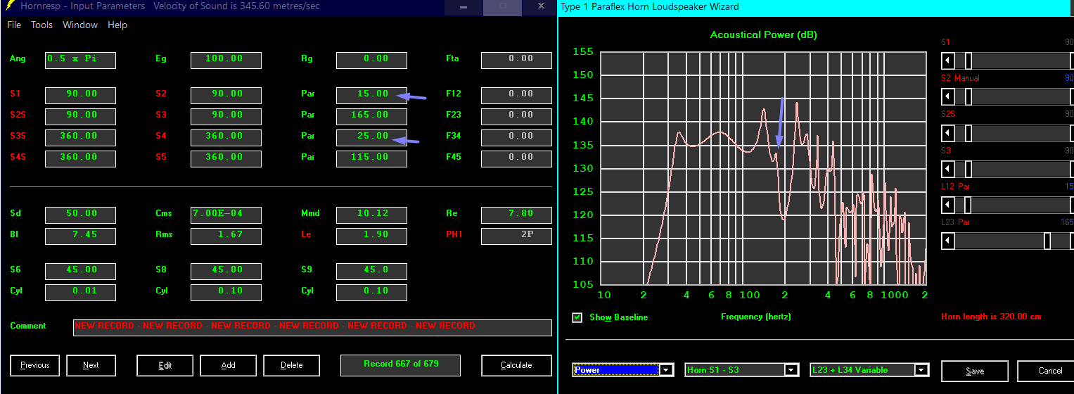

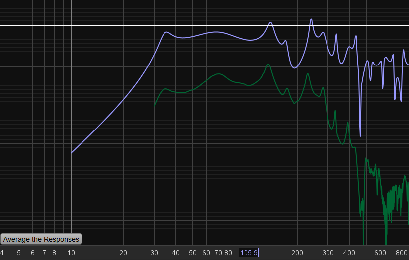

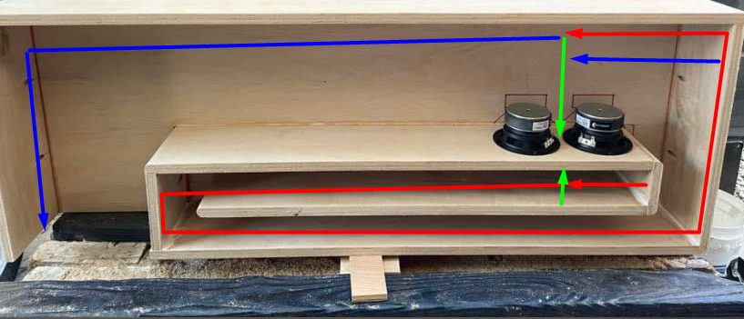

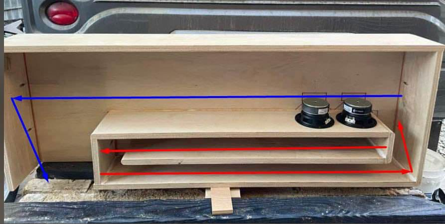

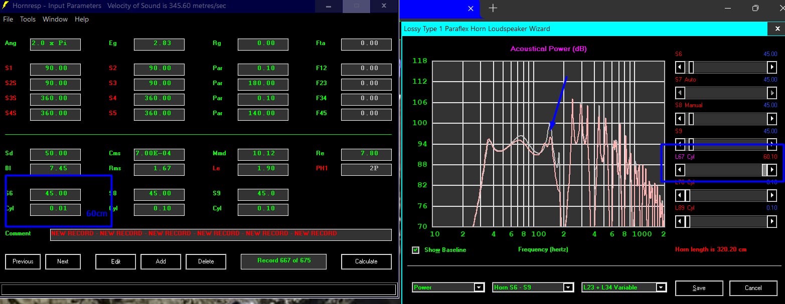

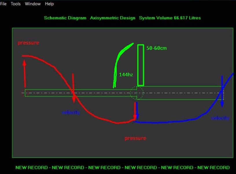

Maybe we should study/investigate this ? A stub at the end of the upstream ‘TL’ that’s as long as it’s second resonace? I dunno if it works as well as the offset driver position at 60 cm that would prevent it from even existing?

This
does not equal this

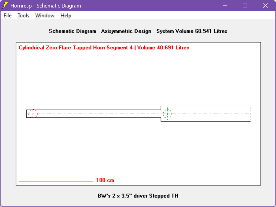

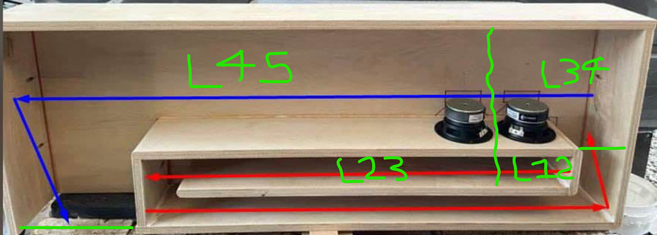

The pic below is a more accurate Stepped TH model of the above pic based on the actual tap points.
i

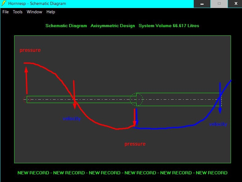

is that creating this? (Green is measured response @ the vent exit)....
the drivers offset is about 5''/12.7cm in the red section and nearly twice that in the blue section (?)
I don’t know what that would do in such a complicated box but that measured resonace with the red arrow on it is the same 1/4wave length as 1/3 of the blue resonator?

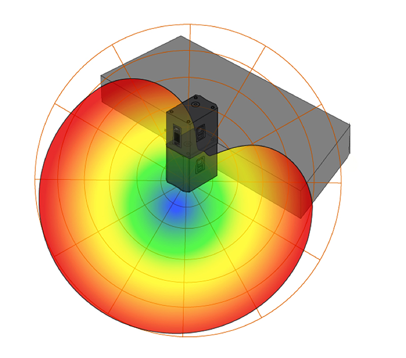

a little illustration for how i set it up.
picture taken from https://fohonline.com/articles/tech-feature/cardioid-directional-subwoofer-arrays-part-1/

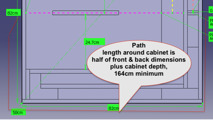

The time of flight distance is from the center of the mouth, around the cabinet side, to the center of the rear of the cabinet, a minimum of 164mm, ~4.7ms.
In addition, there is a diagonal distance to add in.
