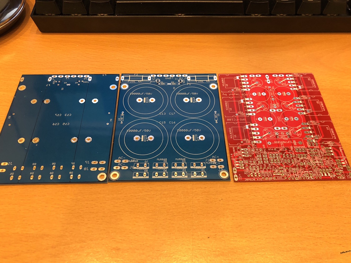

Here are the boards, front end PS and amp, very compact and easy to mount on heat sink in vertical position due to detached backend PS pcb. Component values are printed on board for easy stuffing. References match spice schematics which is always referenced in the thread. Front end PS is lt3062 based, with adjustable voltage.

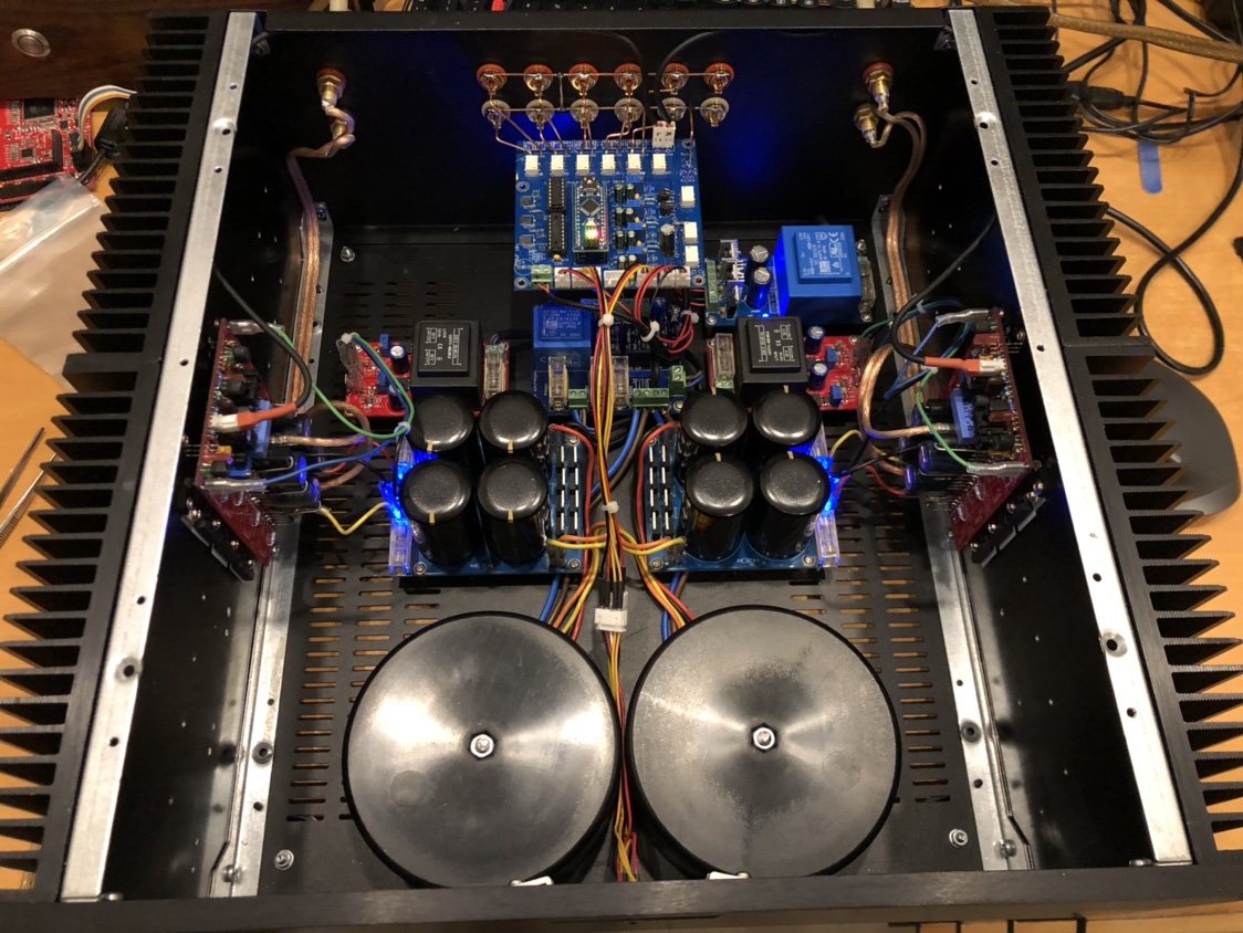

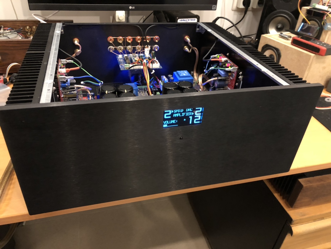

Excellent build zdrawcke!RMI-FC100 + LDR Pre, fully remote operated. Ultimate integrated AMP🙂View attachment 739570View attachment 739571View attachment 739572

Working on it🙂
zdr, are you running the amp at 38v rails or did you hike it up to 55 - 58v rails. The triple outputs will easily handle the dissipation.
Running everything on original specs. Sounds like a dream, cannot imagine it could sound any better than this.

Rails are at 35V here, delivered by back end psu. Front end psu is running at 39V.

Speakers are Zaph ZD5 and Hatt MkII. As far as the room is concerned, we are soon moving into new house🙂
Sound is out of this world. This is probably the last amp I will ever need.

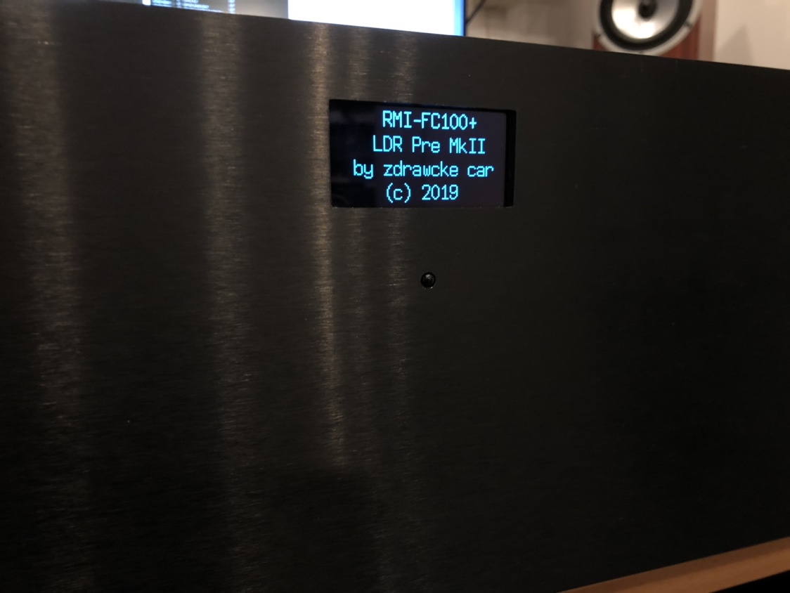

For those who are wondering what is the preamp and display all about in this build, look here:
Arduino based LDR volume and source selection controller

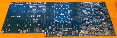

I am preparing to build this amp from boards a friend sent to me. I just want to be sure that I have the correct files. I am attaching them here. I someone would please confirm them I would greatly appreciate it. I have already built and tested the shunt boards.
Thanks, Terry
