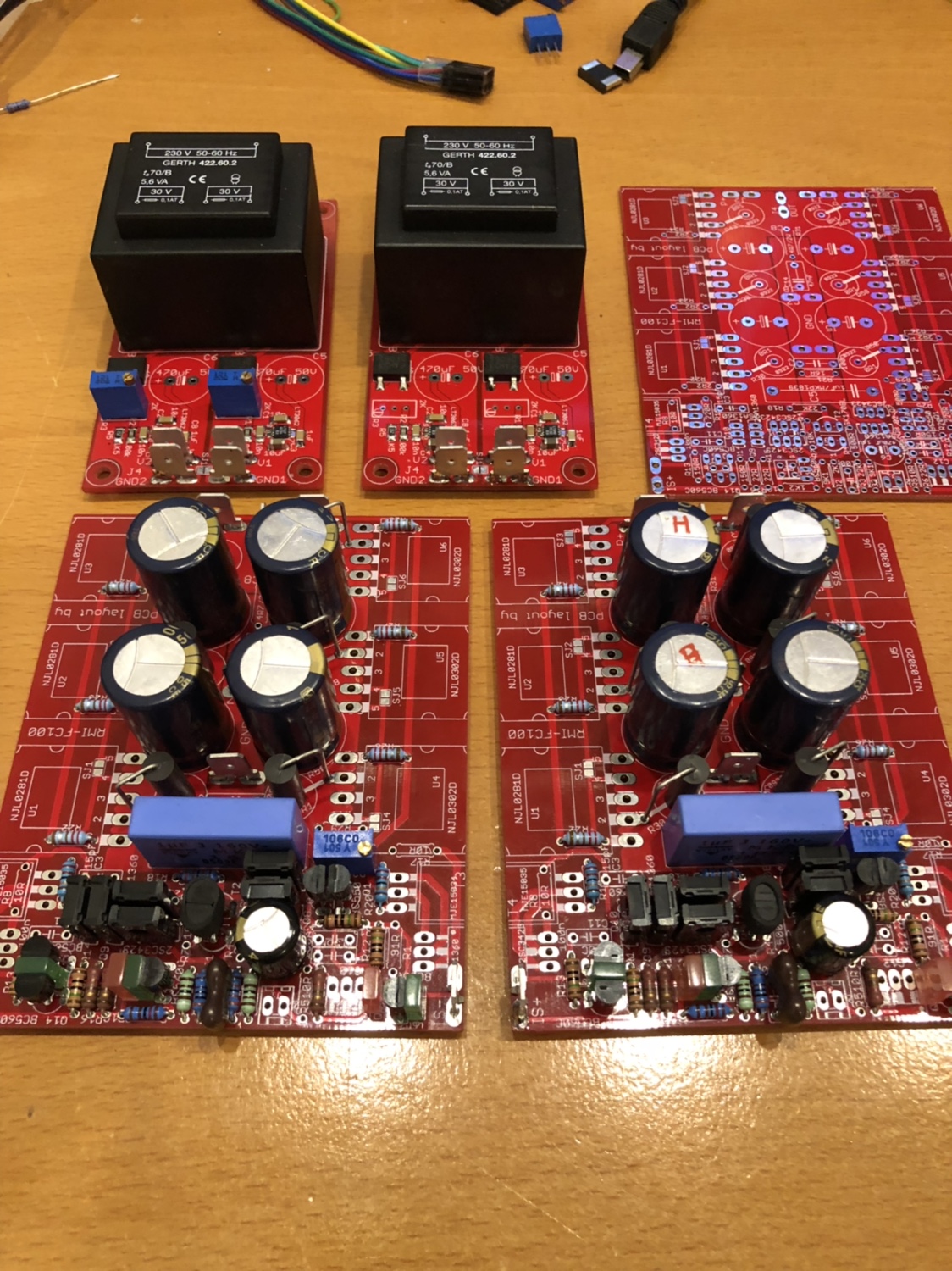

I'm back to good ol' transistor matching frenzy. I found a stash of NJL0302/0281 pairs with quite some mismatch in Hfe. NPNs are in the range of 80-90, PNPs are between 110-130. I thought DMM method is throwing me off, so I built the rig for measuring with LM317 current source into collector with Ice=100mA and Vce 19V, but got the similar result as with DMM on few tested NPNs. Is my stash useless?
Progress so far.

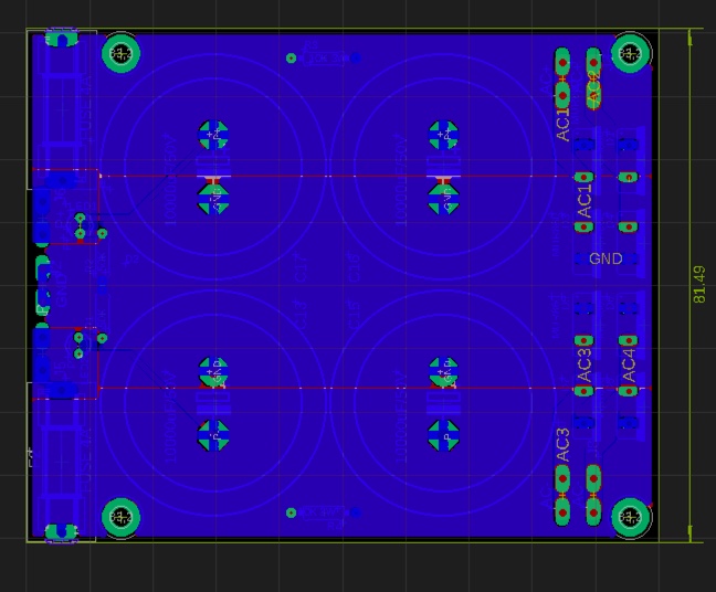

I do not know the KEMET capacitors (I myself am using NICHICON on this position), but KEMET capacitors have a good reputation!
Keep in mind though: the capacitors you are looking for are part of the FC-100 backend PSU. Any "good" brand (Nichicon, Panasonic, Vishay, Epcos, …) will do the job.
I wish you good luck with your FC-100 - Rudi

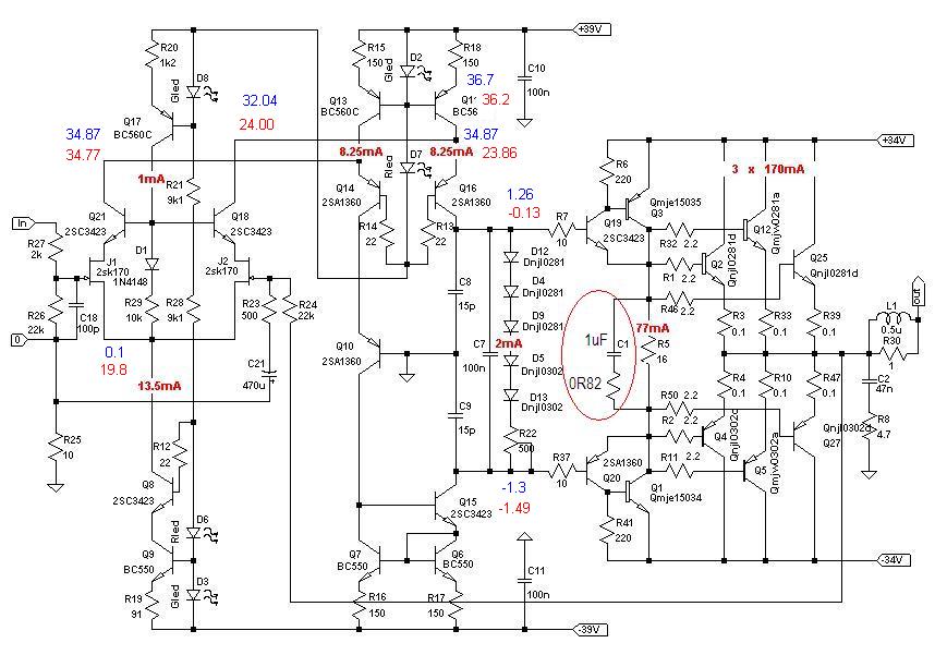

If you can find the "plate resistors", they are non-inductive. They also make non-inductive wire wound resistors. These are always prefered over the standard wire wound types. Something like the TE Connectivity SQMW series parts. They are radial resistors, so there is very little exposed metal lead. I forget if they fit this PCB or not, but I always try to use these types. The plate resistors are available on Ebay last time I looked. One of the very few times I will recommend shopping on Eeekbay.
The normal inductive resistors can make some designs oscillate, but even if those don't, the non-inductive type will buy you some extra phase margin. That's always good.

Actually, even though the title says "wirewound", they are actually metal strip up to 5W - see the data sheet.
LVR05 LVR-5 5 0.005 to 0.3 1, 3, 5, 10 Metal strip
I have these already in the drawer, that is why I ask.

Margins were given sufficient derating to not oscillate , with " caveman" resistors. I would guess with non inductive types , miller caps could be reduced , unity gain could be pushed higher. But , specs are already superior
to overpriced Pass / Curl B$. get as "Anal" as you want.
PS - we even oriented ( the one layer inductor to be opposed to the nearby traces) and suggested 2 layer cancelling OP inductors , so ... "junkbox" components will still make for a superior amp.
