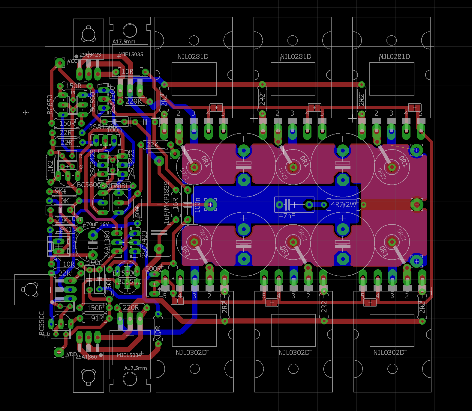

I had a problems with mk ii ver of this amp as well, there were serious oscillations in the circuit, however i used toshiba op devices and bf862 jfets. I was able to solve the problems only by changing 150R to 33R and installing a 15pF compensation caps on drivers.
Mihai, is there a rule of choosing those resistor optimal values for drivers bias current?
Good Question. And also interesting for those of use who want to use (modern)available parts. The original 2sk170l is indeed nice but difficult to source.
I think compensation caps should be enough if you have similar problem. No need to change bias resistors. Btw, I have used diy pcbs (laser printer method) with very compact layout, perhaps this contributed to stability of this amp and lower output capacitance of op devices which shifted phase margin
Thx! I will try your suggestions.
...so according to the mkII schematic it musst be R6/R41. Should be equivalent to R6/R41 in this FC 100 version. By Compensation Cap you mean a Cap in Parallel to R6 respectively R41. Or from driver base to ground as a local low pass filter to catch high freq transients? (Does my thought make even sense)
Thx, I'm new to advanced debuging. Just for my understanding is this a miller compensation ?
I am revisiting my beloved FC100 - I want to replace by home made single sided PCBs with something better. For that purpose I created a compact layout, without big output caps and fuses which will sit on separate board. I would appreciate some feedback. Were there any changes in the schematics during the years?
