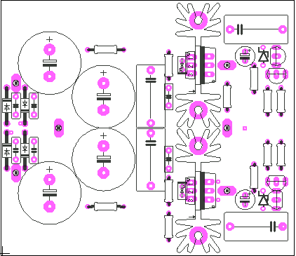

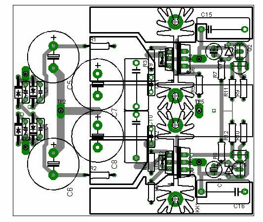

The labelling would be much more readable if you dropped the circuit pattern and left just the vias. Also, there was a tweak for C1 with the addition of a series resistor.
m2003br said:Hope this may help:

Sorry if this was already discussed somewhere on this thread, but I noticed in your parts layout for the PSU, you didn't picture the required jumpers between the banded ends of D1 and D3, or across the pads next to the base and emitter of Q7. Anyone taking the care to build this should recognize this, but I just thought I've give a heads up.
Also, the labels for Q4 and Q5 could be clarified. I can't even see Q4 in there, and Q5 is unclear which transistor is intended.
Also, I got to wondering if you have any suggestion for mounting the PS board, since there are no mounting holes. At first I thought you mounted it via the vias under the heat sinks, since all those heat sink vias need to be connected to ground/each other. But then I understand the three ground busses are connected together via the heat sinks pins soldered to those vias.
Hi Pooge,
You're wright, the PSU PCB need two jumpers in the positions you already mentioned.
At the moment when this PCB was constructed and tested I was unsure about mounting position, hence no holes.
Thanks,
Mihai
