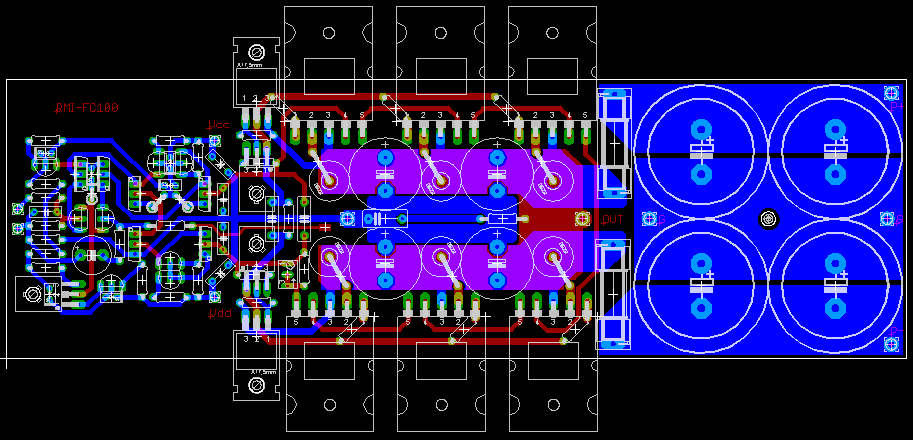

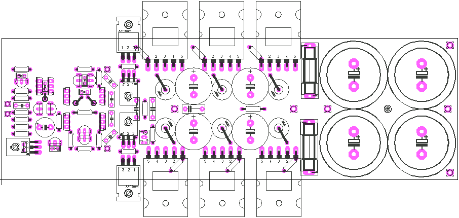

Sheldon said:Mihai,
I may have missed it, but is there an image of the main board with the parts labeled that I have missed? No problem, if not, as the schematic and pictures here should do.
thanks,
Sheldon
Hi Seldon,
Sorry for no PCB component label layer ... it is so difficult to do that in EAGLE.
This is all I can do for you:
Sheldon said:
I will probably use one front end supply for each stereo pair of power amps. But I'd like to use the two extra for other projects. Any limitations on reducing the input voltage and reference zener for other applications?
It is possible to use other output voltages by putting other zener values 😉 but don't forget that this is a shunt PSU. You have to modify CCS current in order to keep at least 10-15mA through PSU output transistors (MJL15034/35).
Happy Holidays,
Mihai

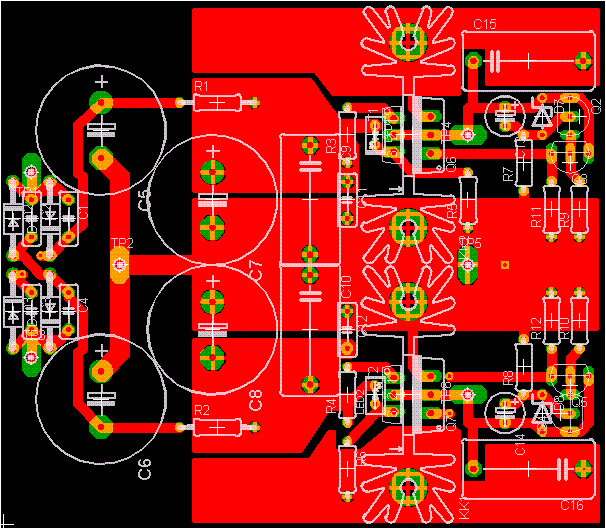

roender said:
Hi Seldon,
Could you drop the red. blue, purple and black colors, and just leave the green vias? That's a LOT of printer ink, and not really helpful to visualize parts layout.
What is the maximum voltage drop the PSU regulator can do, so we can know the voltage range for acceptable transformers. Also, what is the minimum and maximum difference acceptable between the PS voltage delivered to the input stage and that to the output stage?
It is better now?
