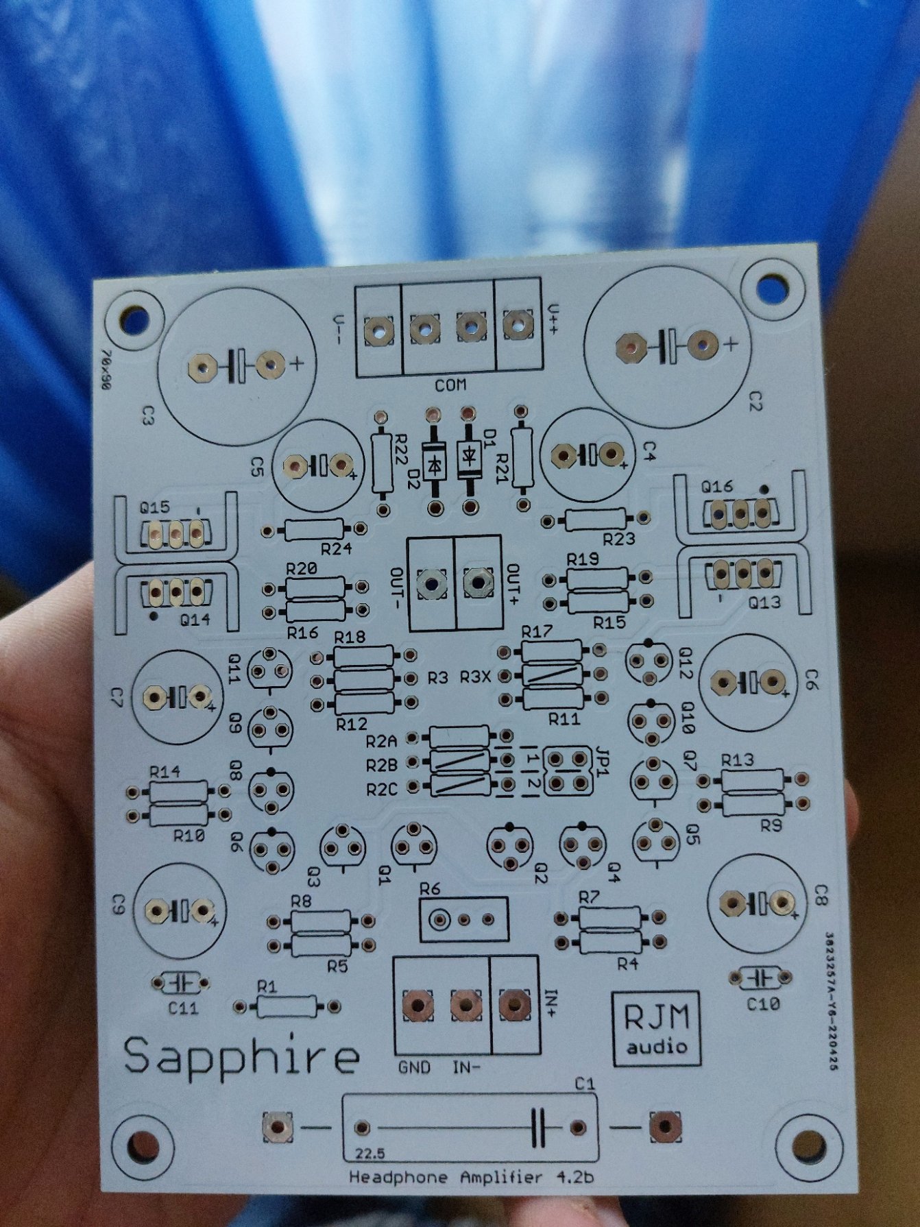

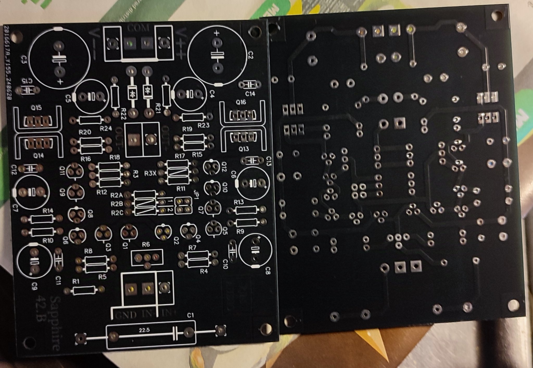

I'm waiting for a pair of PCB's for this(42.b version).

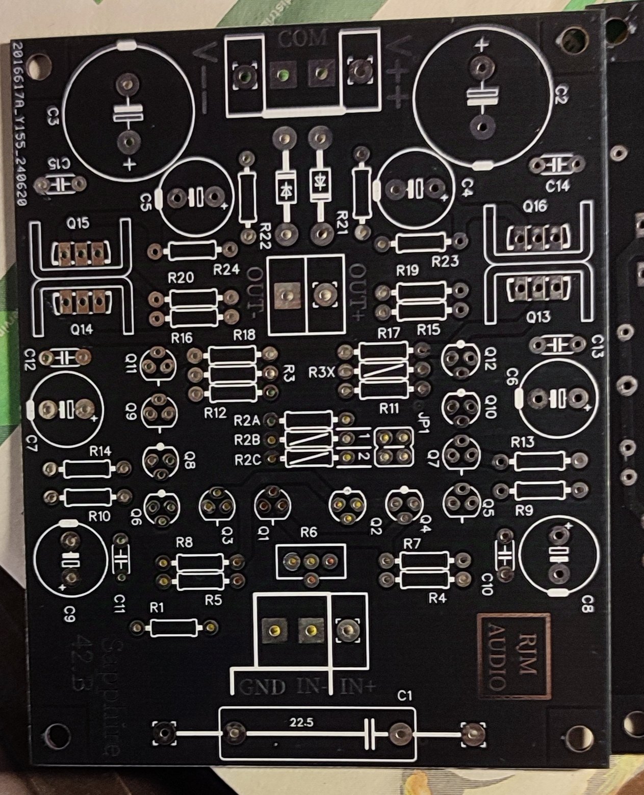

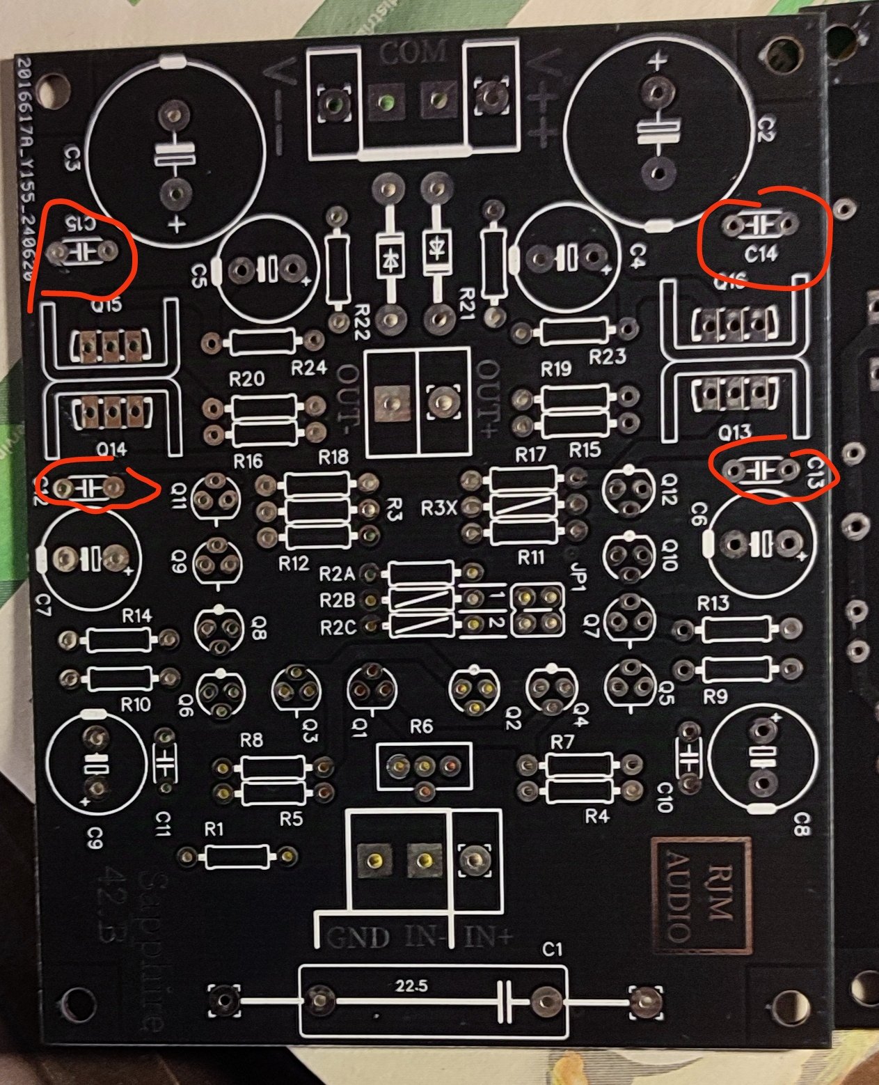

Hmm, the BOM has capacitors up to C10&C11. The boards have C12-C15?
All those(C12-C15) looks to be 100nF footprints like C10&C11.
Is there any reason to stick with X7R rated caps, or would it not be better to put C0G/NP0's there? And the 100nf, would say 220nF C0G/NP0 do(I have all the above, 100nF X7R, 100nF C0G/NP0 and 220nF C0G/NP0)?
Edit: I've got 100nF/50V PPS as well should those be an even better choice.
