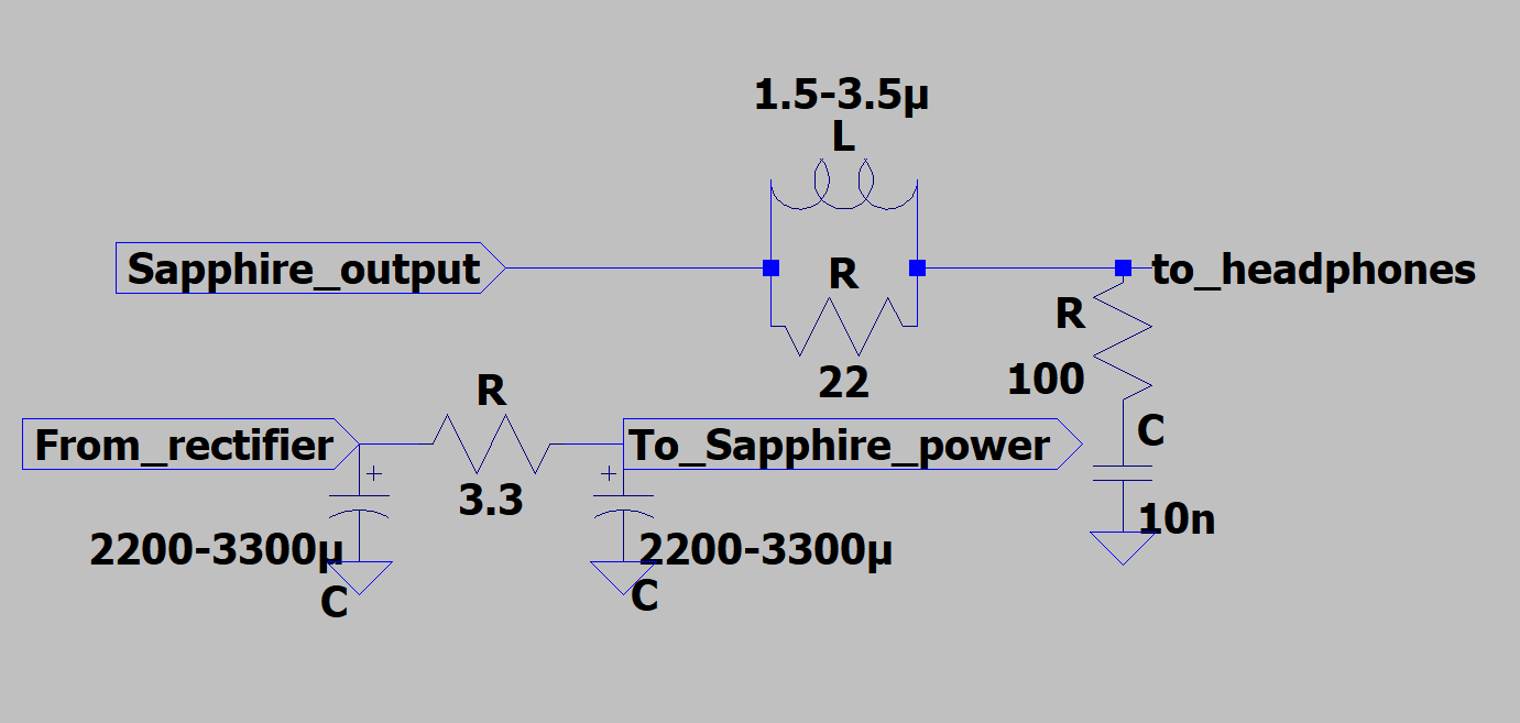

It wont get any better as the sapphire is not for IEMS. It took me a while to remove the hum from the sensitive 32 ohm headphones but on my Leá IEM the hum is there. To reduce it you will need to use CRC filter infront of the sapphire, shielded cables, zobel on the rca to ground and a simple output filter.

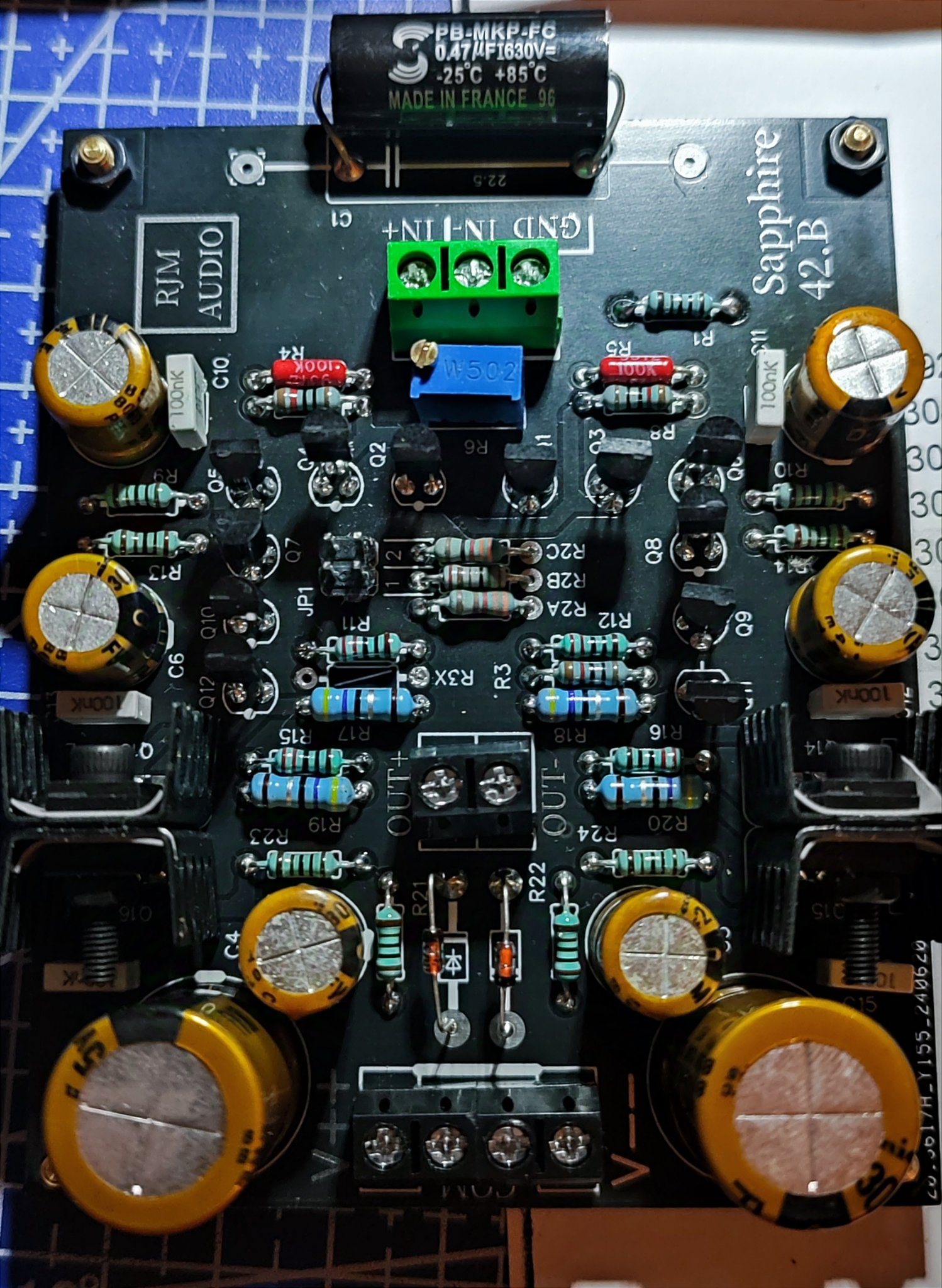

I've fed the Hfe of the BC327 & BC337 into a spreadsheet. I'll make it sort the 400(total) transistors by Hfe and see if I can't get closer matches between NPN - PNP within as small a percentage as possible. I think that will be better than having perfect matches within NPN and PNP, but not between them. We'll see how it turns out.
Got the Hfe gap between NPN and PNP smaller, while still keeping the match within each, NPN and PNP, at 1%.

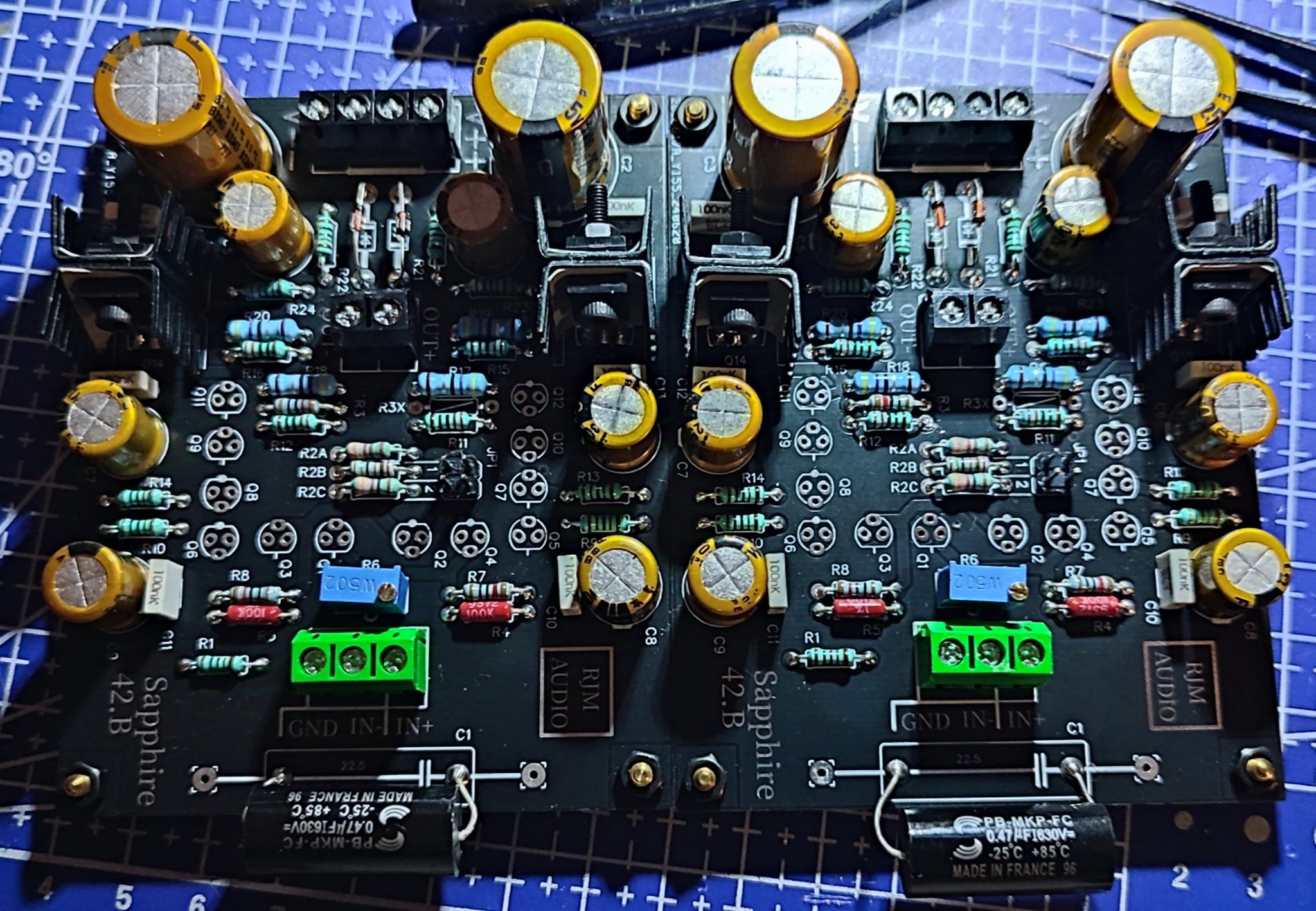

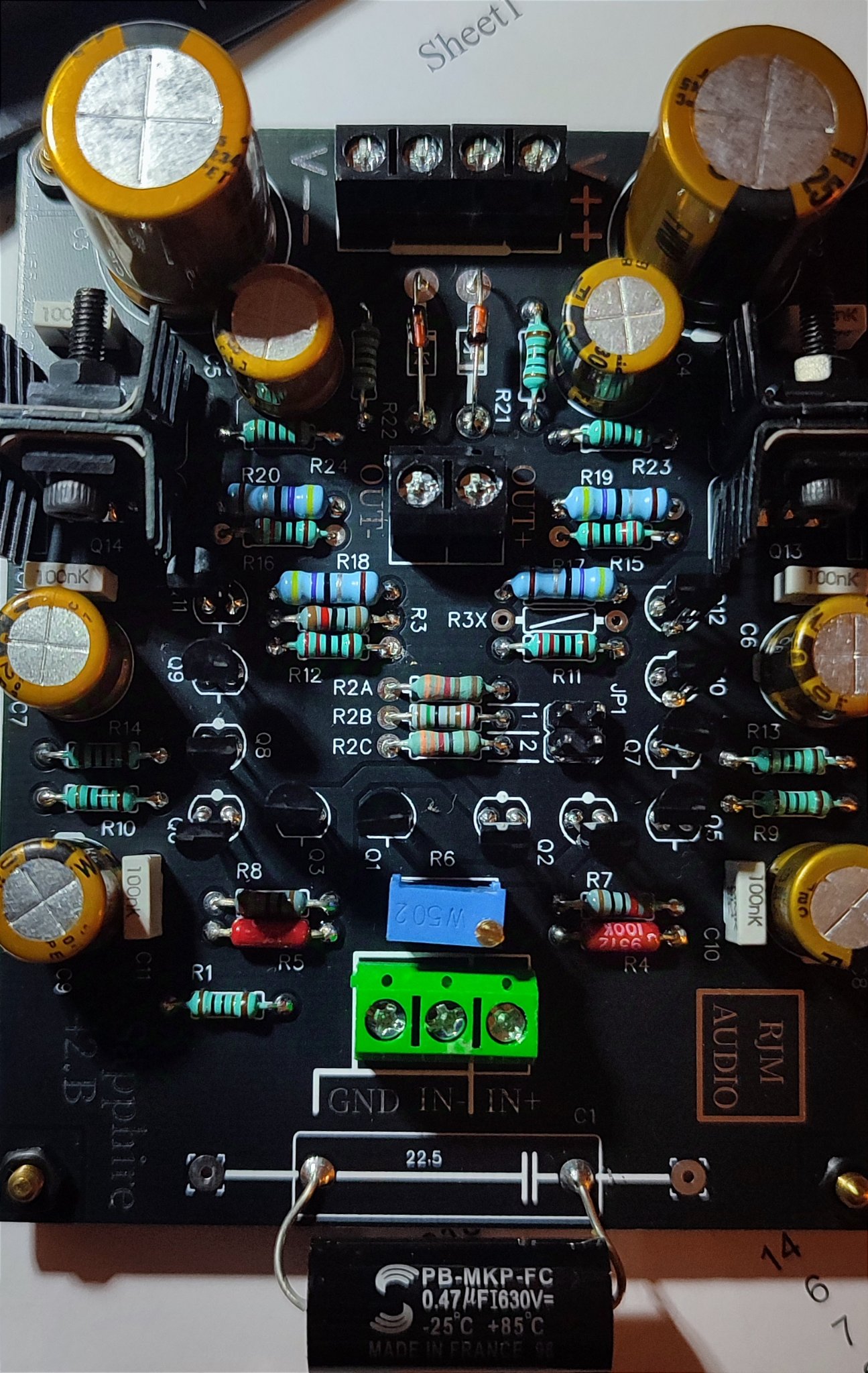

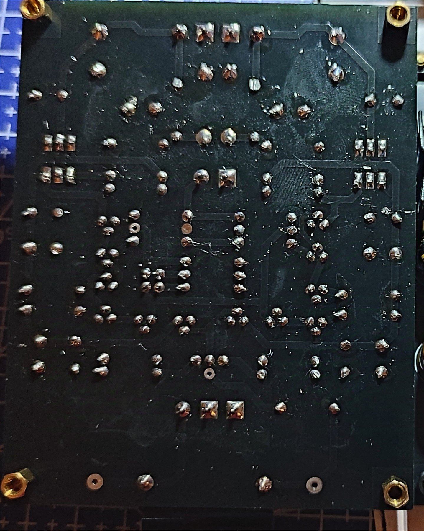

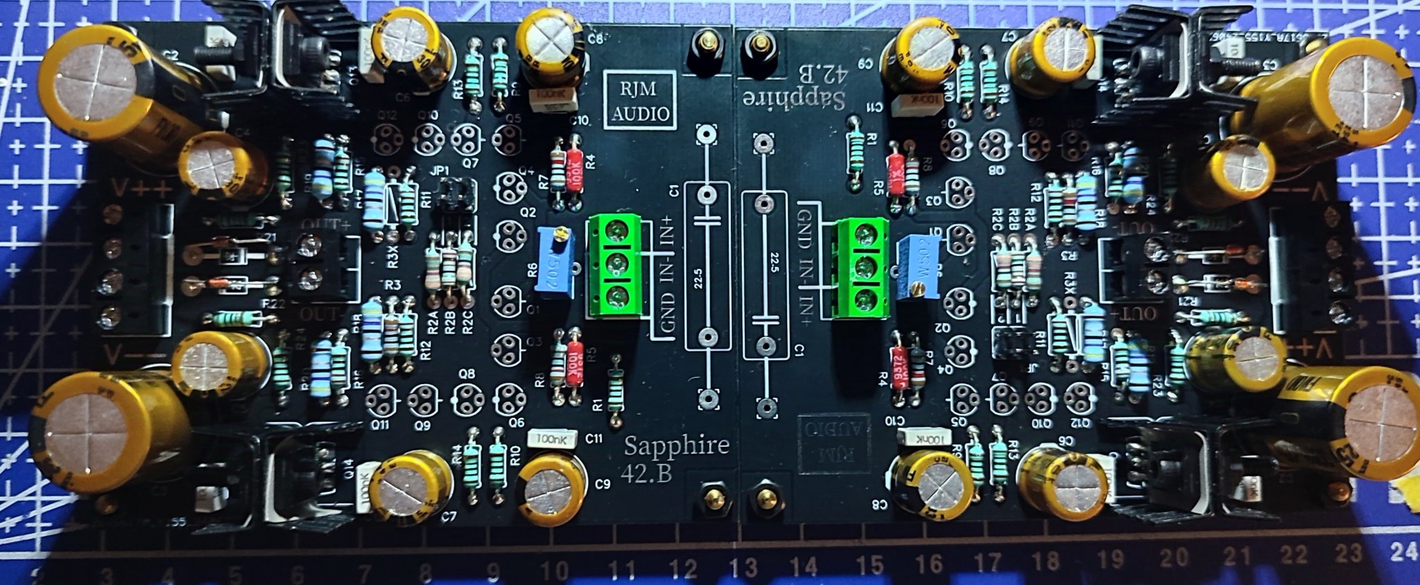

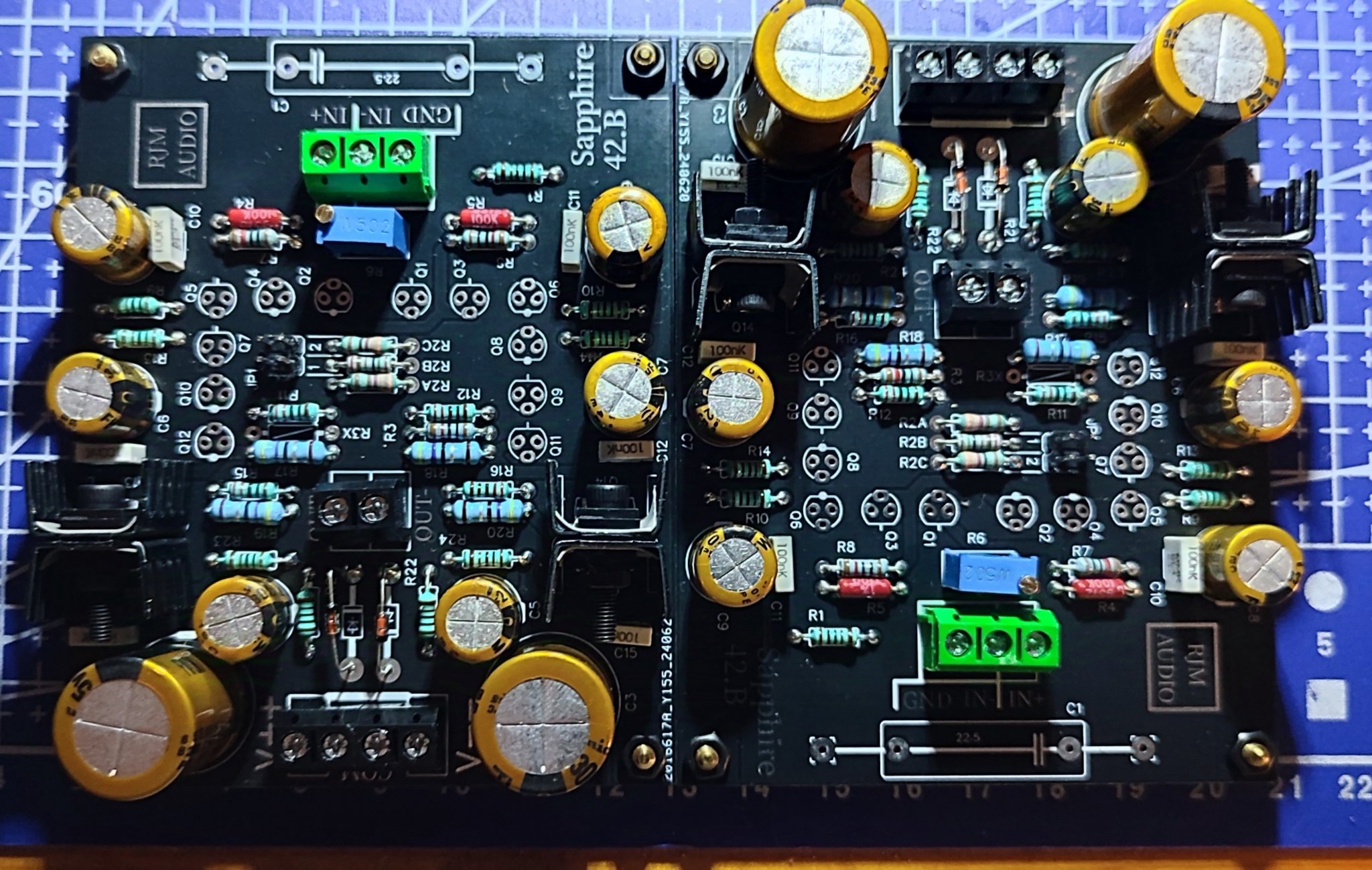

Need to clean the lens, but here are some pics of the finished boards. All that's left to do is clean the boards with IPA, put them in an enclosure and wire everything up 🙂

For the rectification part of the supply voltage, put two capacitors and a resistance, CRC... or more. 😉

Are you referring to this?For the rectification part of the supply voltage, put two capacitors and a resistance, CRC... or more. 😉
Yes.
Sapphire is a bit sensitive to external factors and what else is found on the 230VAC network.

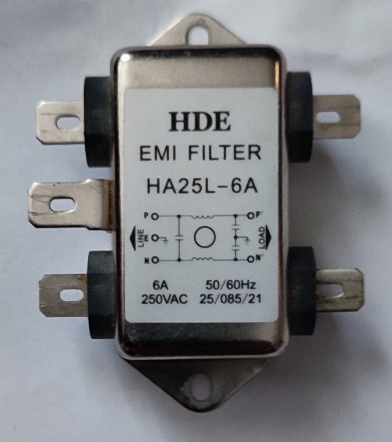

That EMI filter wont do much as its way over rated in current. With EMI filters you wanna dial in the correct amperage for proper filtering. Even with my de-noiser psu which have around 100dB of 50Hz reduction i couldn't eliminate the psu hum no matter how hard i tried.I've got this filter I figured I'd use before the transformers. I suppose it won't hurt at least 😅
Mind you i use an unshielded plastic case with a CAT5E as umbilical power cable running across the pcs power plugs combining both digital and analog psu.

Ok, I'll use the filter you posted above, just to be on the safe side.That EMI filter wont do much as its way over rated in current. With EMI filters you wanna dial in the correct amperage for proper filtering. Even with my de-noiser psu which have around 100dB of 50Hz reduction i couldn't eliminate the psu hum no matter how hard i tried.

My build will be in a metal enclosure with the transformers in the same enclosure.

I've populated all parts on the boards 🙂
Left to do is clean the boards and put them in an enclosure and hook it all up.
I haven't decided on which enclosure to put them in, I'm going with two transformers each being 12-0-12vac 1500mA. So dual mono all the way (except for the volume control, stepped ladder attentuator, that is).
