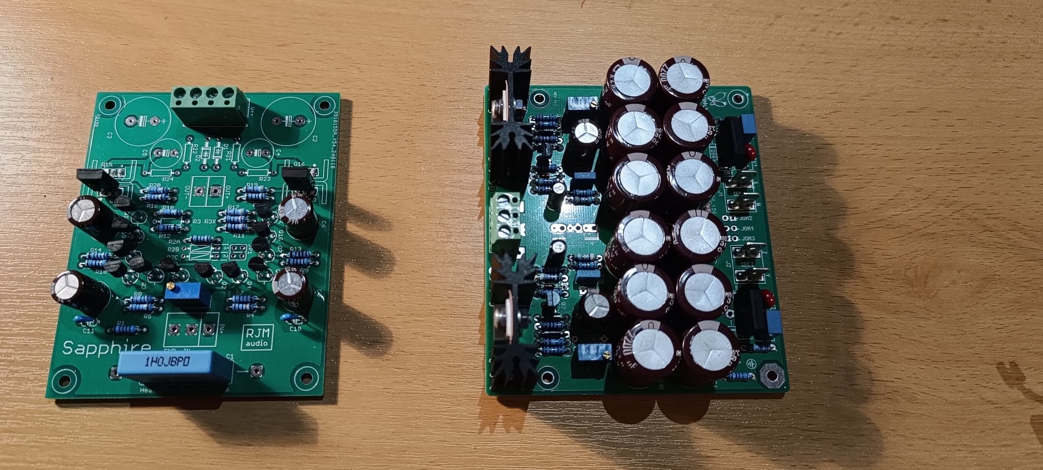

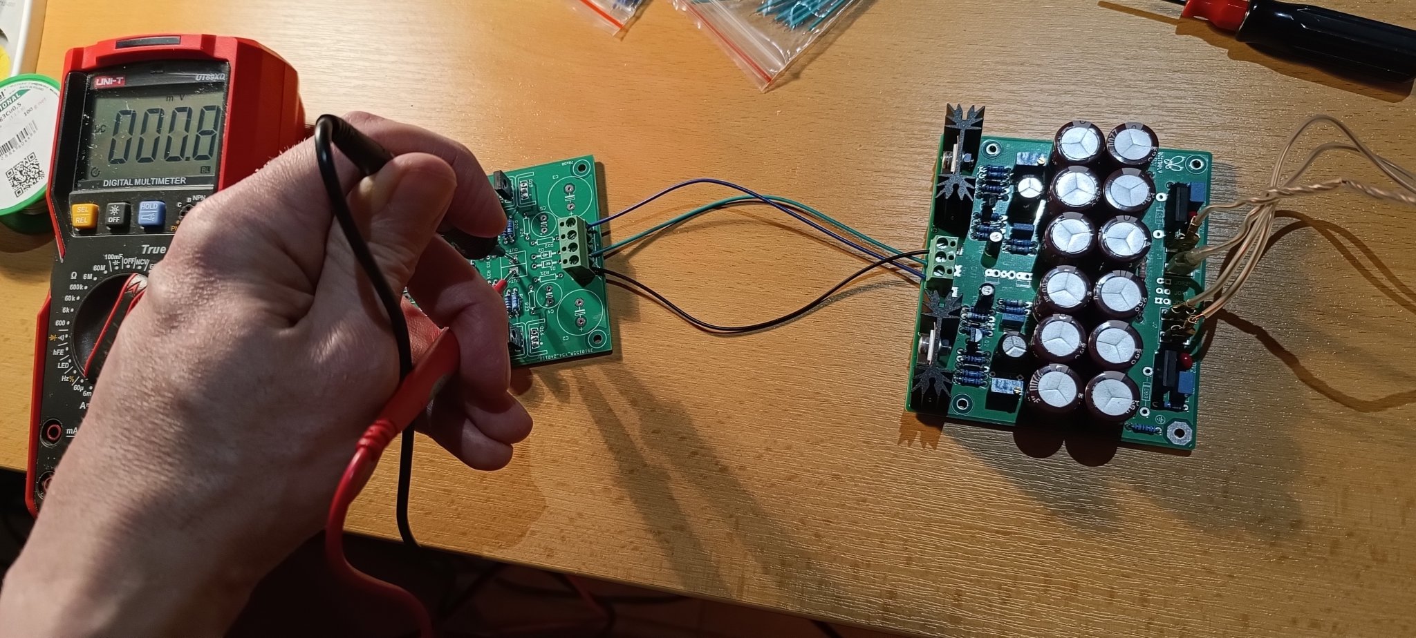

This was one hell of a ride. I started to have random noise and both boards slowly get silent then return to normal. Did everything, replaced the regulator, problem went away then came back, rebuilt the board completely and the same thing. At the end it was my old transformer randomly dropping voltage or cutting out. Both board draws 51ma on + and - rails which seems a bit low to me but it works fine. Gonna see if i can get away with a 10W trafo for both boards.

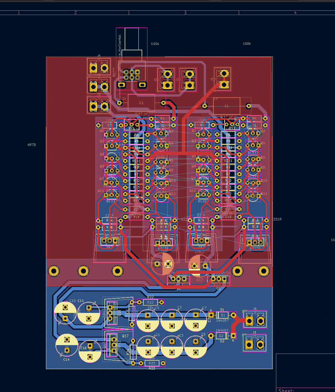

Hi, So i thought of designing a pcb with (ngl many downgrades over the original design) to suit my particular case and availability of parts ), My pcb design skills are still pretty fresh. Though i would like to know what do you all think (i did take some even to me pretty risky shortcuts, do tell me if they are a total no go)
Kind Regards.
Thought i would do a redesign for myself (IMO its an improvement, but not sure if i am missing something). Instead of a old power supply. i swapped it with a capacitance multiplier and a lm7xxx power supply.
Regards

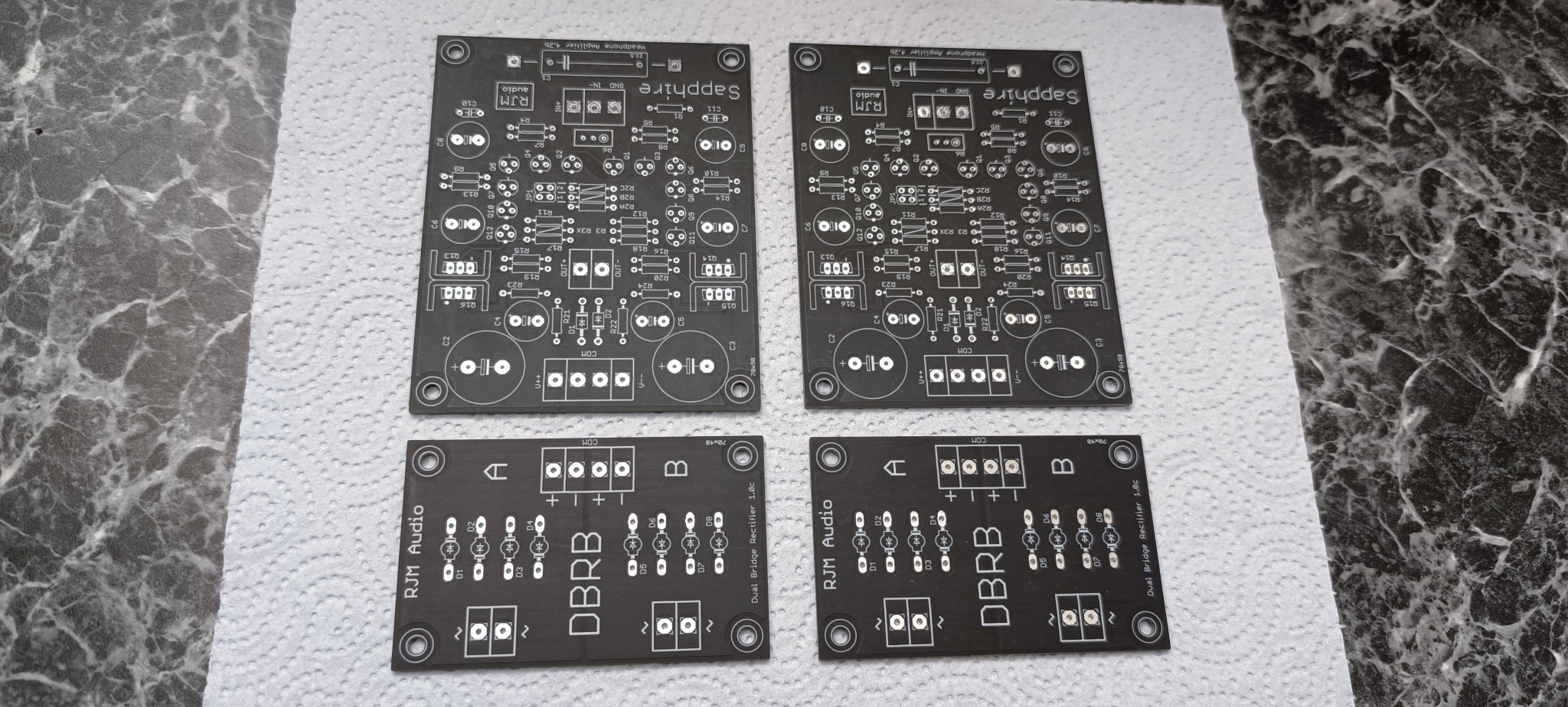

Hello Richard,
The board is already at home. I'm surprised how fast it came, ...from Japan to Slovakia 12 days.
The boards are very high quality, matte black. I'm curious what the sound is like, hopefully sapphire will be ready by summer. If I like the sound I will build a preamp from sapphire, of course on the original boards and I will support Richard again!

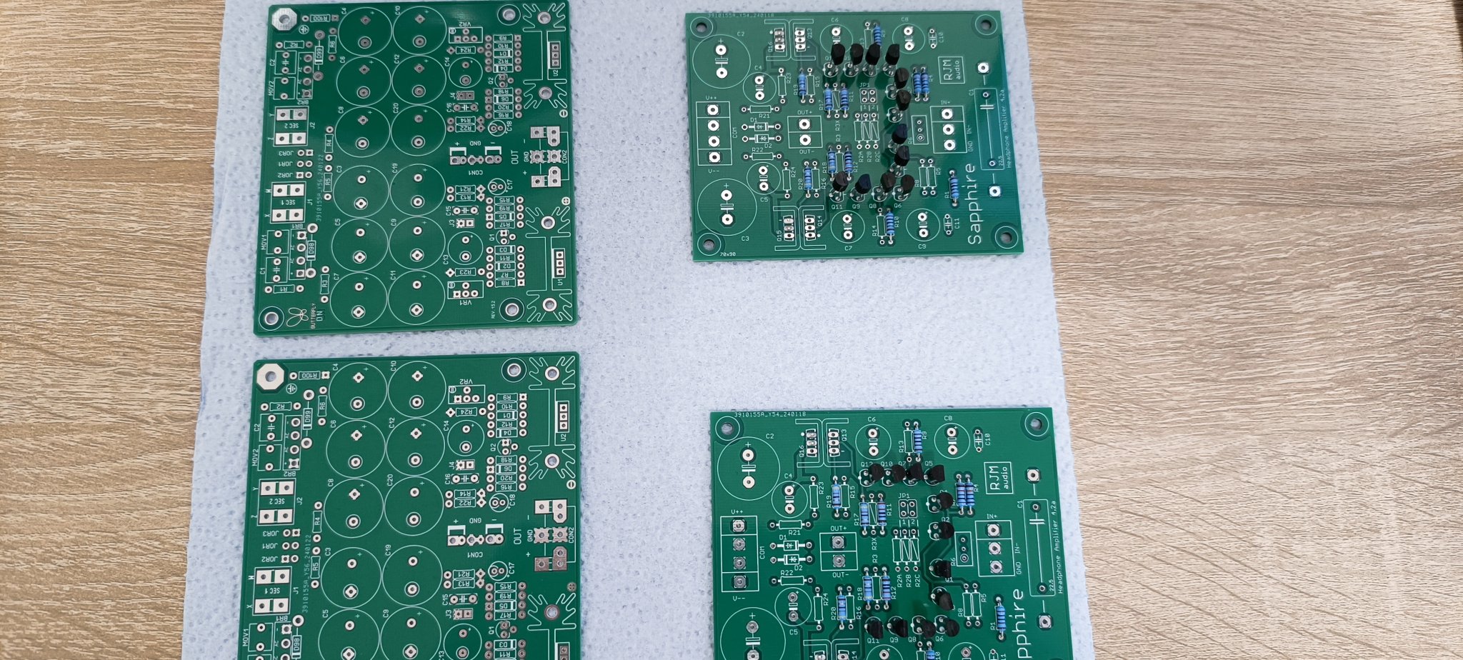

Today the Sapphire in line stage configuration finally finished, ready to be built into the box. I set the supply voltage to 13V and set the DC offset close to 0 mv. I'm just curious about the sound, ...but I'm sure it will sound better than a preamp with modern integrated circuits (opa1611, ...)

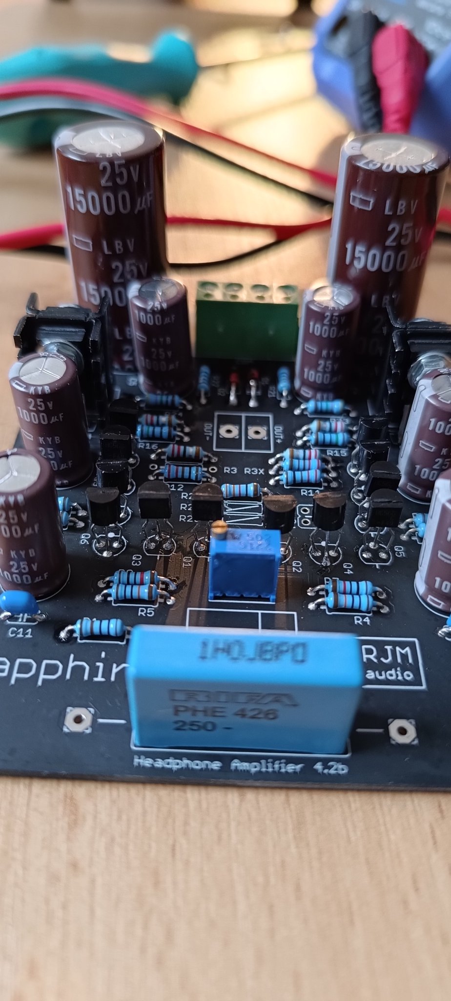

I'm about to send off a parts order but I have a query and was hoping someone might be able to advise. My headphones are 25ohms & 103dB/mW so I'm opting for the high power build. The Power Option tab in the 42b5 BOM highlights those components that differ to the Standard build in blue, however for the heatsinks the same part is specified.
Is that correct?
