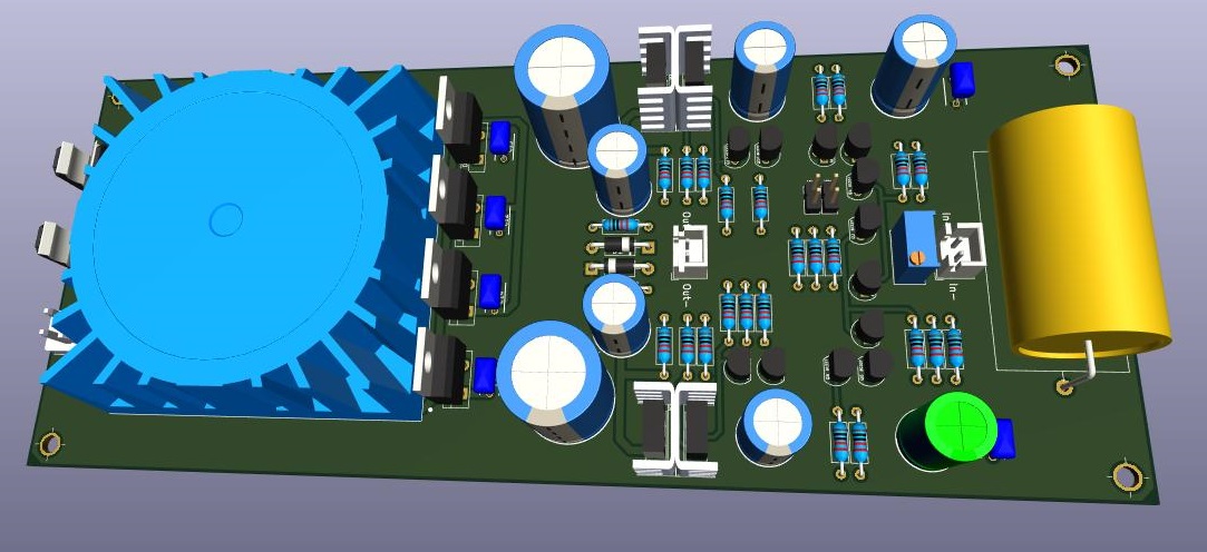

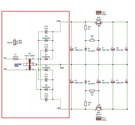

Hello friends
I'm thinking of making my own boards with power included
I don't know much about electronics and I would need you to help me give your opinion
I upload an image of the schematic and one in 3d of how the board would look
I'm sure there's something wrong and can you help me?
Thank you very much for your attention and patience

@Mandragora By all means. I was working with the free version of EagleCAD that placed limits on the board area. That's the main reason my boards are 8x10 cm. If you've settled on your power supply design and want to do an all-in-one, why not? Keeps things neat and convenient.
For the record, from my point of view, there are good reasons why I wouldn't - even if EagleCAD allowed it.
Mostly, it's the loss of flexibility re. the type of transformer, the diode package, and the placement of the power supply relative to the Sapphire circuit. Everyone has different ideas for what's best, different case geometries, etc, and I need to provide as general a solution as possible. In particular, specifying an exact transformer package when physically speaking there is no need to do so is an nonstarter.
note: I would add another two mounting holes, centered on the long edges of the board, for a total of six. The boards may sag or flex otherwise.

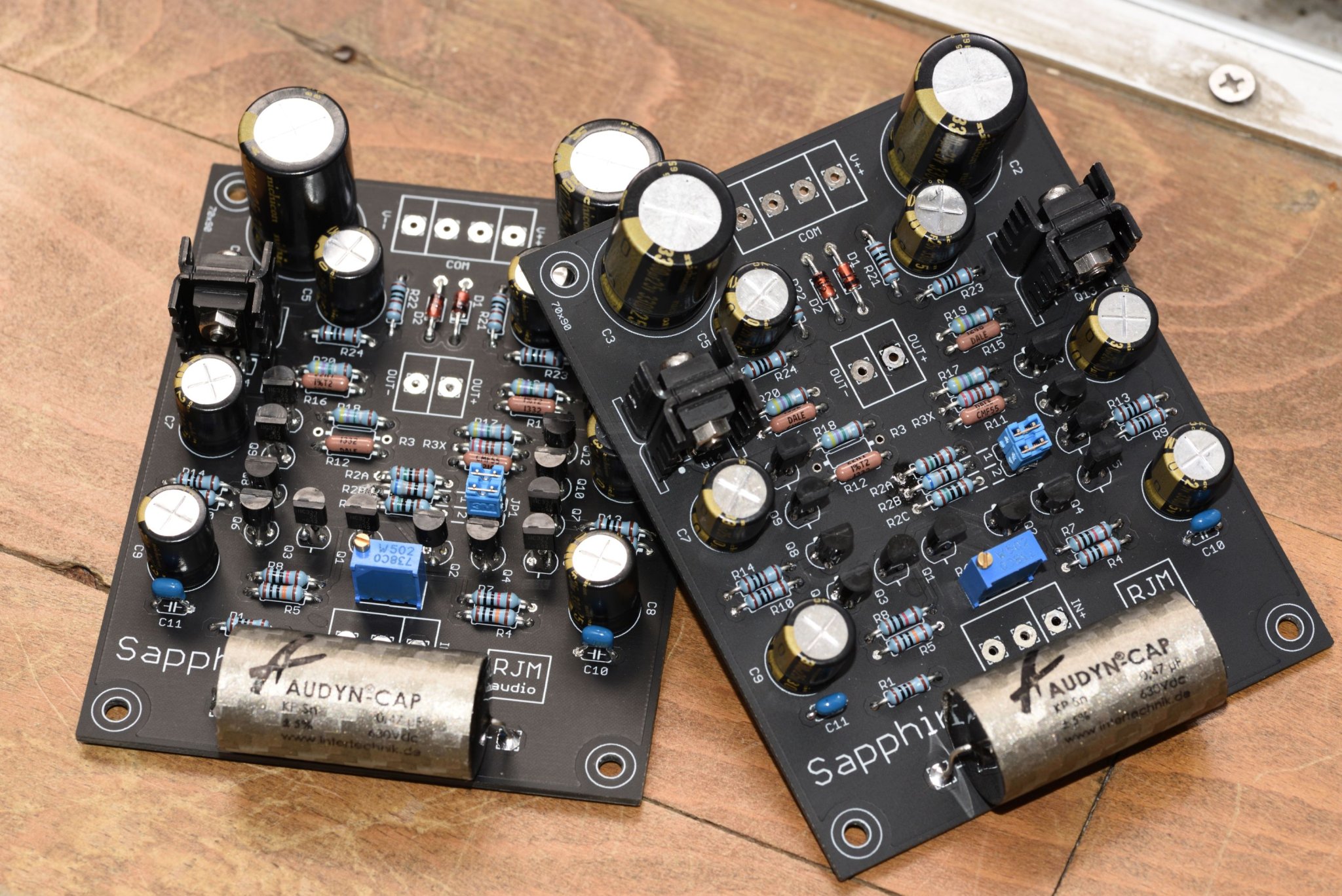

Put one board together and don't know how hot should the heatsinks be. I can hold my finger to it for 5-7 seconds before i need to release. The dc offset is 4.7mV. Positive rail 11.47V, negative rail 11.57V. The positive regulator is a bit warmer than the negative.

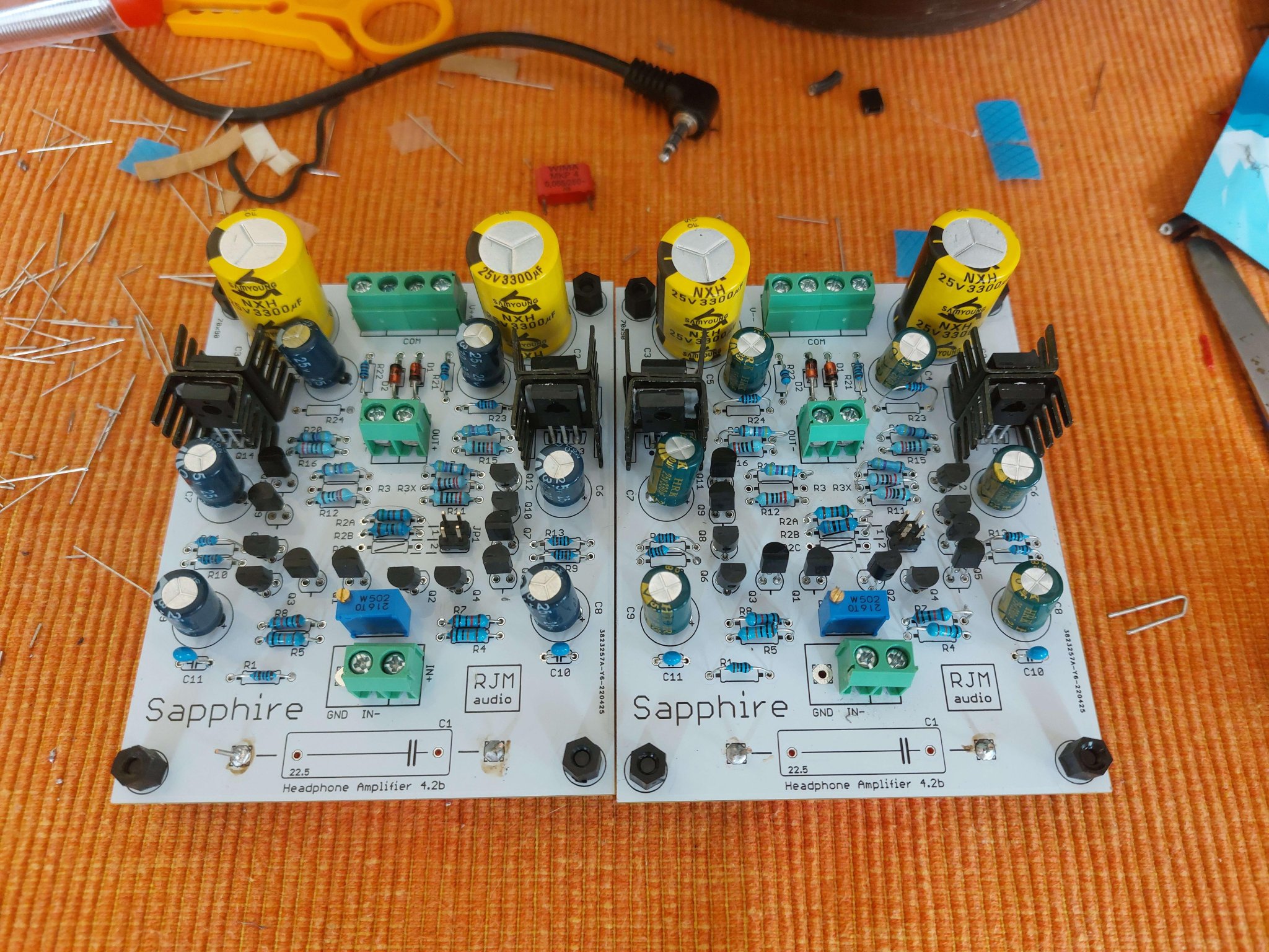

Both boards working fine. Now all left is to make case and connect everything together. The right board had a bit of buzzing and hum but i think that was my error in the test wiring.
@kazuviking
Perhaps it's the test wiring, but it wouldn't surprise me to learn that you've got some poor connections somewhere on the boards.
For starters, R24 is missing from the left board...
In general, though, the poor quality of the soldering throughout is evident from the photo.

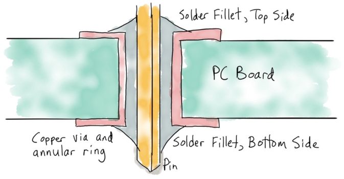

Solder is applied from the bottom side of the board, but the pad should be hot enough that the solder is wicked through the hole to form a little dome of solder on the top side of the board. Look at right pad of R1 of the left board ... that's what they should look like, but almost all of yours look empty - the solder is just covering the hole on the backside, it isn't flowing into the hole because you didn't heat the pad for a few seconds before applying the solder, and/or your soldering iron was simply too weak for the job. Without solder filling the hole, the joint remains mechanically weak and prone to failure.
Staying with R1 on the left board, that resistor is positioned correctly. The body is flat, resting on the top surface of the board. Most of the resistors are "flying" however, the most over-the-top example being R23 on the right board. The resistor should be pulled tight to the board, then held in place by bending out the leads slightly. Once locked in place, solder it and clip the leads. Insert, clamp, solder and clip one resistor at a time until you're comfortable doing several in one batch.

I realized my mistakes after and redid every single joint after my new soldering iron arrived(cheap chinese 80W one, but oh boi it made things way easier than my old lidl one). R24 was not missing i just put it on the underside for some reason. I did not have a resistor leg bender so i had to improvise. I found the source of the buzzing, it was the cheap input capacitor, after swapping it, now its dead silent.
Still don't have any case to put them into, here i go making a tinfoil wrapped cardboard box.
Thanks for the tips. Currently i'm waiting on BD139/40 to arrive so i can replace the 2SD882-P and 2SB772-P.
How cheap? 🙂...it was the cheap input capacitor
Under 1€ from a friend. I bought those "audio" film caps years ago to add extra interference filtering into a handmixer, not where you should use them but film is film capacitor.How cheap?

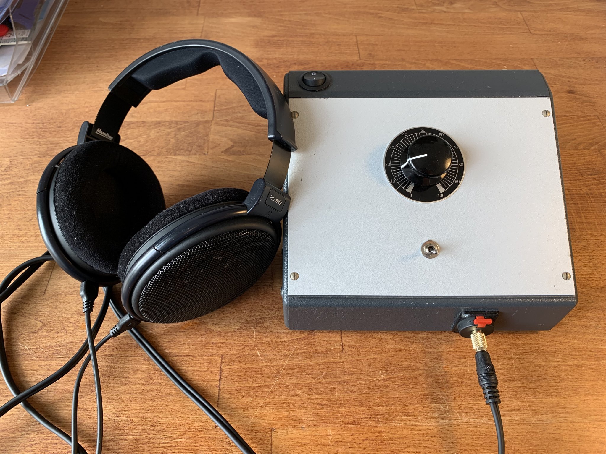

It has been a long road but finally...
Linux Distro (XFCE ubuntu or MX linux) with Pipewire and jamesdsp headphone database for AKG K240 sextett
https://github.com/Audio4Linux/JDSP4Linux
playing through RJM Audio Sapphire Desktop Headphone Amplifier
