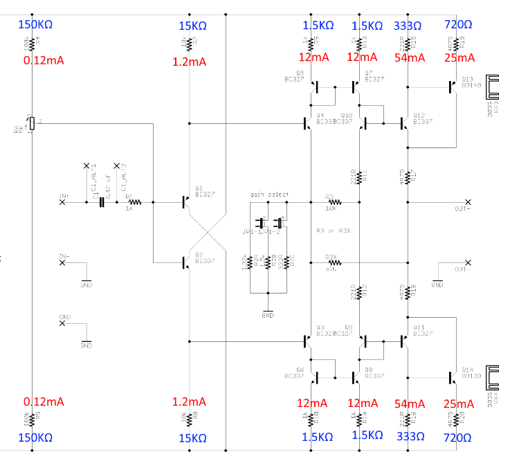

So now it is 820/12.7K. It will go a way lot more loud than I want to hear it, but it has always been like that. Given the change this change has made, I'm temped to try it with about 1.2K/12.7, I'm thinking it would be even finer to finesse the volume. But I am gathering all of my acorns together to build 4.1b because evidently I do not have the best possible adjustability. Some of the stuff I bought to build 4.1b way back, got pirated in other projects, I just have to regather the BOM.

I changed it again, now it is 1.2K/12.7K. It's better, very happy with it in the new phones. Thanks your your advice.

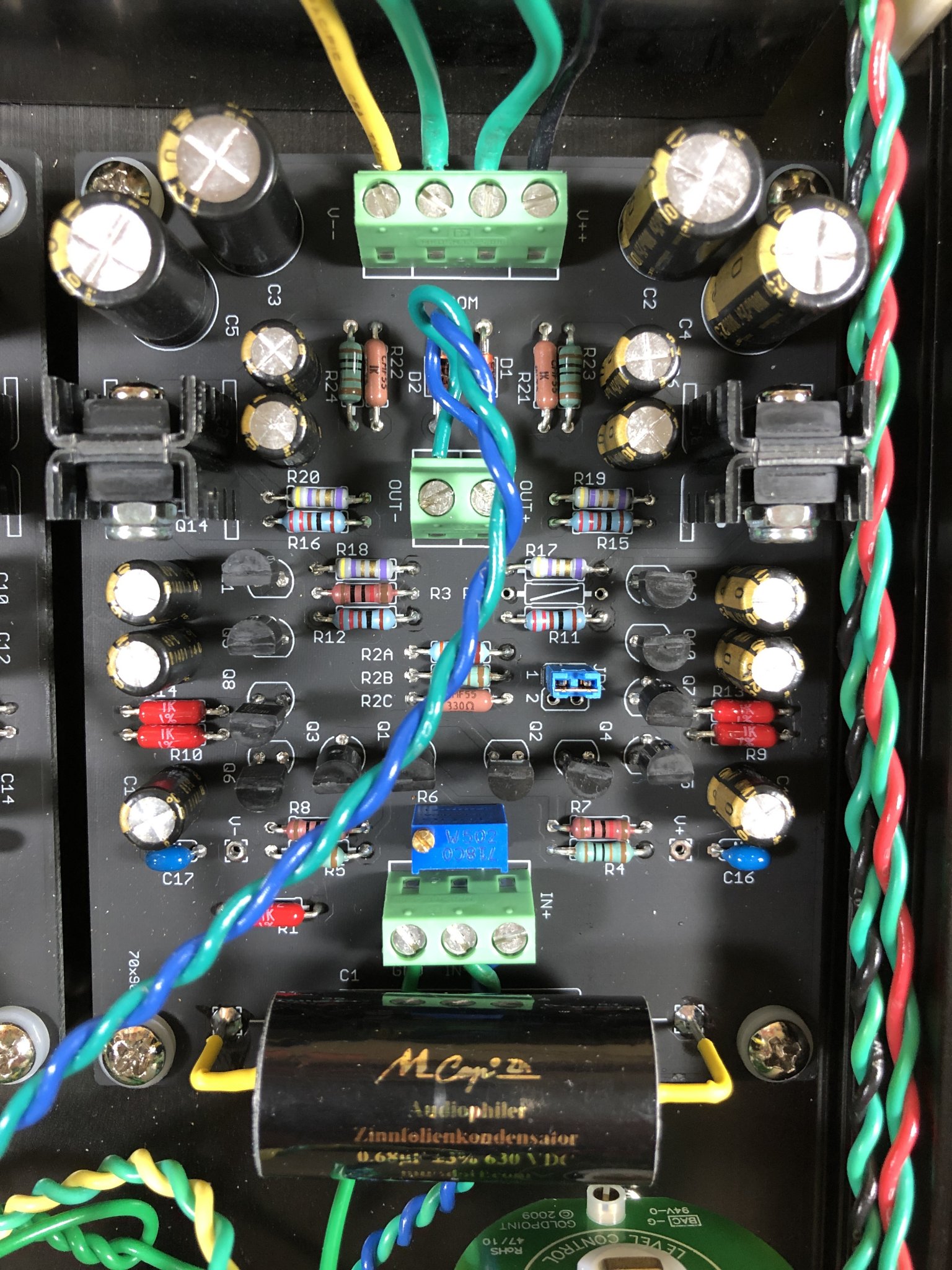

My 4.1b boards have been running for more than three weeks now. I used Mundorf MCap ZN for C1 in this build, and I was not too surprised to hear those new caps sound very dark for the first few minutes and then open up. Now I don't think I could tell you if there is any different from the ClarityCaps I've used for years in 4.0.
I built them open according to the BOM.

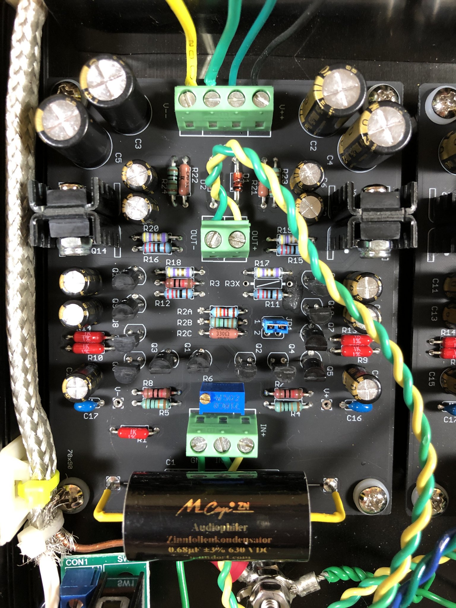

Hey,
I´ve used the search function, but cant find any infos to my issue...
So I build 2 boards of sapphire, one of them works fine, bias after heading up close to zero v.
The second one is a little more trouble:
V-- -13-13,5v
V++ 13-13,5v
V+ 11,29v (measured at c10)
V- 9,21v (measured at c11)
Output bias: around 4v
Regarding to your earlier remarks I matched the zener-diodes (BZX 79-C12 NXP)
After my first measurements I reflowed the solder joints in the power section.
So the mistake appears to be in the power supply section, because the V+/V- are not symmetrical?
Any clue where to search? I´m going to investigate further tomorrow...
Any hints or tips are welcome 🙂

since I cant edit my posts, mistakes found:
1) was a wrong r6 (some wrong value found its way into the 5k bag)
--> Probably my own fault
2) after checking all resistors code, transistor legs etc. I found one of the capacitors to be soldered in wrong polarity
--> definitely my own fault
Now back to putting this into an enclosure and I will be back once everything is done! 🙂)
