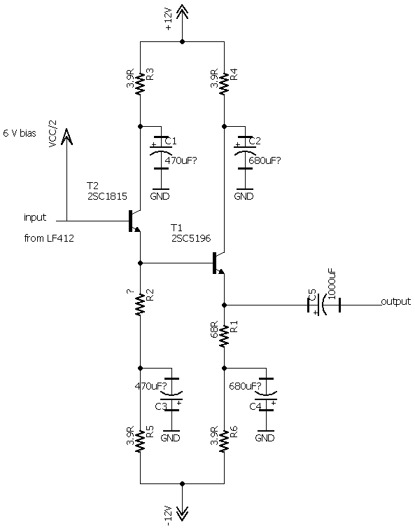

Every couple of years I get bitten by the "how'm I doin'?" bug and find myself buying a commercial unit to try out against my own stuff.
I wrote about the Orb Jade-1 in a blog post. In this forum post I will examine how it stacks up against my Sapphire3 as a pure headphone amplifier.
Source is my analog stage, Phonoclone 3, Denon DL-103, DP-2000/DA-207 turntable/tonearm. Headphones are Sennheiser HD600.
My best guess of the Jade-1 headphone output stage is attached below. The configuration of T1 R1 and C5 is 99% certain. Output coupling cap is Nichicon KW. T2 and R2 and the details of the biasing network are unknown.
The +12 and -12 V rails are generated by 10,000 uF cap, LM7x12, 10,000 uF cap in the power supply. The rails are shared between channels.
So first let me tell you what I heard, then I'll speculate why it sounded like it did.
With a good analog signal instead of the internal DAC, the Jade-1 sound is pleasant, smooth and warm. No trace of midrange hardness or glare. Good bass extension. The first indication of trouble was I noted I could not hear the needle running in the groove of the LP. That hiss of surface noise was absent, even in the lead in and lead out. the second indication of trouble was that I couldn't hear "into" the music. Sounds are presented in some semblance of stereo, but there is no space between them, and, crucially, no depth.
The best analogy is to say it sounded "tired/heavy". It's all smudged out: no air, no splash, no rhythm. All the treble information is sucked out of the music leaving only dull smoothness. If you are familiar with the recording and have multiple references to compare, it's brutally obvious that the Jade-1 is giving a very odd rendering. It's just plainly off.
The Sapphire3 puts the life back into recordings. It really is night and day. Stereo image seems to extend twice was wide, and there is proper sense of depth. But more than that the tone is back to what I know to be on the LP. Instruments sound like they are supposed to sound.
So, what went wrong?
I suggest most of the problem is the power supply. Nice R-core transformer, but at most a 3A bridge rectifier feeding 40,000 uF!? LM7812/7912? I know, it's not uncommon to find this in high end equipment, but I think its just totally the wrong way to go about it.
The other point is the RC stages locally at the output stage. RC stages on the rails often seem to dull the sound, at least in solid state applications.
Shared power supply does nothing for the stereo imaging.
A large electrolytic output coupling cap often results in an overly slow, damped sound.
In my experience the single ended follower output stage does not necessarily sound better the more current you send through it, and is rather dark-sounding at the best of times. The Jade runs at over 250 mA bias.
Anyway, all very fascinating. I've played around with followers as headphone amps before, with the J-Mo II for example, and while there are some tonal similarities I can recognize, the the J-Mo has for more clarity and definition than the Orb design. So in this instance I think most of the blame falls on the power supply, and designing it on paper for lowest noise and energy storage rather that listening evaluation.
