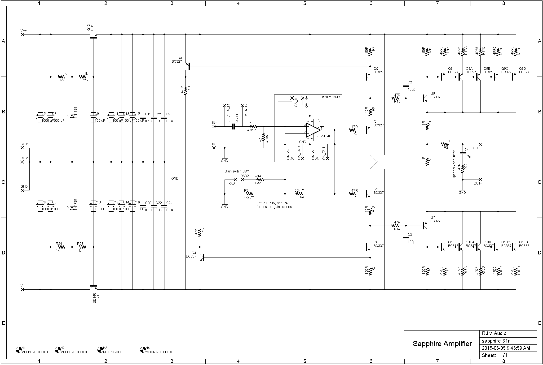

I had a long squint and for R73 it looks like 562 (5k6). You could probe with your multimeter on ohms between pin1 and pin2 (crosscheck against pin7 and pin6) of the LF412 and see what you get.
If it really is 5k6 that's quite likely a cause of your HF clarity going south.

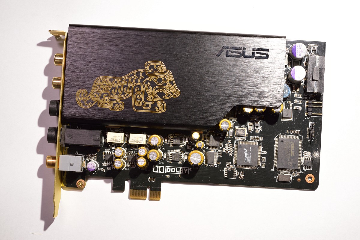

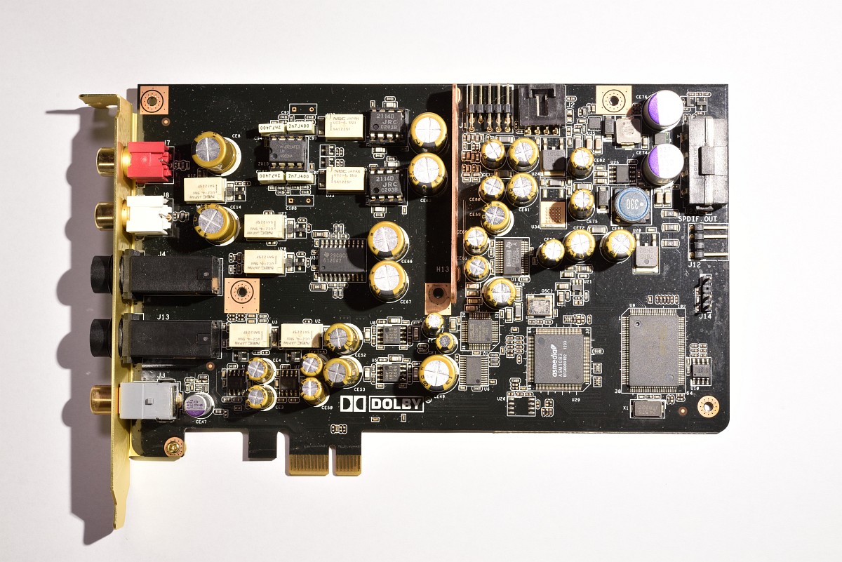

Ok, here's more of a challenge. Sapphire3 vs. the TPA6120A2 output stage in the Xonar Essence STX sound card.
This puts the Sapphire3 at a large fundamental disadvantage as the TI headphone amplifier replaces the final op amp of the DAC's IV/filter stage. So this huge chunk of line level output - the op amp, interconnects, volume control, and (crucially) the very low level analog signal after the volume control leading up to the Sapphire's op amp - is removed from the signal path. Using the built-in headphone stage the volume control is done in software by the ASUS controller IC, after the signal has been upsampled to 24/92 but before it even reaches the DAC. In theory that's a far superior method to doing it in the analog domain post conversion, even with the fancy Goldpoint attenuator I recently fitted to my Sapphire3 amp.
To cut to the chase: it's a very close thing. The TI headphone IC sounds very listenable. In many ways it's like a baby brother Sapphire3: soundstage and overall presence dialed down from a 10 to an 8, but with a sneaking suspicion that the native Xonar headphone output is fractionally cleaner.
The highest complement I can pay it is to note that without looking down to see if the headphones are plugged into the Sapphire3 amp or the computer front panel, I cannot immediately tell from just a few seconds of listening which it is I'm listening to.
It's only on the more complex, difficult musical passages that the additional stability and drive of the Sapphire3 make it clear that the IC, despite all native advantages, is not going to win this.
Interestingly, the background seems blacker with the Sapphire3 though it should be expected to have a lower S/N.
Just a guess based on the TPA6120A2 datasheet and your descriptions of the sound, if the Sapphire is "voiced" with a LT1357 opamp, it will sonically match the Xonar Essence.
As for the blackness - it's more black with most of the DOAs. Given the technical specs of opamps like the AD797, this should not be so or even audible. It could be due to DOAs running their input and output stages in class A mode over a wider range?
I have 2 Asus STX, I'd be quite disappointed that sapphire doesn't outputperform by a large margin the HO of the Asus.
Low impedance headphones sounds average on the Asus, a black background is a nice start, but expect a little loosy bass, cripsing highs. High impedance beyerdynamics sounds better.
Both line out and headphone out is plagued by an average soundstage definition & layering, image lacks precision. I stoped using both of my Stx... In my humble opinion, Sapphire quality must be dac limited in your tests. 😉
About sapphire design, I wondered if it would be possible to have a switch to (truly) bypass the whole voltage gain stage to use only the buffer when voltage gain is unnecessary?

It's not as convenient as a a switch, but it is easy to drive the buffer directly from the rev. 31n boards: just remove the op amp and attach the input to the OA_OUT pad. The circuit is now DC coupled. Careful!
An op amp bypass switch would be a little complicated to implement, as both the input and output of the op amp would have to be reconnected.
The Sapphire is already optimized for 60 ohms. There isn't that much to change - or that much to be gained - from reconfiguring the buffer for 25 ohm headphones. You'd want to double the bias current and halve the supply voltage.
I suggest you change the Zener diodes to 9V, use a transformer with 2x9VAC secondaries, and increase R10,R9 to 15 ohms. That will get you most of the way there without throwing a wrench into the circuit and messing everything up.

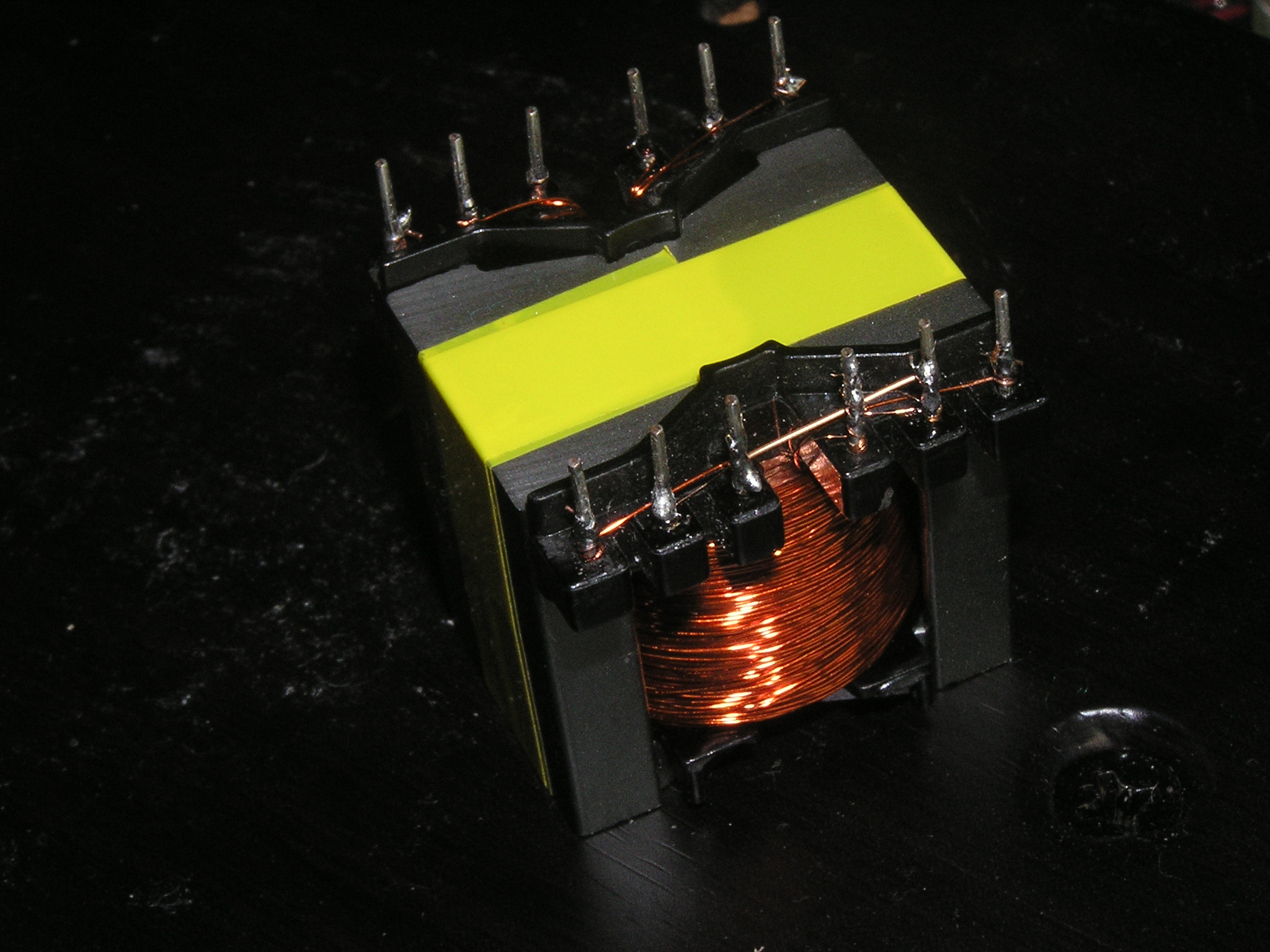

I've built one, I'm in the process of building a second one. Some details of both are on my blog. I don't really understand why they're not used with SS electronics as they solve two issues rather nicely. Firstly that the vast majority of SS amps don't have adequate PSRR, you always get to hear the PSU. And secondly they allow easy adaptation to a very wide range of impedances of headphones without the complexities of variable bias and variable supply voltage.

The size is partly determined by what output impedance your 'phones want to see. Me, I'm happy with having at least 10X lower than the 'phones, actually I aim for about 5% of their impedance but don't worry much unless I get to 10%.
Assuming then your 60ohm phones didn't mind a 3ohm source impedance then the next determinant of the size is the LF extension. I'm happy to handle full power down to 40Hz, at 20Hz I'll be -6dB.
Given those two provisos you can build a trafo around a PQ32/30 ferrite core which is (worst case) 31mm high by 34mm across, 23mm deep. With 5cm to play with you can go all the way to 20Hz at full power I reckon.
Top end bandwidth I've not measured but I'm sure it goes way into the ultrasonics as trafos don't struggle with higher frequencies (especially not ferrite ones which have very low losses), its LF which gives them grief.
Here's a pic (from my blog) of my most recent trafo build - its a PQ32/30 step down 37 : 1+1+1+1 : http://www.diyaudio.com/forums/blog...ing-best-bang-buck-headphone-amp-p1010035.jpg
