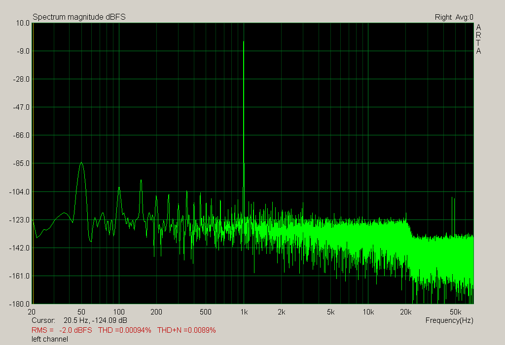

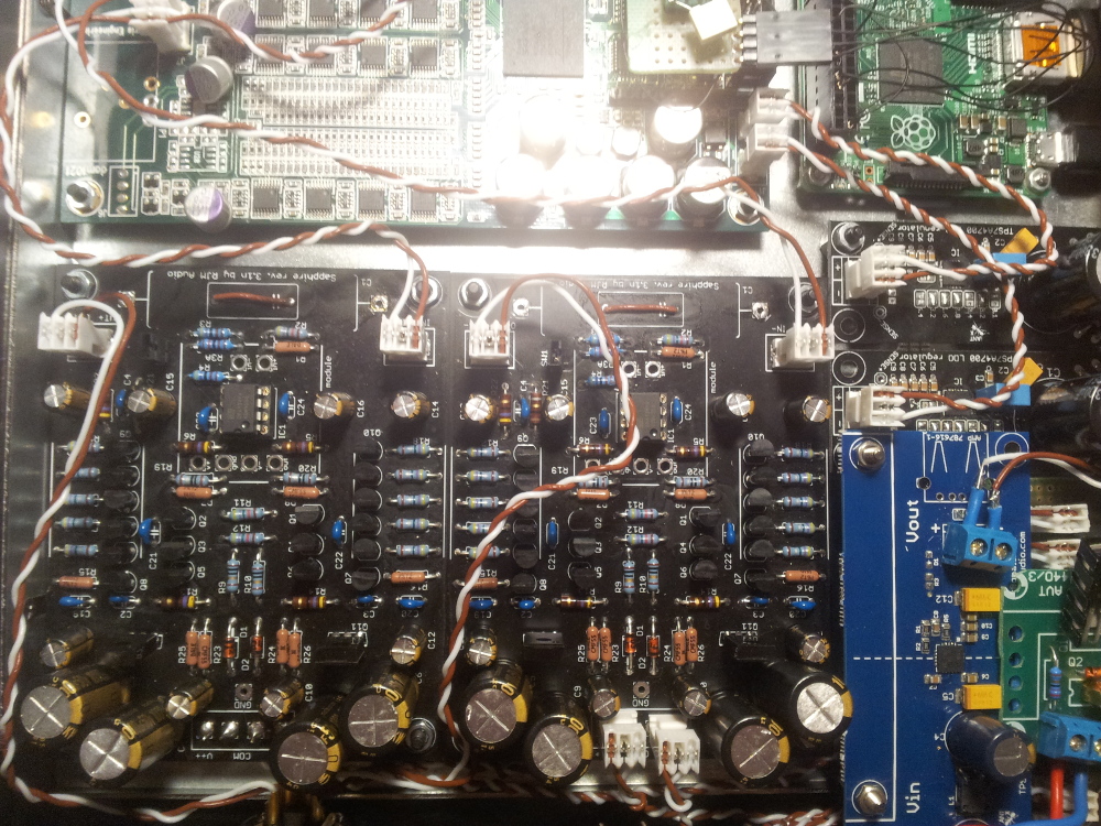

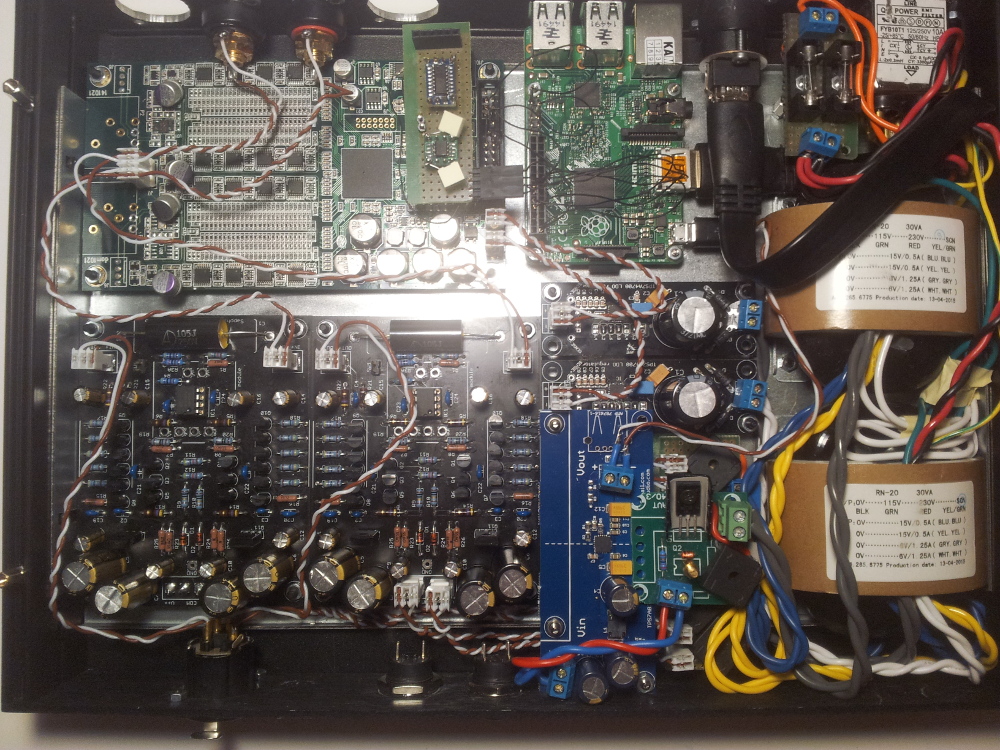

Finally I've managed to get rjm's kit assembled. My aim was to pack everything in a one box. It's quite dense and messy there, maybe there are some flaws wrt component placement, but I'm quite happy with the final results. Signal path is as follows: rpi (flacs are stored locally on flash)->i2s->dam1021->sapphire. Volume control is done at dac fpga and integrated with mopidy [1], so effectively everything is managed either through web browser or dedicated mpd client. In my case it's mpdroid [2].
This my first diy audio project. Nonetheless I found it quite easy to solder everything on sapphire boards. Power supply is delivered by 2 r-cores with multiple secondaries. I used 15V/0.5A (instead of recommended 12V) for headphone amp. Temperature of bd135/6 packages hits 50C. Other secondaries are used by dac and rpi. As a result I replaced 1000uF 25V Nichicon FW found in the kit with 1000uF 50V Nichicon KW. Z-regs work quite well. One rail of one board gives slightly lower voltage (0.2-0.3V less than the others), but this due to zener diode accuracy. Other z-regs surprisingly give similar output voltages of +/-10.7V IIRC. Opamp feedback resistors: R4=4k7, R3=4k7, R3a=1k2. Usually a higher gain is set for my dt 880 (600ohm).
I let it run for a couple of days before making any judgements. But even after a couple of initial listening hours the most significant impression could be articulated: sapphire delivers power effortlessly, no matter whether acoustic, intimate track or some insanely dense electronic cut is in queue. A very good companion to the r-2r dac. I'm starting to like listening through headphone.
Thank you, rjm!

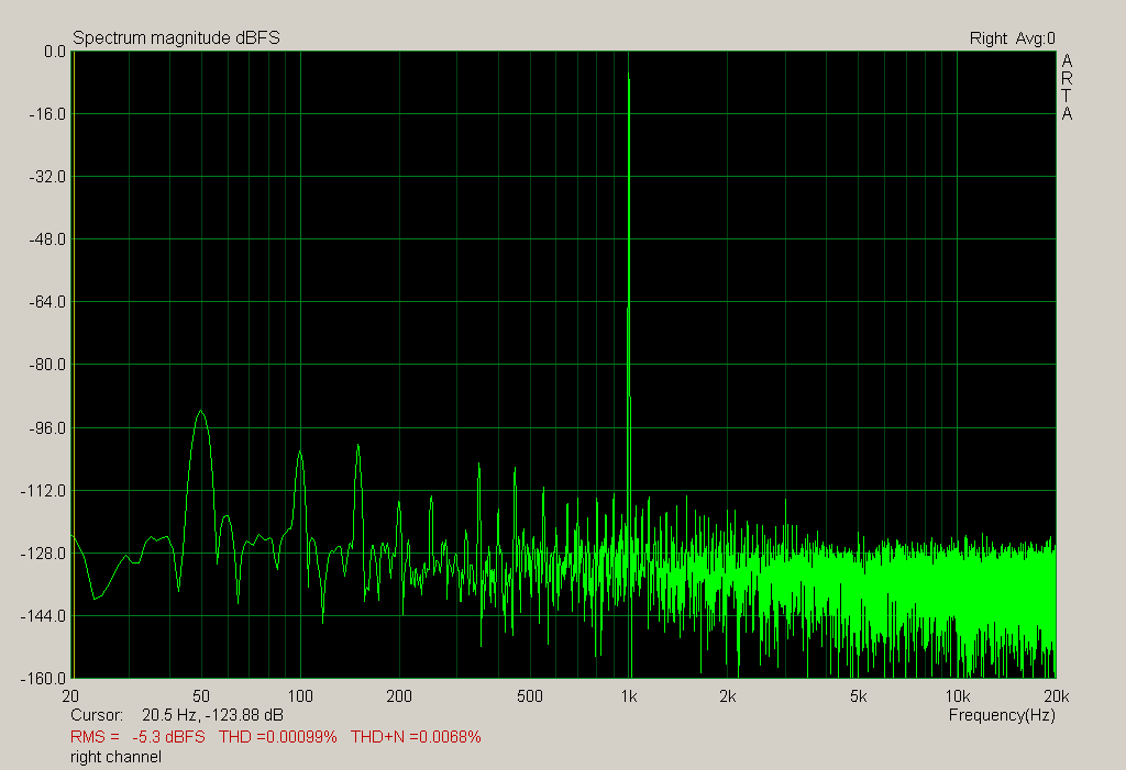

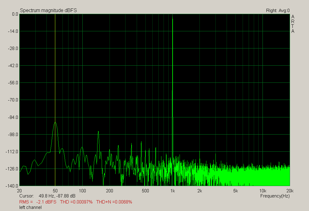

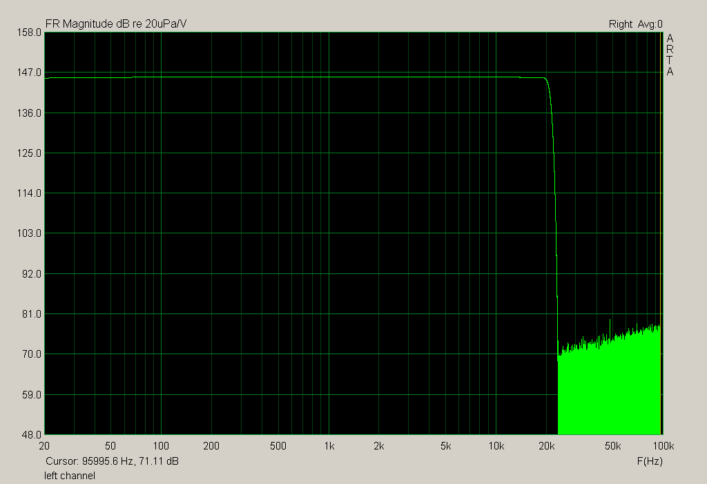

PS. I've made some measurements using emu-0404, but more for fun and learning than anything else.

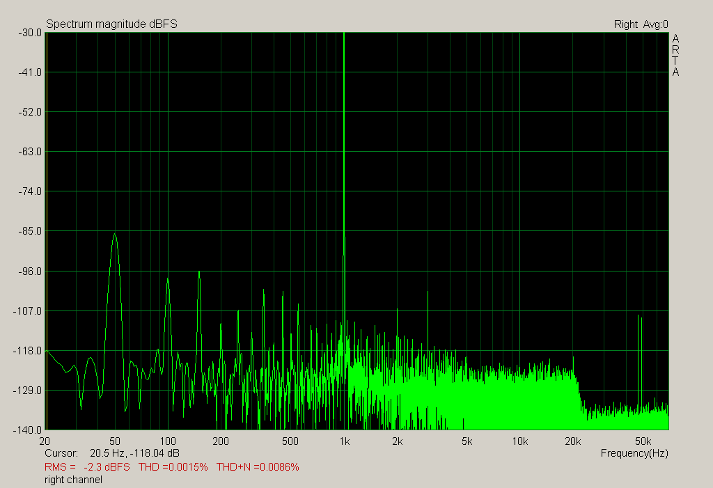

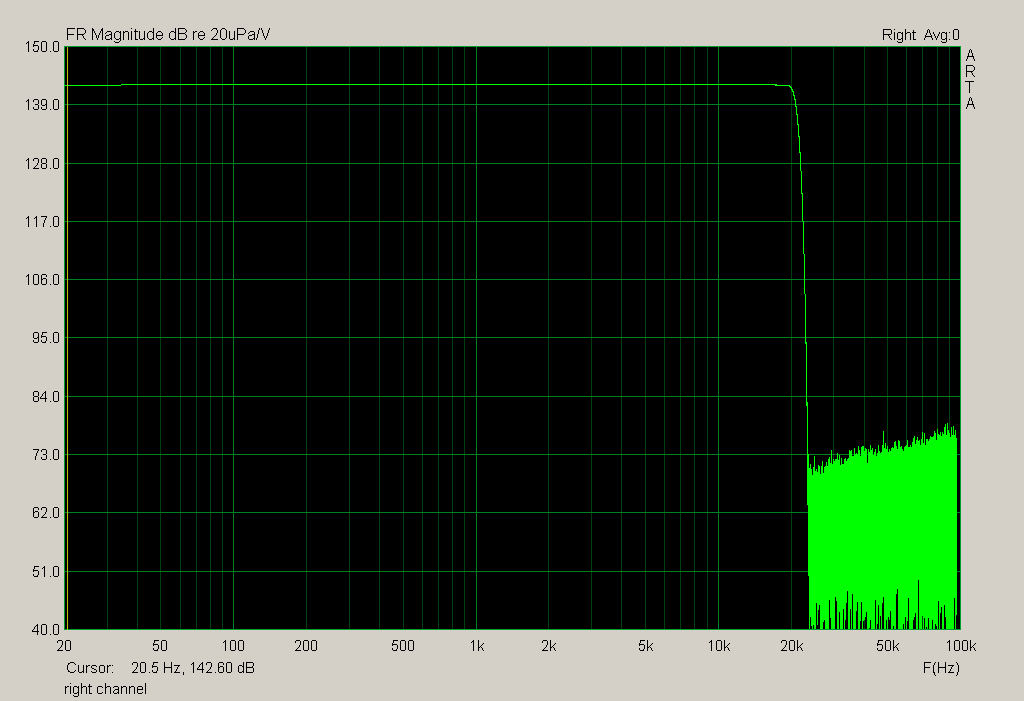

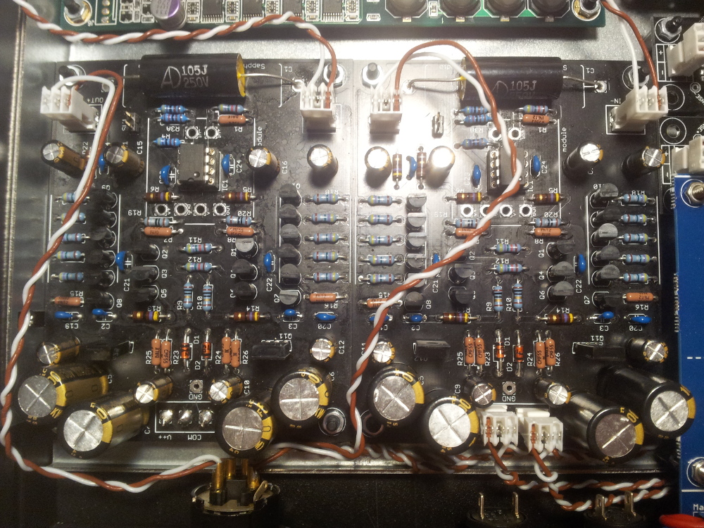

Although the quality of sound produced by default configuration is satisfactory, I've noticed soundstage is somewhat deteriorated as well as lower registers are slightly sluggish when compared to my integral amp and floor speakers fed by the same dac. So I decided to remove C1 caps from signal path.
I must say this mod kicks sapphire to a new highs when it comes to microdynamic and stereophony attributes of sound reproduction. And that charm of the mids!
btw. I have noticed slightly lower harmonics of household power. Is that really because of these C1 caps?

Since you are running the DAC directly (?) into the Sapphire, there is probably no need to have the coupling cap C1. Removing it could, I suppose, reduce some power line noise coupling since the DC impedance of the whole input section is lower. The impedance at 50/60 Hz though would be low even with the capacitor so I'm not quite sure what's going on there I admit.
C1 takes a long time to break in as only passing a signal works .. just having the Sapphire powered up has no effect. And replacing the kit C1 with a better audio cap is also recommended.
Thanks very much for your report and the photos. Just so you know, your measurements are mostly showing just the response, distortion, and noise of the input source rather than the Sapphire circuit. Though at -128 dB the noise floor looks about right.
