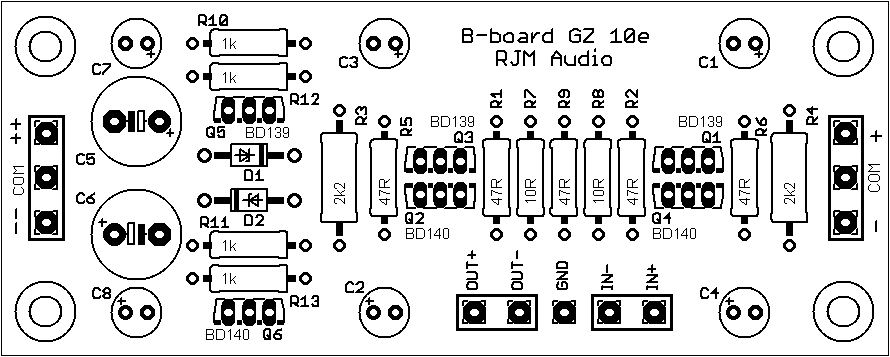

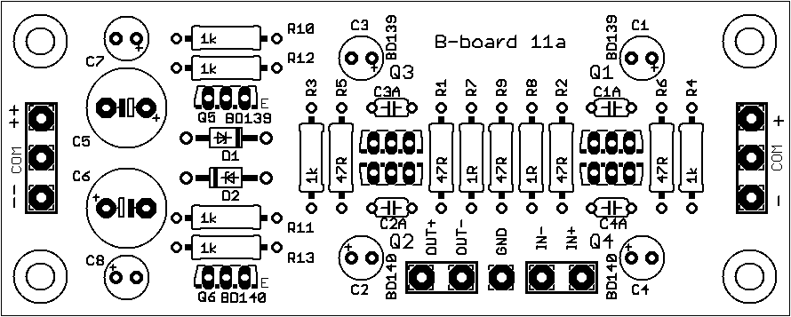

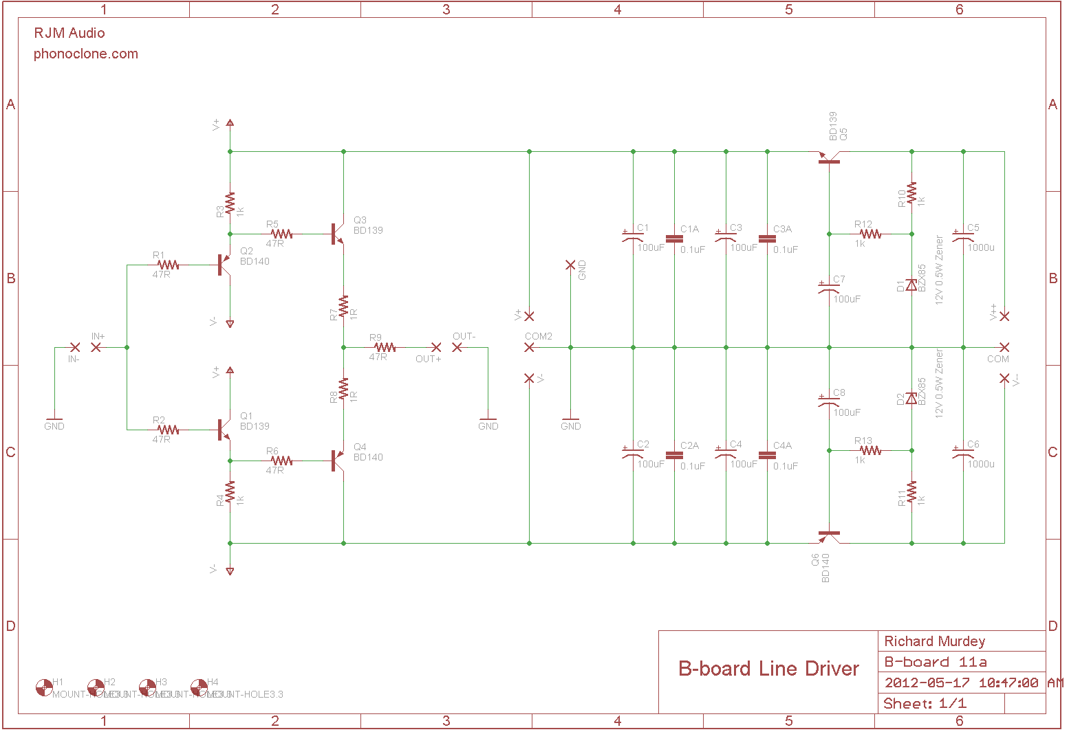

Yes, from now on I will use the BOM with R3,4 1k and R7,8 1R. This is, as much as anything, to lower the number of different resistor values. I don't think it changes the sound much if at all. The board layout has also been revised to add the bypass caps C1A-4A.
