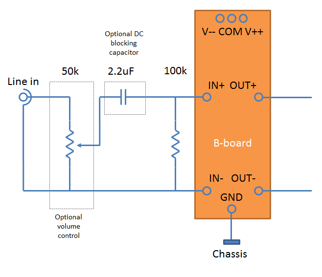

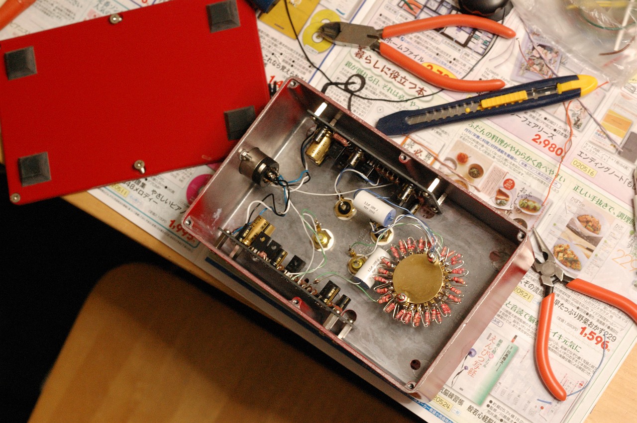

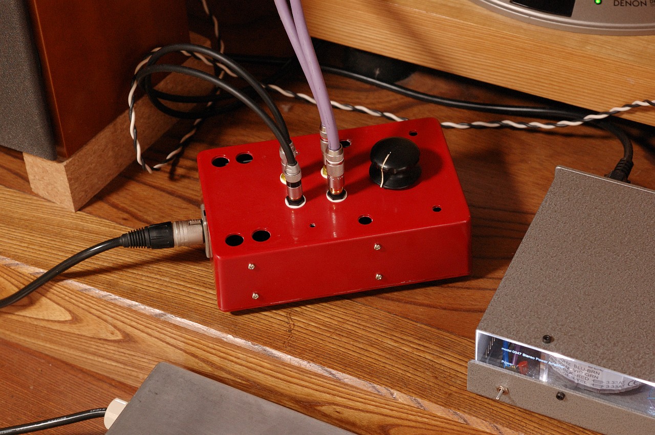

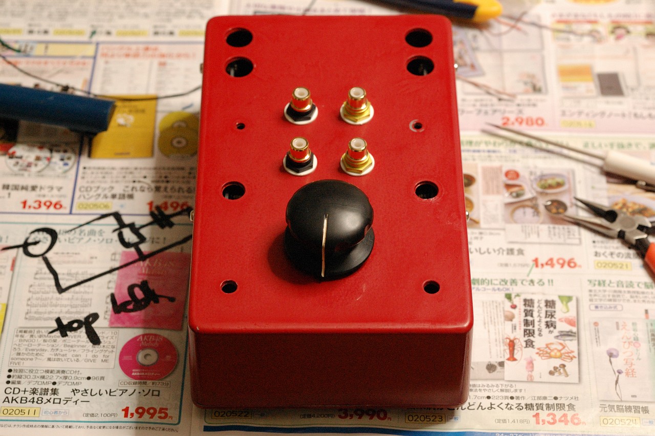

To test the B-board buffer modules, I stripped my Gainclone and transformed it into a buffered volume control. (Think of it as a preamplifier with no gain and no functionality other than a volume control.)
The volume control goes to 2.2uF* film coupling capacitors, which run to the B-boards with 100k resistor across the inputs.
Works fine, gain is a fraction low of course but its certainly quiet! Output offsets are about 50 mV.
Need to let it break in for a couple of days.
Unfortunately its going to be a bit difficult to make an evaluation, since the influence on the sound is going to be quite small I expect, and I don't have anything obvious to switch it out for to make a comparison.
* 0.47 uF is sufficient, I just didn't have that value on hand.

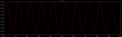

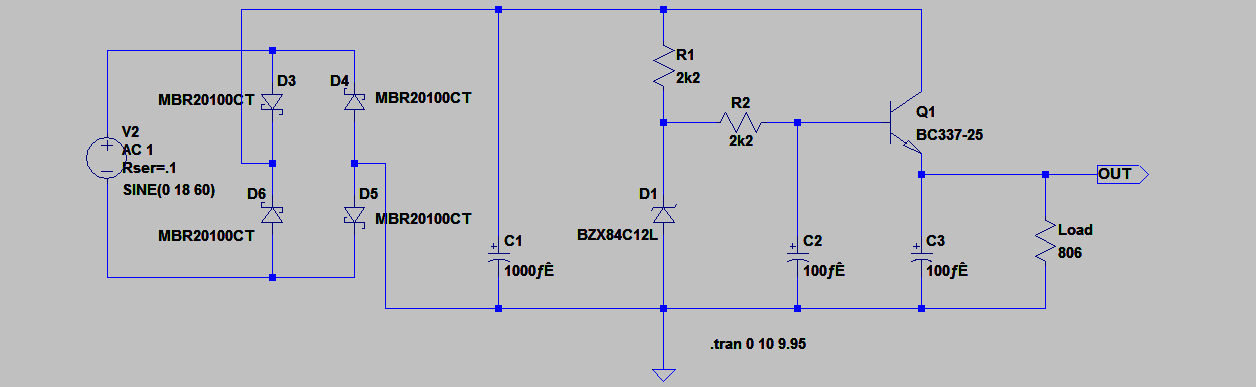

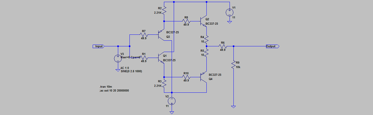

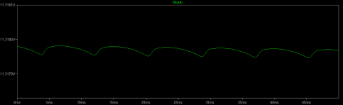

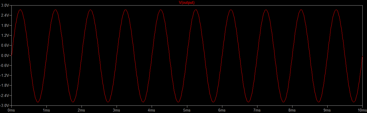

ltspice files for the B-board including the simulation for the Z-reg voltage regulator. For the 15 mA or so current drawn by the buffer, the Z-reg output ripple is about 30 microvolts.
PSRR of the buffer circuit is about -50 dB.

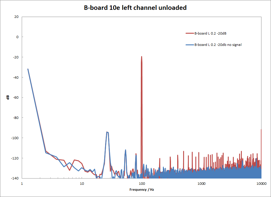

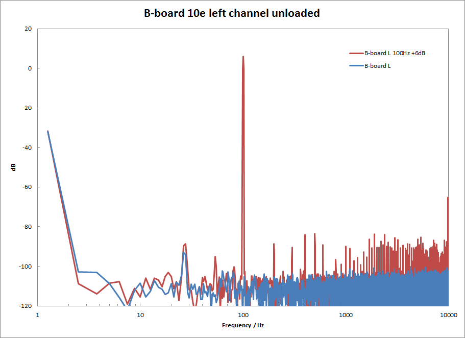

Simple test, just to confirm what my ears already told me: a clean bill of health.
It's a unity gain line buffer with a regulated power supply. If its working properly, it's going to be essentially below the measurement threshold of my instruments. Indeed this is the case here.
With the volume at -inf, the output noise is below the measurement baseline of ~-115 dB. The peak at 28 Hz is an artifact of the test setup/instrumentation. There is no measurable hum or noise.
Applying a 100 Hz sine wave of 2.8 V amplitude (+6 dB), there is no measurable distortion above the digital sampling artifacts of the function generator which spread out evenly at around -90 dB for all higher harmonics.
(not shown) Above amplitude 5 V (about +12 dB) clipping distortion is evident.
Measurements taken with a National Instruments USB-6215 multi-function DAQ.

rjm
Joined 2004
So how does it sound?
Well, if I close my eyes, it is easy to imagine I'm listening to a high end pre-amplifier. It adds nothing but a slight sense of authority and a certain "lift", that micro-detail that seems to lend the music that little bit of extra realism. Perhaps. That's my impression, but I haven't done any direct comparison with the passive, unbuffered output of the attenuator yet.
I like it, anyway. "It" is subtle, perhaps very little, but whatever is there is, I'm convinced, a positive effect.
rjm
Joined 2004
Re-did the measurement at a slightly improved sensitivity setting. The measurement limit is -139 dB. The B-board output is perfectly clean, no ripple noise right down to this limit. (30/60/90 Hz peaks are measurement artifacts) The distortion signal of a -20 dB sinewave is also very clean, nothing visible right down to the digital noise of the function generator.
Long story short: a cannot "see" the B-board with my measurements, and, frankly, I can barely hear it either. It is transparent, while fulfilling it's role as a buffer.
Mission accomplished!

To check a few things, I'm building a second set with an experimental BOM, BOMX below.
  1. Emitter resistors R3,4 lowered to 1k to increase the bias current.
  2. Emitter resistors R7,8 lowered to 1R, which raises the bias current in the output stage to more closely match the driver stage, at the expense of stability and increased likelihood of thermal runaway.
  3. Ceramic bypass caps added in parallel to the four electrolytics after the Z-reg. If there is any high frequency stability issues, this should quiet things down.
rjm
Joined 2004
For reasons explained in my blog post, I'm fairly confident that of the changes made (3) above made a very large improvement. For some reason, adding ceramic bypass capacitors sweetened up the treble, removed glare, and generally improved the musicality.
According to the simulation the diamond buffer bandwidth is about 4 MHz, clearly higher than the usable range of the electrolytics, which extends to perhaps 1 MHz. On the other hand there is no signal energy up there, and even if there was it would be inaudible, and furthermore the circuit is not in any kind of feedback loop, so I wouldn't have expected any instability or indeed great effect on the sound. But there you are, if I had expected it I would have built it that way in the first place.

Re. parallel, yes, just feed the attenuation output into as many B-boards as you need. No need to match anything, or any other special precautions. What you are asking for is exactly the job buffers are designed to do.
See circuit in post 23 for the details of configuring the B-board with a volume control. The coupling capacitor may not seem like its necessary, and in many ways its not, but what it does do is make the output DC offset of the B-board independent of the volume setting. Without it you may hear "clicks" when changing volume if you are using a stepped attenuator.
