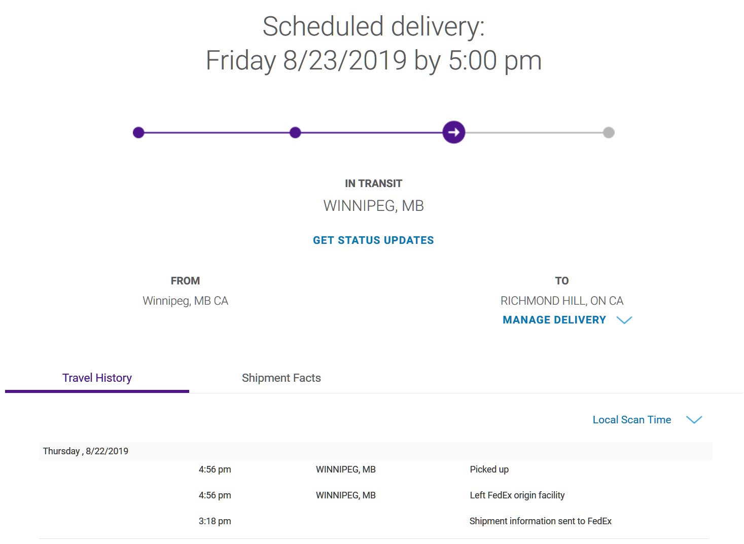

Maybe, but the shipping manifest shows shipping straight from Winnipeg, a couple of hours after the order was placed. Unless they have a way to teleport merchandise to Winnipeg I don't understand how this happens. Whatever...
Example from today:
Order placed at 1:35PM, at 4:56PM order was picked by FedEx in Winnipeg. The package could make it over the border and through customs, 250Km from Thief River Falls to Winnipeg in 3 hours only by teleportation. Or perhaps they hired a private flight for my order 😀.
From Wikipedia:
"Digi-Key is located in a single, centralized location in Thief River Falls, Minnesota. Its facility measures 800,000 square feet (74,000 m2) and houses over 3,400 employees. In 2017 the company began work on a 1 million square foot expansion to their Thief River Falls facility at an expected cost of $200 million to $300 million. The expansion was helped by government incentives and tax exemptions and is expected to add another 1,000 jobs at Digi-Key."
Google maps says Winnipeg is a 2.5 hour drive from TRF, MN

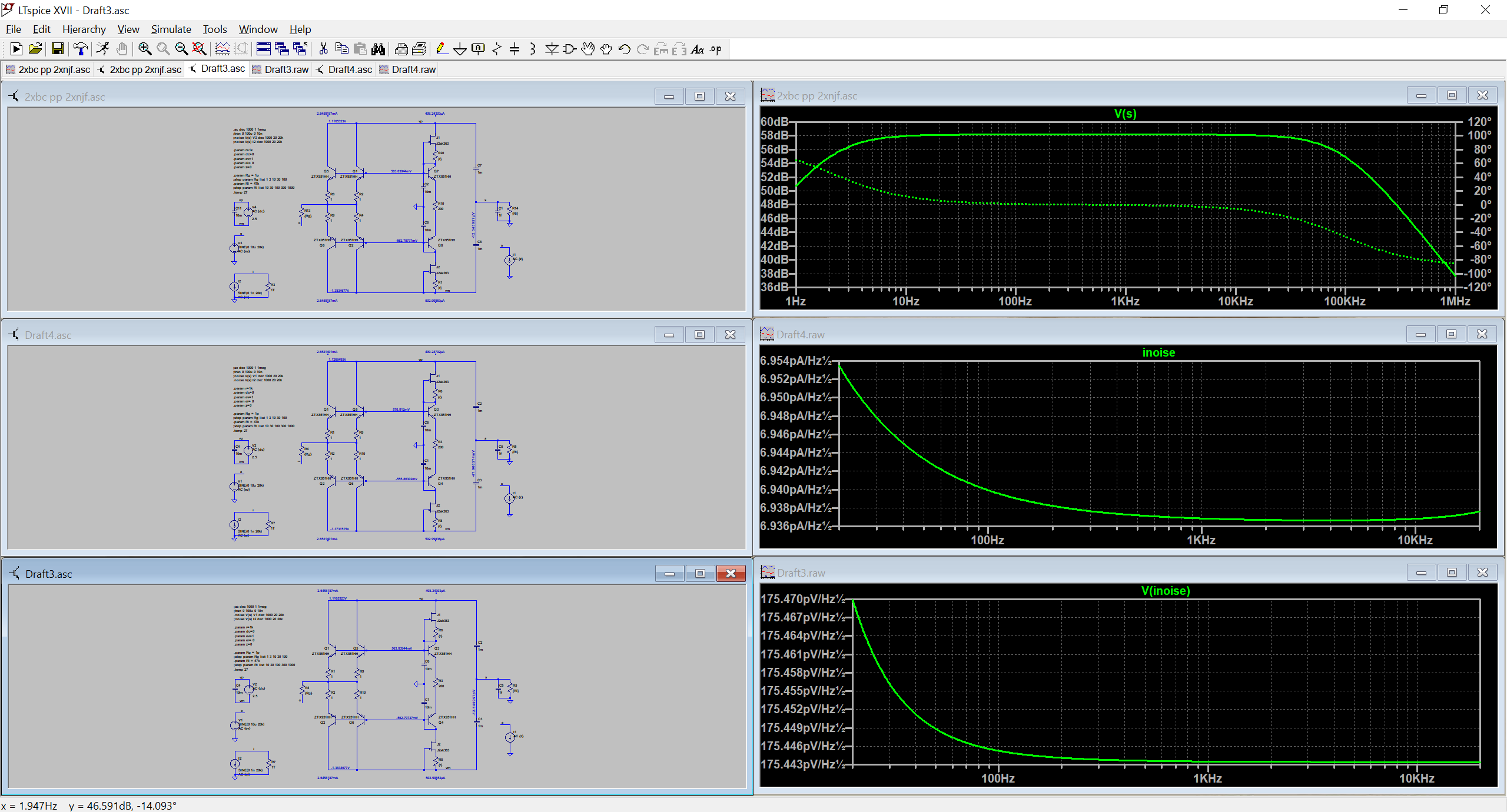

#375's gain is limited by R4 & 5, which feed the current mirror and appear in parallel with the output resistor R7.
Duraglit has a similar 'limitation' with supply voltage.Nope. #375 gain is limited by the power supply voltage. It is independent on R4/R5.
But at the high gains which seem to be of most interest to herve00fr, Duraglit has some 40dB more gain potential than #375
Nope, it is completely different in this respect. The gain depends on the load and the bias resistors.
And the bias resistors depend on the supply voltage.
To add insult to injury, too much gain in the head amp is bad for the overload margin. IMO, anything between 15dB and 30dB is good enough, no need to go for more. 40dB or more of gain would also challenge the MM input the head amp is supposed to connect.
Herve, what models are you using here? Your noise figures seem to good to be true.
In real life, I use 2sk369V instead of 2sk363.
It's diy, you can lower the gain of the MM RIAA preamp.
For very low noise purpose, high gain in the first stage is mandatory.
