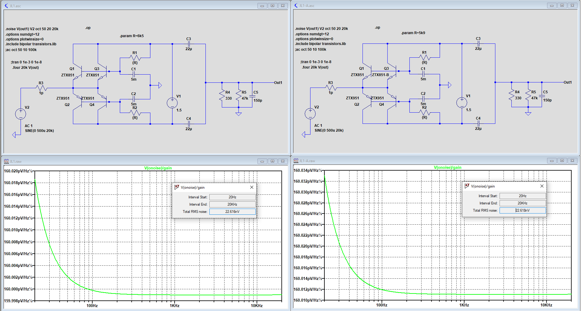

It might be useful to do a sensitivity analysis on device match for paralleling.
The effect is surprisingly mild.
I created a ZTX851-B with 2/3 Hfe of the ZTX851.
Then I adjusted the base resistance from 6k5 to 5k9 to keep the total current through the transistors in both cases at 5.5mA.
Result in noise goes from 22.616nV to 22.618nV, almost no difference at all !
Hans

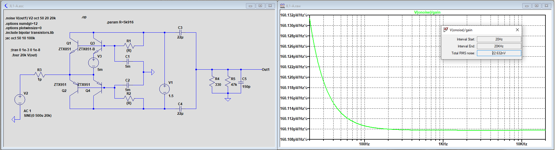

Good, there is Vbe match too possibly more important. The emitter ballast resistors hurt the noise and at a couple of milliamps 1 Ohm does not do much. I don't know the distribution one might expect, but it only takes 18mV for 2:1 ratio. Usually the need for matching is overstated, it might be nice to put a number on it.
As a next step, I gave the ZTX851-B a 5mV Vbe offset, still keeping the total current through the transistors at 5.5mA.
Noise went up a tiny little bit to 22.632nV.
For the time being, this circuit seems quite resistive to individual transistor differences,
Hans

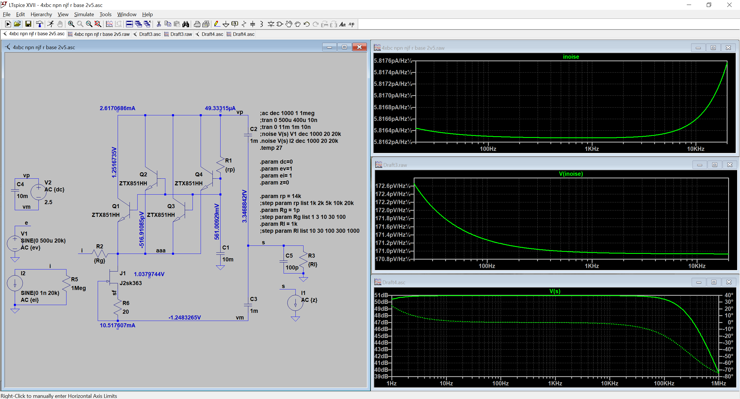

I think that matching will not be really critical.
If I simulate the Duraglit with e.g. 6mA Ic the resulting noise en noise density is 173pV/rtHz (for the amp alone, Rs = 0), If current is simply doubled, noise reduces to 140 pV/rtHz. If two transistors are in parrallel with 6mA each, noise reduces to 122pV/rtHz. This lower value can be explained as in the later case, Rbb of the transistors is also halved while for doubled Ic alone, everything is halving except Rbb.
If transistors are slightely mismatched, the reulting net penalty in noise performance will be small (result will be between 122pV/rtHz and 140pV/rtHz from the example above)
Hans
That is exactely what I found (one of my posst from a couple of weeks ago) when creating ZTX device models with Hfe of 100, 200 and 300 (min, typ and max values from datasheet) and simmed various combinations out of them including paralleling two of such different devices. When adjusting the collector current by changing the base resistors, performance was not changing at all.
