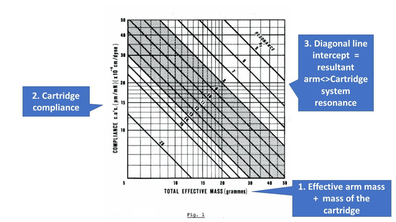

Here's a useful graph showing the resultant arm<>cart resonance given arm effective mass and cart compliance - its from SME
I looked at the Ortofon 2M series plus the SME3009 II and the resonance comes out at about 8Hz - so on the low side per the B&K app note.
Interestingly if you go onto the Rega site, they do not quote the effective arm mass for a few of their arms which I find a bit strange.

It's the same graph as the ortofon one but plotted on log paper to give straight lines. Seriously have you only just discovered this?
For 21st century stuff have a look here Vibrational Energy of MC and MM Cartridges, Part II This is where it gets interesting. Sadly more questions asked than answered, but its a great start.
I'm reading up on this stuff @billshurv - ya gotta start somewhere . . .
