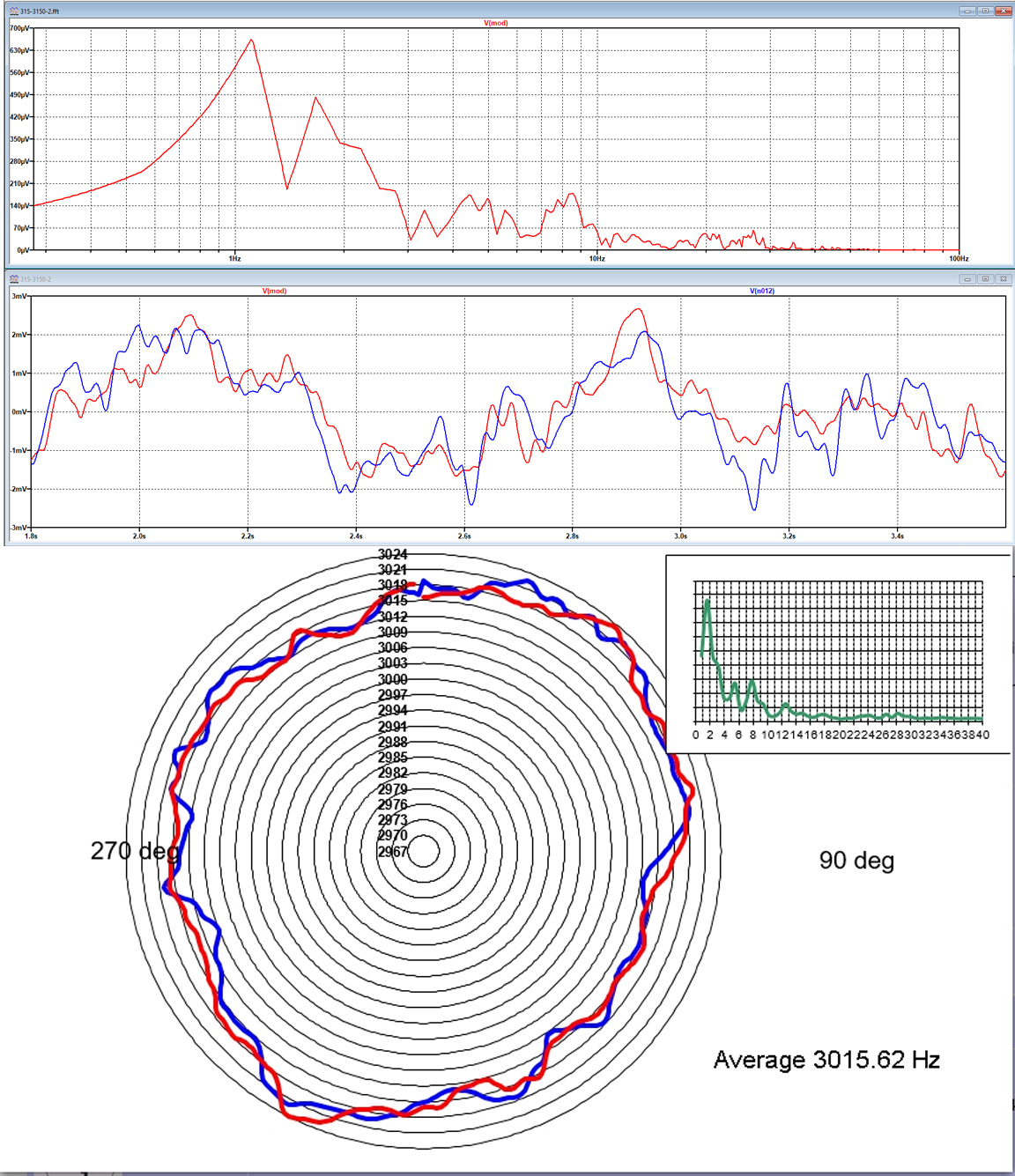

Did you already have the opportunity to read the B&K paper?
In fact there is a strong relation between the LF spectrum below 15Hz of the vertical movement of the cart and the FM modulation of the signal.
See image below of an example of the actual frequency of an 3150Hz recorded tone over 2 revolutions on an LP and the spectrum of the signal modulating this 3150Hz.
The lower part is made by LD, the upper part from my hand, showing the same, but in a somewhat higher resolution.
What you can see in the FR of the modulating signal, is the flapping of your cone as the strongest component.
But there are much more components to be seen, where especially our auditory system is most sensitive for modulation components in the 4-8Hz region.

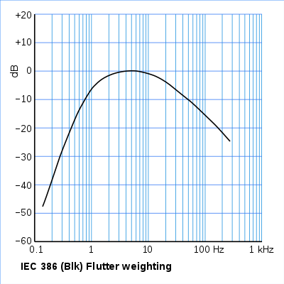

That's why there is a IEC386 filter that focusses on the audio band of our highest sensitivity.
And that's also the reason why you should stay away with fres Cart from this region.

Blimey hans, that FM polar is awful. What deck is it, you can see cogging, suspension and warp errors.

Nice plots - but what is the frequency axis and it's resolution? The most important axis is not labeled.
Depending on the selected scale and resolution, you can make any curve look smooth or wildly bumping.

Is it an idler TT, the 4 Hz could be caused by the idler wheel if so? And the oval shape may be due to platter errors.
That was chosen I believe as a particularly bad example to show all the effects (including eccentricity).

Several of us did a version of this tool that anyone can use for free in another thread that has been idle for a while (you do need Python). The frequency is labeled radially so if you use a 1K reference tone 1Hz "ticks" are 0.1%. The warped shape to the circle is LP eccentricity which gets slightly elliptical because, if you think of the geometry of the plot you are actually projecting an off center circle onto a conical surface (because the frequency ticks are evenly spaced).
IIRC a typical 300rpm belt drive gives a 9Hz artifact. One user with a perfectly centered test LP and a very good Lenco made an almost perfect circle.
NOTE - You can do this without the polar plot in any tool like Octave or Matlab using a filtered Hilbert transform which is built into all of the math libraries.

Andreas, you are quite right right.Nice plots - but what is the frequency axis and it's resolution? The most important axis is not labeled.
The frequency axis is the spectrum of the signal modulating the 3150Hz from the LP caused by warp etc, etc., but not yet filtered by IEC386.
The vertical axis shows the rms value of the wow at a certain frequency, where 1mV corresponds to 0.1% rms.
Rms value of the modulating signal in the time plot, should be below 0.1% after IEC386 to be inaudible according to DIN and that's what most recordings meet, although more expensive turntables show figures at 0.04% or even below.
This sample isn't quite as bad as it looks and meets, when I rember correctly, something like 0.05% wow after IEC386.
