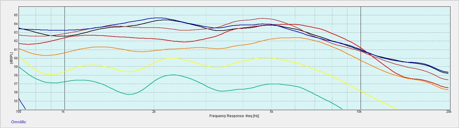

Yea the smoothing was attempt to easily see the gross FR changes without the wigglys . The ribbon as a direct radiator is quite smooth however, about +-1.5 db all the way out with a very clean impulse.

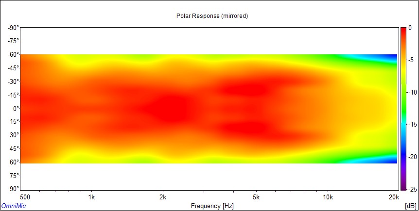

So question, I see from WG graphs I posted that the entire FR does not evenly reduce off axis until about 45 degrees. it looks like the extreems are down a bit as we go off axis BUT it isn't until about 40 degrees or more that the whole curve is down. I see this effect BTW with ALL my WGs reguardless of size shape. Im not sure but I thought the intent is to have entire curve down somewhat evenly at each off axis point?

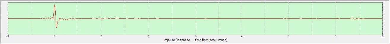

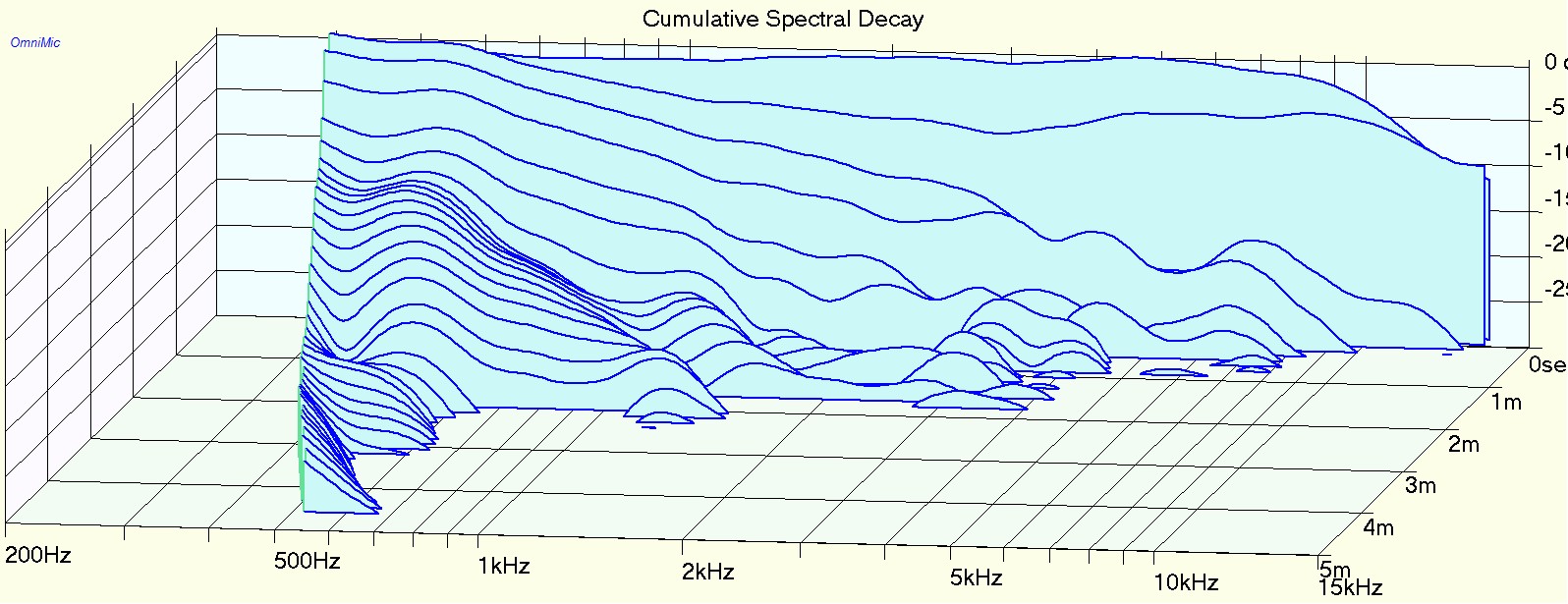

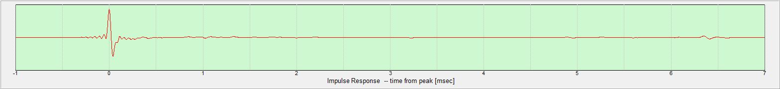

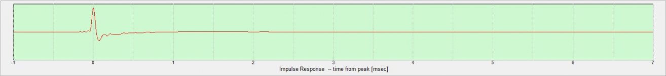

More data...

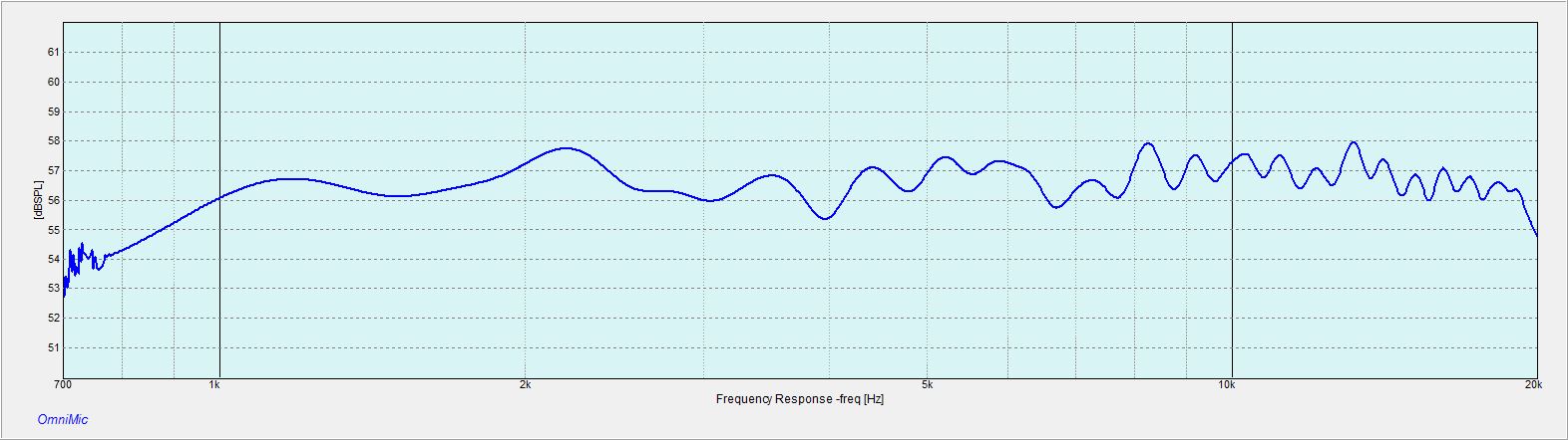

1st graph is ribbon freq response with trap, NO wave guide, and NO smoothing
2nd is a close mic ( approx 1/2 inch) CSD direct drive , no trap, no Wave guide

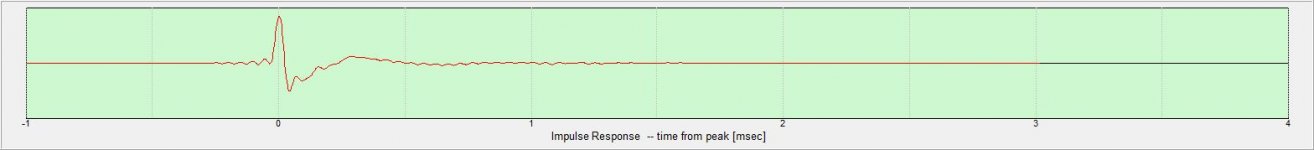

3rd is impulse close mic, no wave guide
4th is impulse, at 1/2 meter, No wave guide

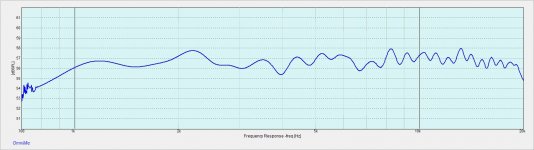

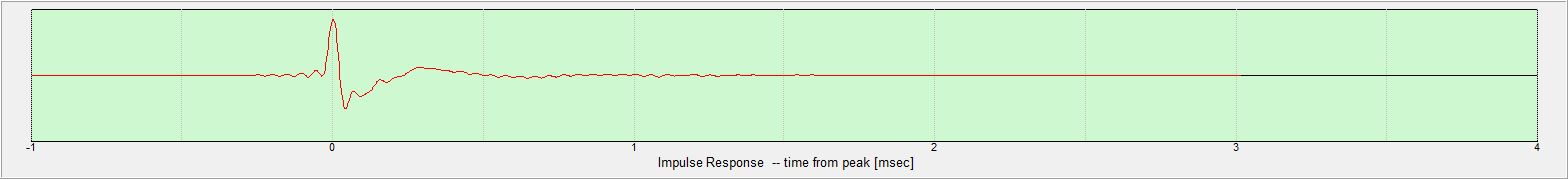

1st: Gate on first measurement should be changed becouse it created ripple on frequency response, which type of gate and window limit (Hz, microseconds?) exactly did you use?
2st: Could you make the same measurement of random well-known dome tweeter? This CSD looks too good to be true. 🙂
3rd, 4rd is just like in point 2nd...

1st I think it was 5 ms and was taken at about 1/2 meter. Can do again for sure . What settings would you like to see??
2nd I know what your saying on the "too good". BUT I assure you I spent many years refining that ribbon construction to get that smooth.My reference has been ultra low mass flat ribbon diaphragms similar to RAAL. I worked until my higher mass ribbon had a similar signature.

3rd- yep it is the best pulse I have ever gotten. When I first tryed this construction I was sure something was wrong with set up or measure system.

I am sorry, I have no spotted 1 dB magnitude grid scale... Looks more or less correctly if so.
I am sorry, I have no spotted 1 dB magnitude grid scale... Looks correctly if so.
Ah ok yea I was thinkin when I posted it I should call attention to the fact that it was a 1 dB scale.
At 5dB it looks crazy flat

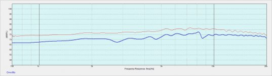

2nd- is FR ( no smoothing) of Dynaplane ribbon ( red trace) and a typical corrugated ribbon construction of same size/mass/corrugation ( blue trace). Both ribbons mounted in same magnet structure and use same transformer
This to show what I find typically in simple corrugated ribbons ( see the sharp wiggle at 8.5 khz ) and some other deviations from smooth lower in freq.
The sharp wiggle at 8.5 Khz is the mass / spring resonance I see in All other "foil only", and to a lesser extent the laminated plastic backed ribbons, that are wider than about 10-12 mm.
That wiggle will have a long ugly tail in a CSD plot and can easily be moved around (lower or higher in freq.) depending on the size/shape of the corrugations.
To my ears this always sounds like added brightness an is fatiguing.
Less wide corrugated ribbons ( below about 10mm) will push this resonance out farther where its less noticed BUT now you have a very small ribbon with its more limited low freq use.
And to be sure we see some manufactures moving to "Flat" foil diaphragms that dont have this trait. However in my experience there are other issues with Flat and getting a small one to goto 1Khz results in diaphragm failure as well as poor control of some other resonances.Much of the work I have done is to eliminate that wiggle and others , in a wider ribbon diaphragm. The red trace tells that story
In my 1st ribbon patent I describe a construction where the corrugations are set within a certain range of angles rather than straight across. This construction increases the ribbons spring rate along its length without increasing mass and results in an improved centering force. This allowing use to lower freq. AND also eliminates that HF wiggle. However continued investigation of those designs has led to the present design we are showing data from in this thred
That is crazy smooth, really. And the ripple seems to be because of a reflection somewhere, not a ribbon resonance -- notice how the ripples get faster at high frequencies,-- that, on a log-frequency plot, usually indicates a discrete reflection off some object or edge. The ripple peaks seem to be about 1kHz apart, suggesting something maybe about a foot away (maybe the mic stand?) rather than something to do with the ribbon.
Either way, a dB isn't much in the real world of speakers in a room.
your right, good call , there is a structure close by.
At some point need to get to a bigger room but this is my work area for crude test for now. Mostly 1/2 meter tests with short gate.

Still learning here and maybe not as big a deal as I think ?? , but I'm concerned with how the curves don't fall away between the 3 and 10 k region as much as it seems they should.
This is with a 15mm wide ribbon. WG profile at the throat? Narrow driver dispersion ignoring WG influence?
