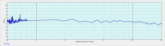

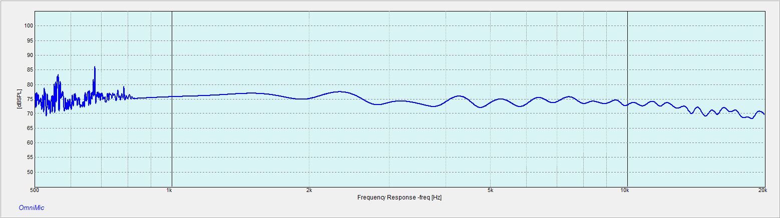

Yea the smoothing was attempt to easily see the gross FR changes without the wigglys . The ribbon as a direct radiator is quite smooth however, about +-1.5 db all the way out with a very clean impulse.
So question, I see from WG graphs I posted that the entire FR does not evenly reduce off axis until about 45 degrees. it looks like the extreems are down a bit as we go off axis BUT it isn't until about 40 degrees or more that the whole curve is down. I see this effect BTW with ALL my WGs reguardless of size shape. Im not sure but I thought the intent is to have entire curve down somewhat evenly at each off axis point?
More data...
1st graph is ribbon freq response with trap, NO wave guide, and NO smoothing
2nd is a close mic ( approx 1/2 inch) CSD direct drive , no trap, no Wave guide
3rd is impulse close mic, no wave guide
4th is impulse, at 1/2 meter, No wave guide

1st: Gate on first measurement should be changed becouse it created ripple on frequency response, which type of gate and window limit (Hz, microseconds?) exactly did you use?
2st: Could you make the same measurement of random well-known dome tweeter? This CSD looks too good to be true. 🙂
3rd, 4rd is just like in point 2nd...
Wind..
1st I think it was 5 ms and was taken at about 1/2 meter. Can do again for sure . What settings would you like to see??
2nd I know what your saying on the "too good". BUT I assure you I spent many years refining that ribbon construction to get that smooth.My reference has been ultra low mass flat ribbon diaphragms similar to RAAL. I worked until my higher mass ribbon had a similar signature.

I am sorry, I have no spotted 1 dB magnitude grid scale... Looks more or less correctly if so.
That is crazy smooth, really. And the ripple seems to be because of a reflection somewhere, not a ribbon resonance -- notice how the ripples get faster at high frequencies,-- that, on a log-frequency plot, usually indicates a discrete reflection off some object or edge. The ripple peaks seem to be about 1kHz apart, suggesting something maybe about a foot away (maybe the mic stand?) rather than something to do with the ribbon.
713695d1541424889-ribbons-wave-guides-15mm-rib-fr-trap-jpg
Either way, a dB isn't much in the real world of speakers in a room.
your right, good call , there is a structure close by.
At some point need to get to a bigger room but this is my work area for crude test for now. Mostly 1/2 meter tests with short gate.
