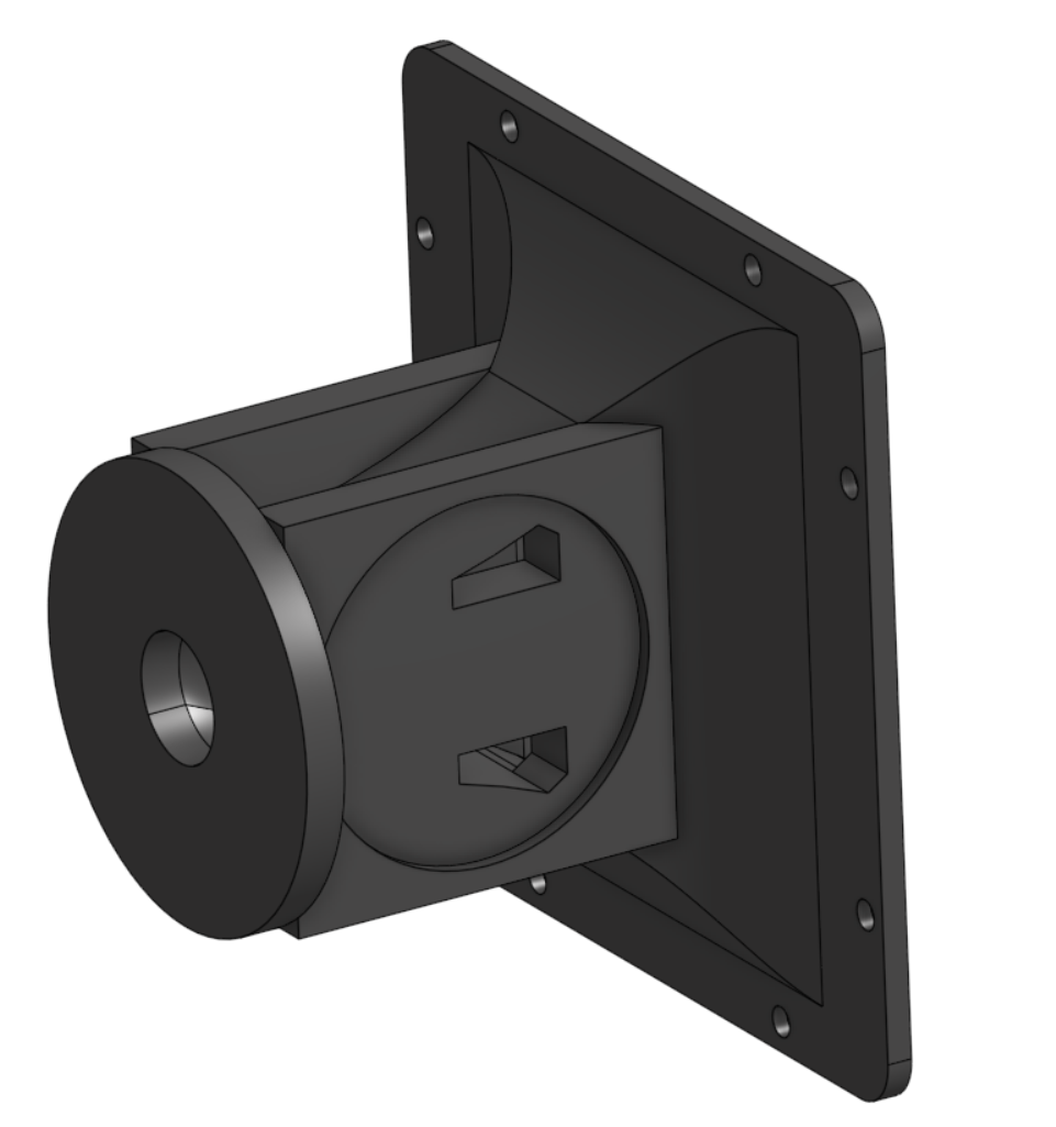

Ribbon Unity Horn
Here's the STL print for this waveguide
There's some plastic on the bottom of the waveguide that must be cut off with a scissors when it's finished. The plastic is there to keep the print from coming off the print bed
You'll need two prints to make one waveguide. Just flip one upside down and then epoxy the two of them together.
I took a much different approach with this waveguide, than with most of my waveguides. This waveguide is designed to be printed with 100% infill. A lot of my old waveguides had very thick walls, and sometimes I even printed them with zero infill. The reason that I went the opposite direction with this waveguide, is that I found that the hot Vegas sun was warping my waveguides, even when I printed them out of PETG.
If you want to go the extra mile, you can bake the print in salt, which is what I did:

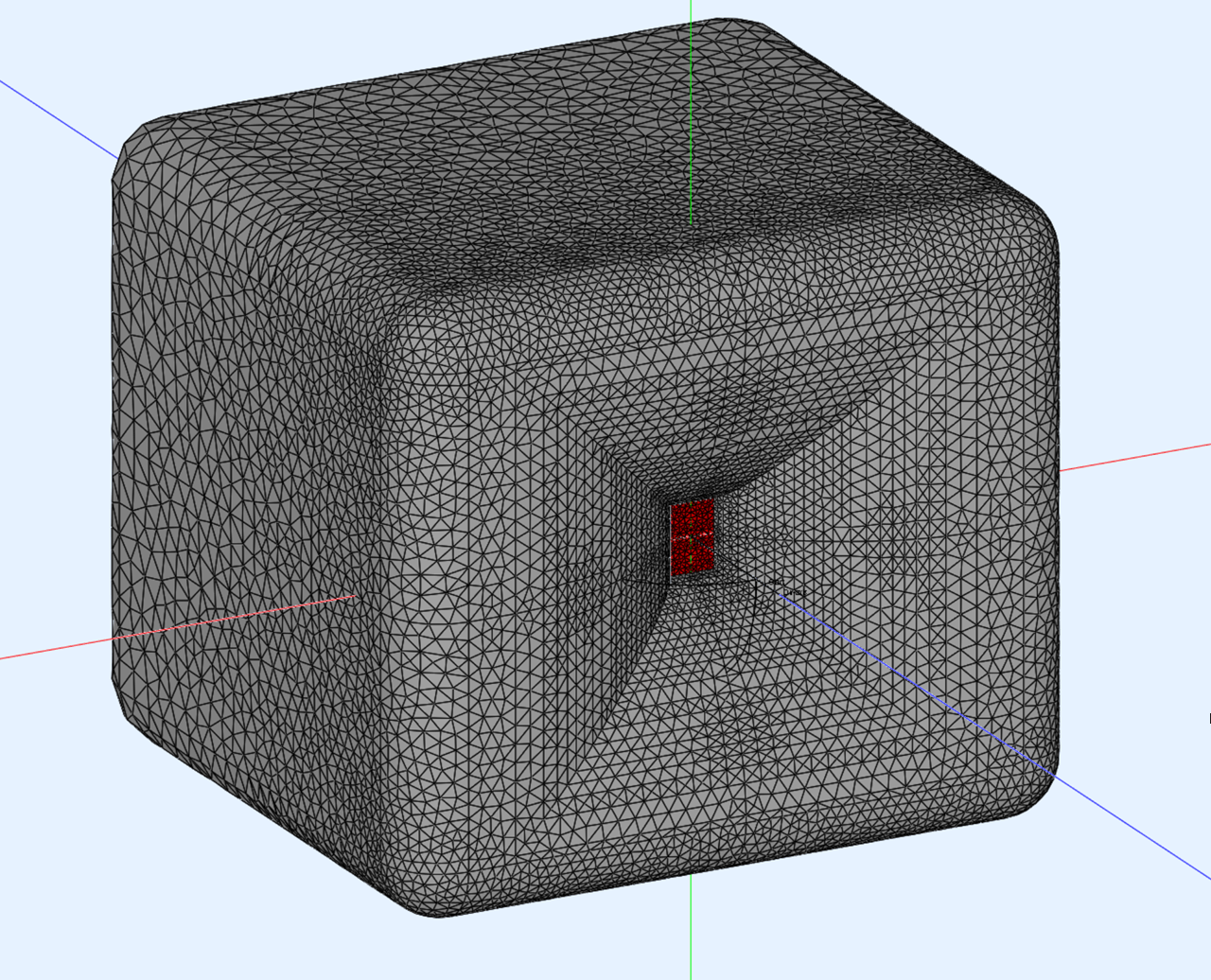

As of last year, Mabat's brilliant "ATH" software can simulate ribbons.
So I want to see how a BG NEO3 behaves on a waveguide.
Attached are pics.
Here's the details on the waveguide:

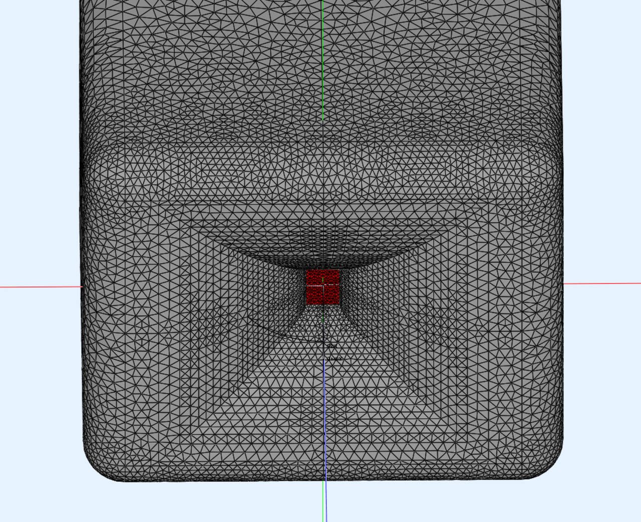

Device width x height = 302.52 x 300.36 mm (11.910 x 11.825")
Mouth aspect ratio = 1.007 (0.993)
Device length = 70.00 mm (2.756")

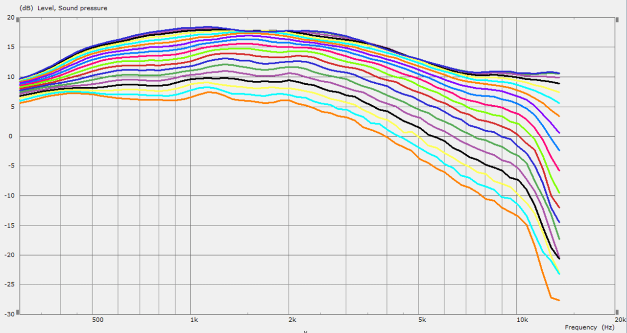

Here's the measured polar response of the KEF R3, courtesy of erinsaudiocorner
Here's the predicted polar response of my waveguide from the last post. I intentionally used the KEF as a "goal" largely because it's well regarded. My waveguide goes about an octave lower because my enclosure and waveguide combo is nearly twice as wide as the KEF. Beamwidth is about the same: about 120 degrees.

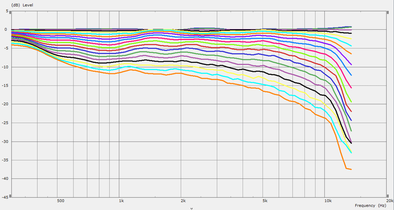

Attached is the normalized and unnormalized horizontal response of the waveguide from post 83
I think it looks pretty good. It doesn't have a crazy amount of gain, because the waveguide angle is wide (120 degrees) and the throat is relatively large. But there's still a solid six decibels of gain on axis, from 300Hz to 7khz. That should improve the dynamics and power handling of the NEO 3, which is already quite dynamic due to it's 90dB sensitivity.
Next thing I want to check out, is what happens if I make the baffle very tall, similar to the KEF Blade
  • 2023-07-01 15_26_06-VacsViewer - (new) - [Converted from PM_SPL_Horizontal_Normalized].png

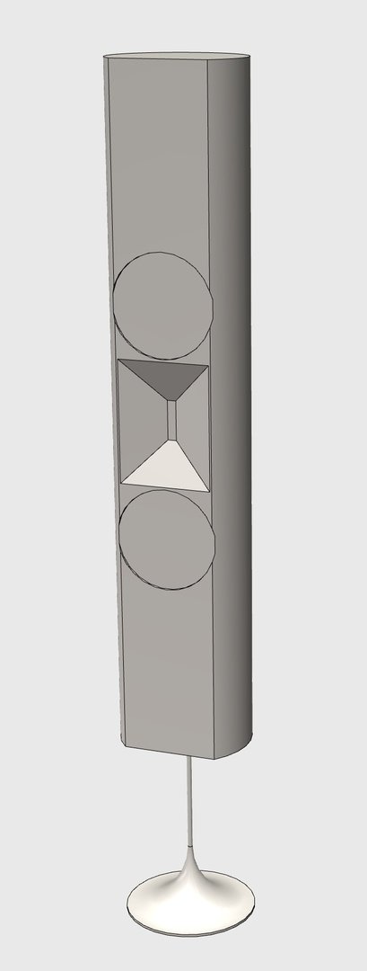

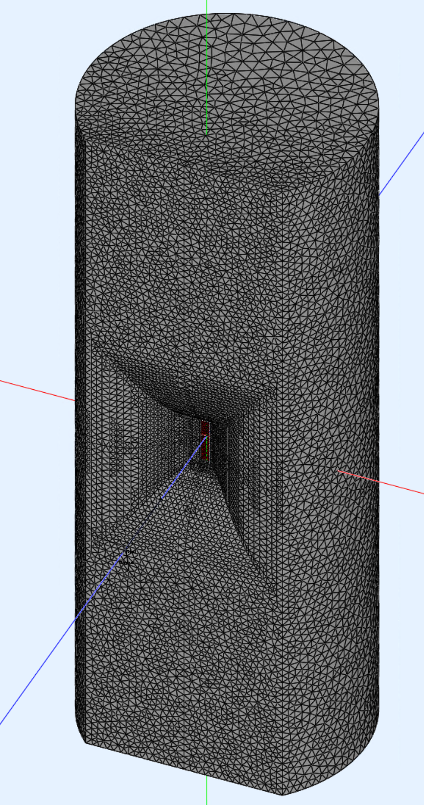

Most of the speakers in this thread weren't simulated in ABEC or anything like that. This is because I'm not aware of a way to make a waveguide with a curved baffle.
But I managed to figure out how to make a cylindrical enclosure with a flat baffle.
The results are quite good, if I do say so myself. See attached reports, and the model is below.

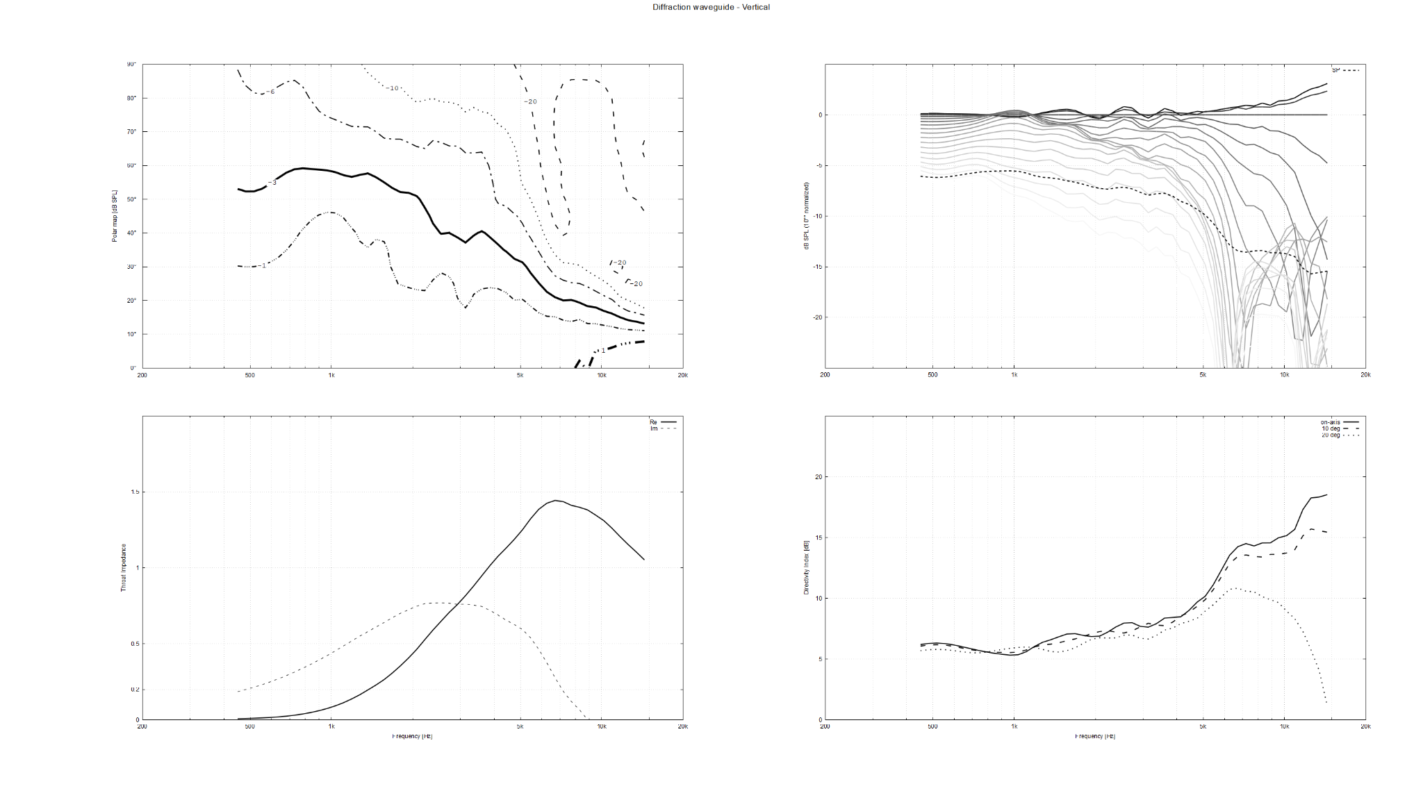

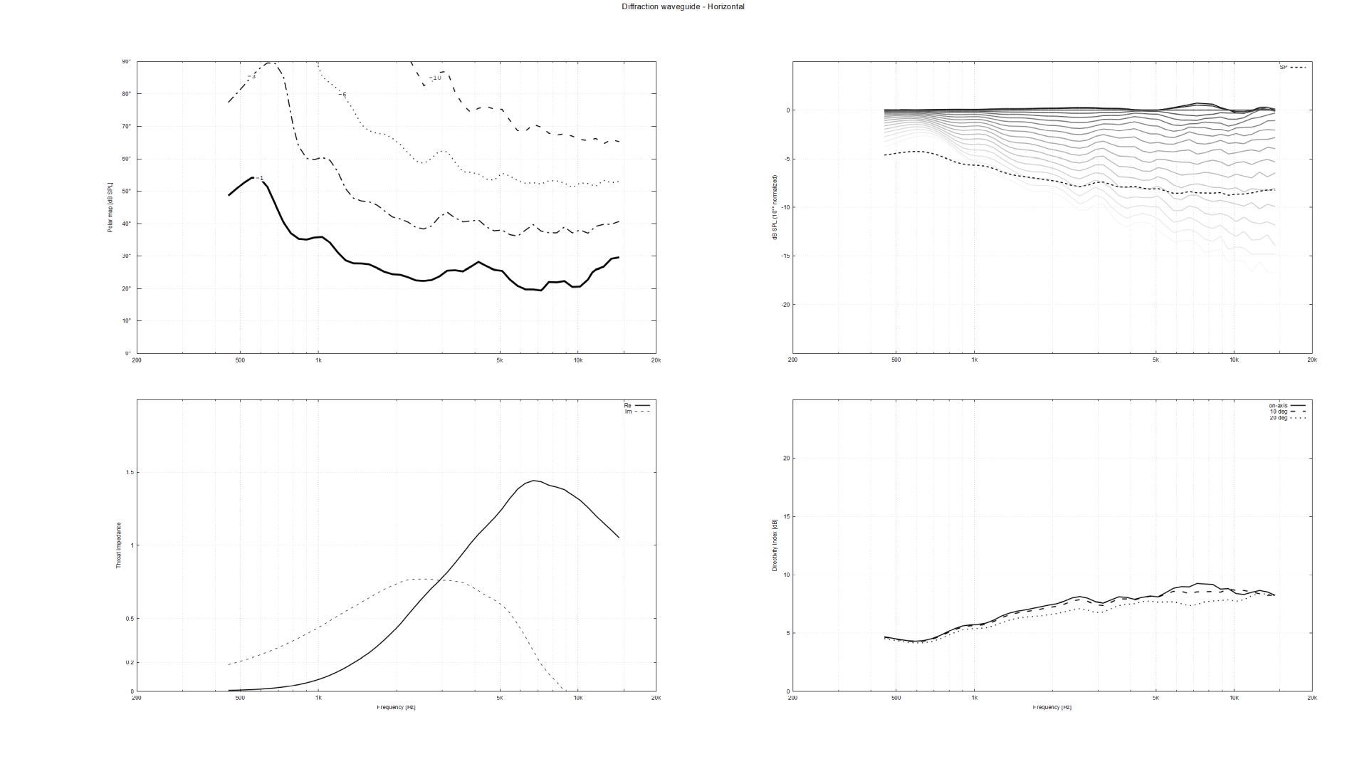

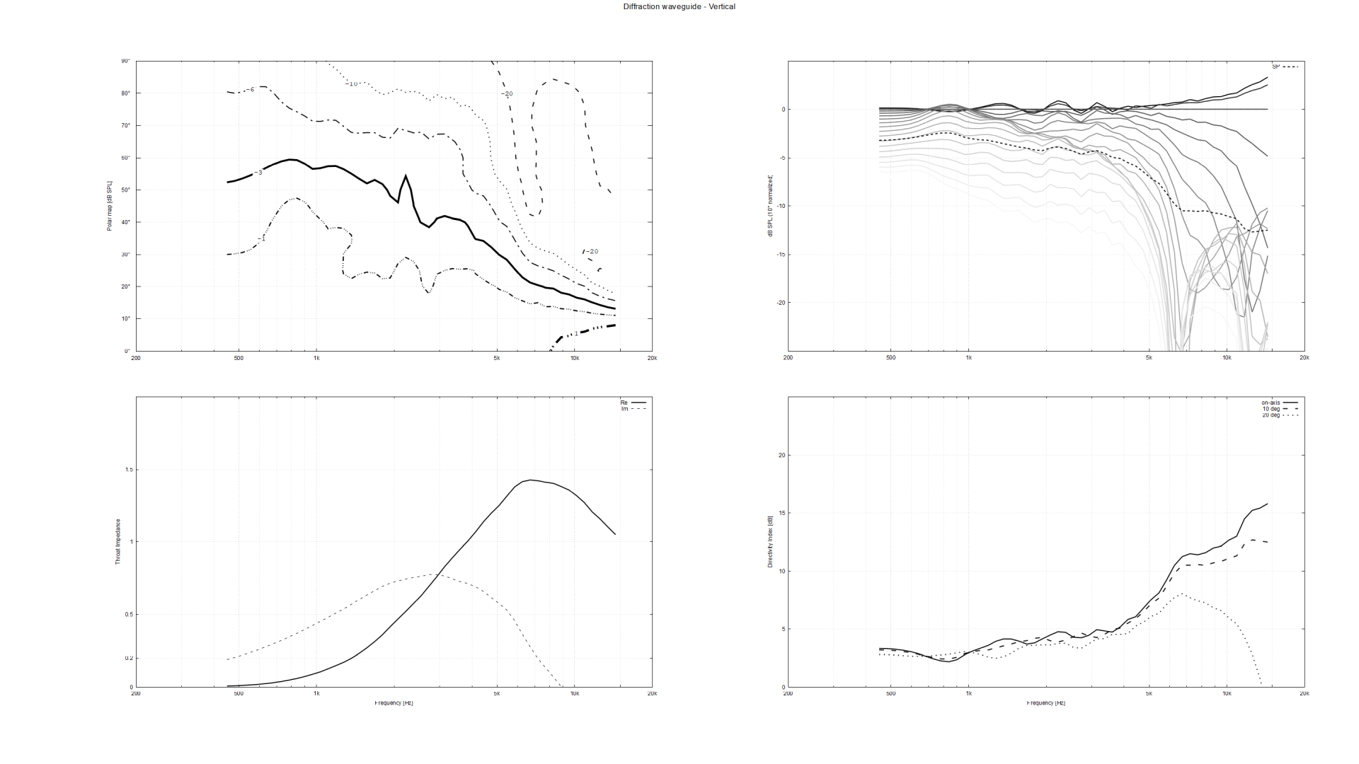

Report = {
PolarData = "SPL_V"
Title = "Diffraction waveguide - Vertical"
Width = 2880
Height = 1620
;MaxAngle = 0
NormAngle = 10

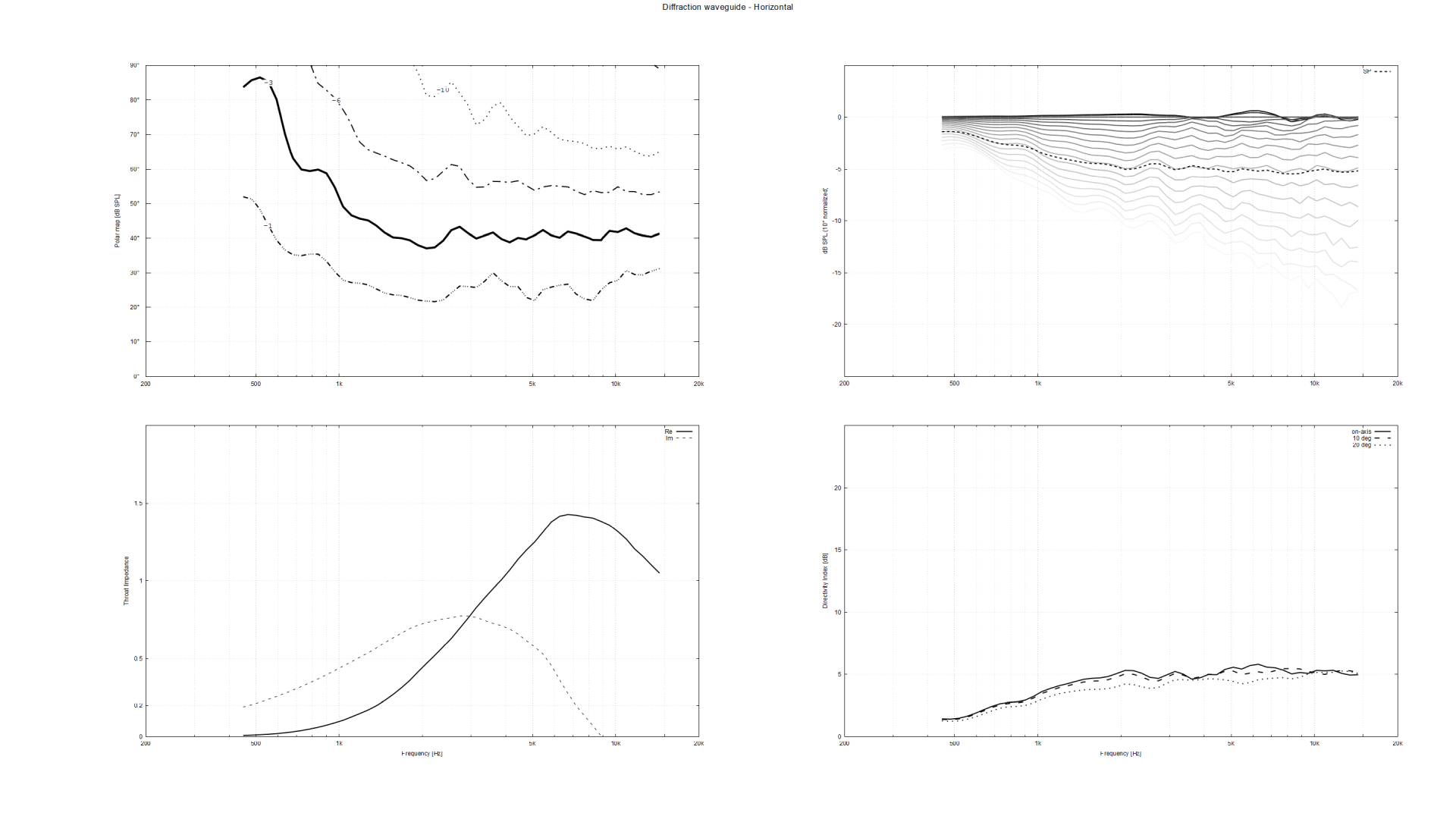

Here's a version of the waveguide from post #91, but this one is 254mm wide, instead of 304.8mm wide (10" vs 12")

Here's both sims of the horizontal response of the 254mm waveguide and enclosure versus the 304.8mm versions. You can use the cursor keys to quickly do an A/B comparison of the two.
Here's both sims of the vertical response of the 254mm waveguide and enclosure versus the 304.8mm versions. You can use the cursor keys to quickly do an A/B comparison of the two.

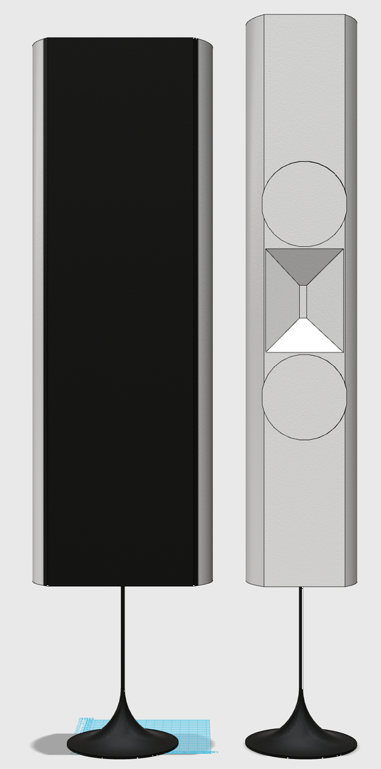

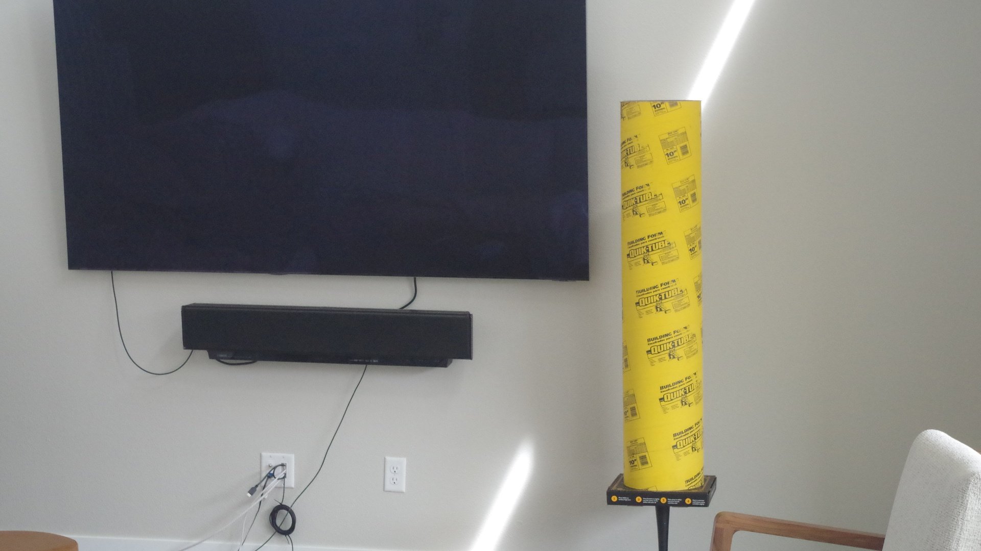

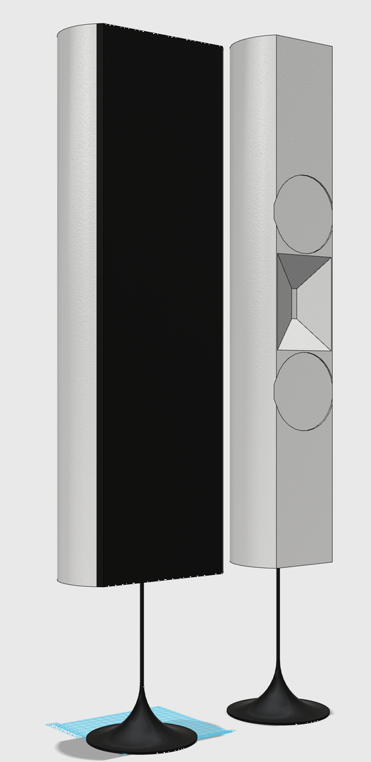

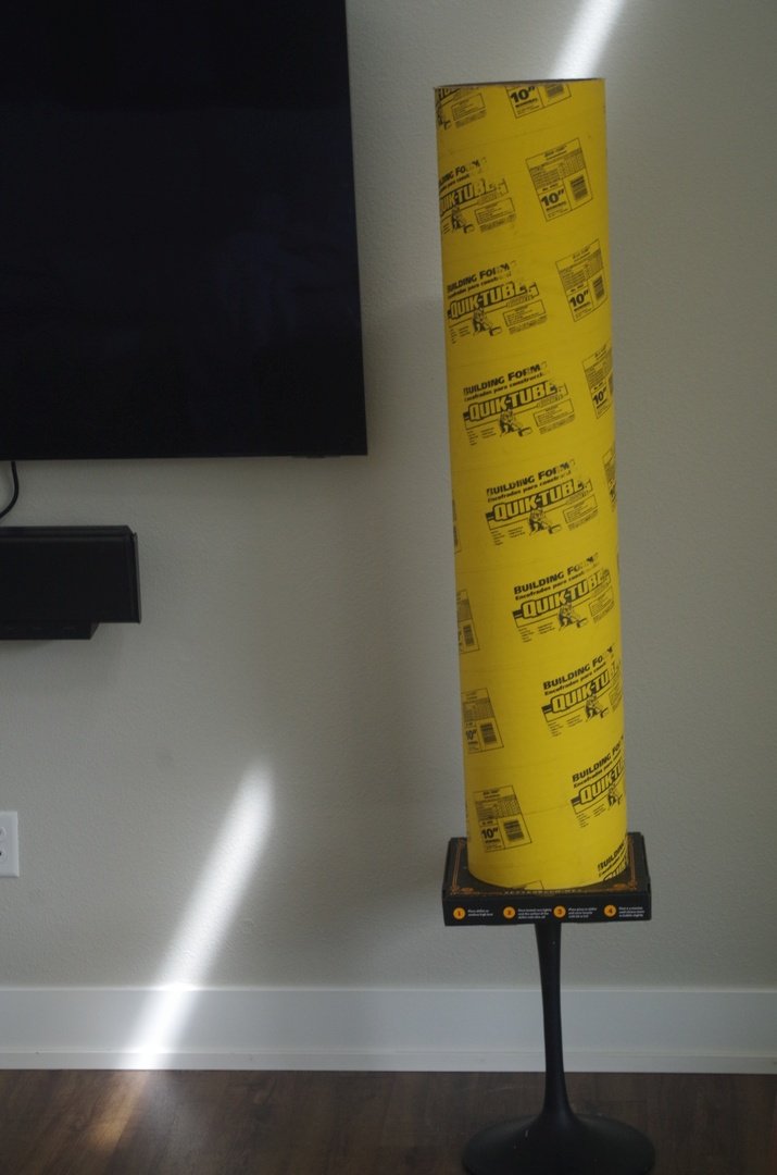

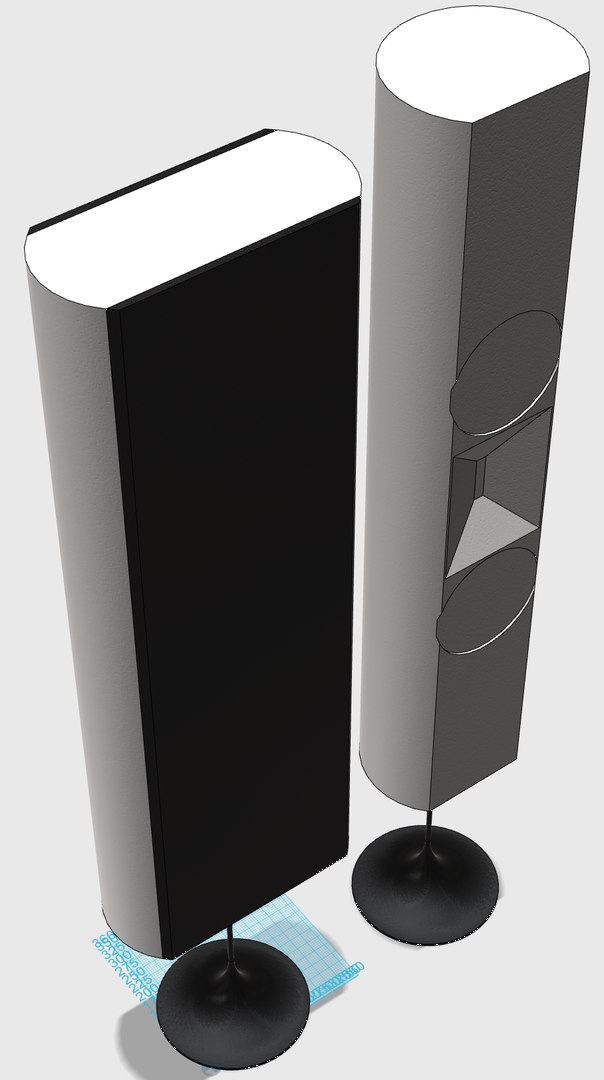

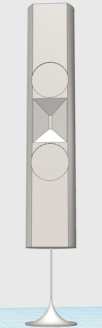

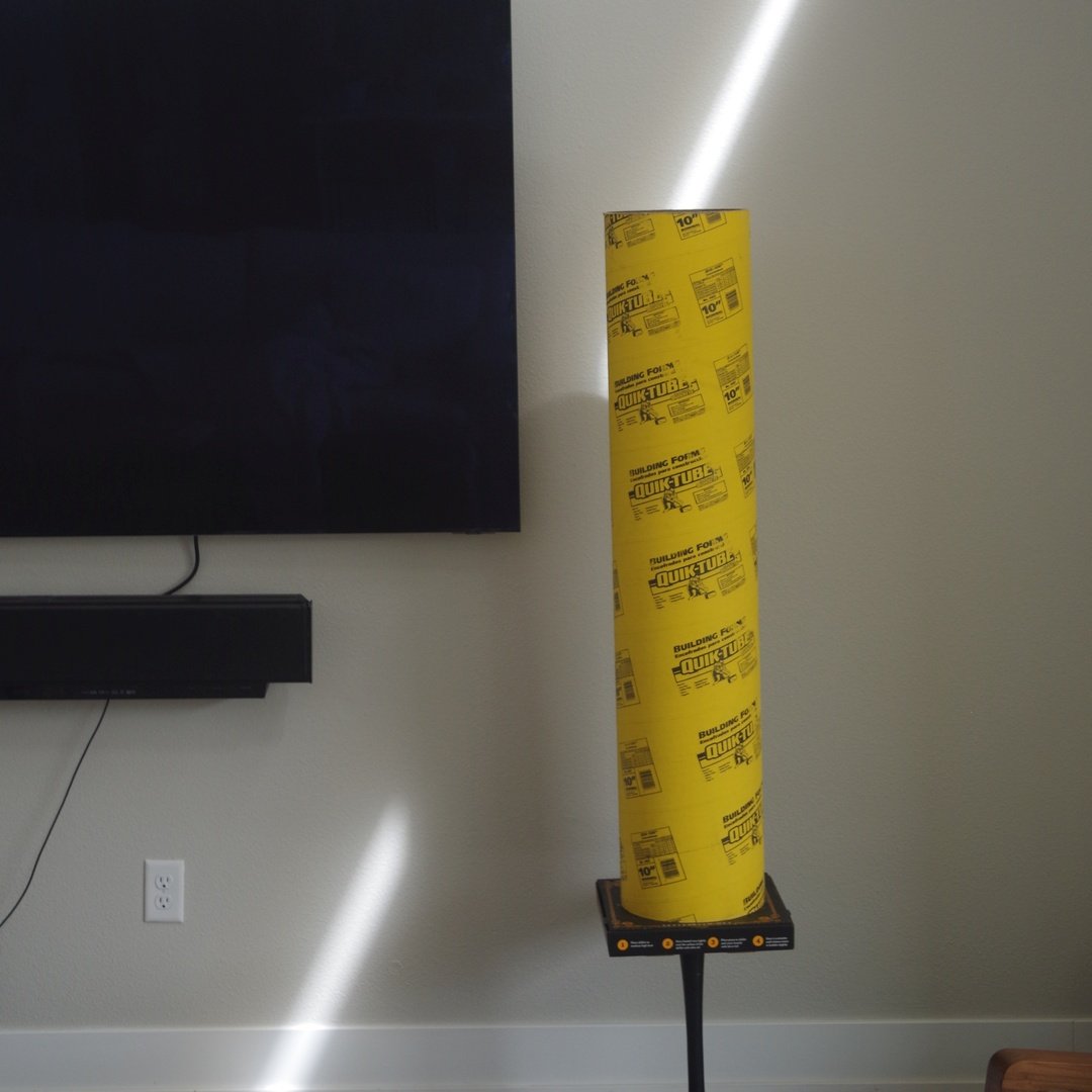

As shown here, the proposed enclosure is basically a sonotube with one flat face. Ideally it would be round all the way around, but I don't think that ATH can sim that.
I'm not sure what to think of the looks of this speaker.
I was hoping for something that looked like a Kef blade, but I don't think I succeeded.
The stand for the speaker is a Bose 901 "tulip" stand, I bought a pair off of eBay.
The attached pictures show my living room along with a sonotube, to give you an idea of what it might look like. The rest of the images are simulations of course.

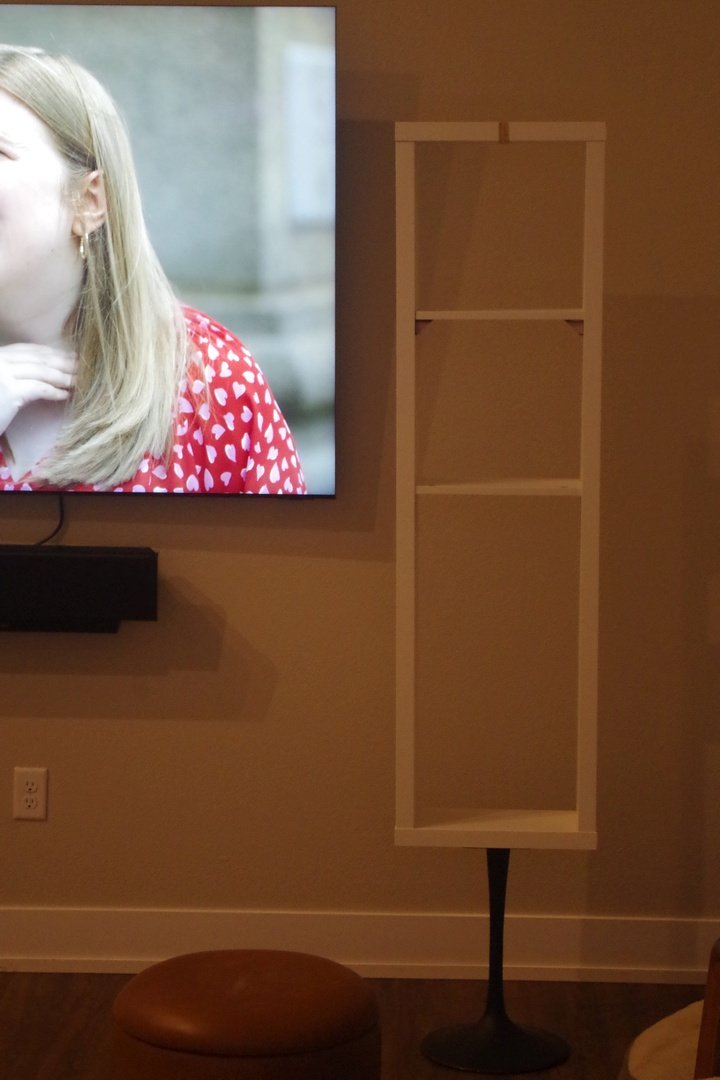

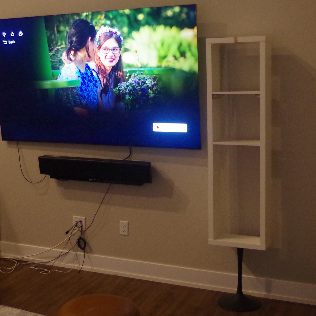

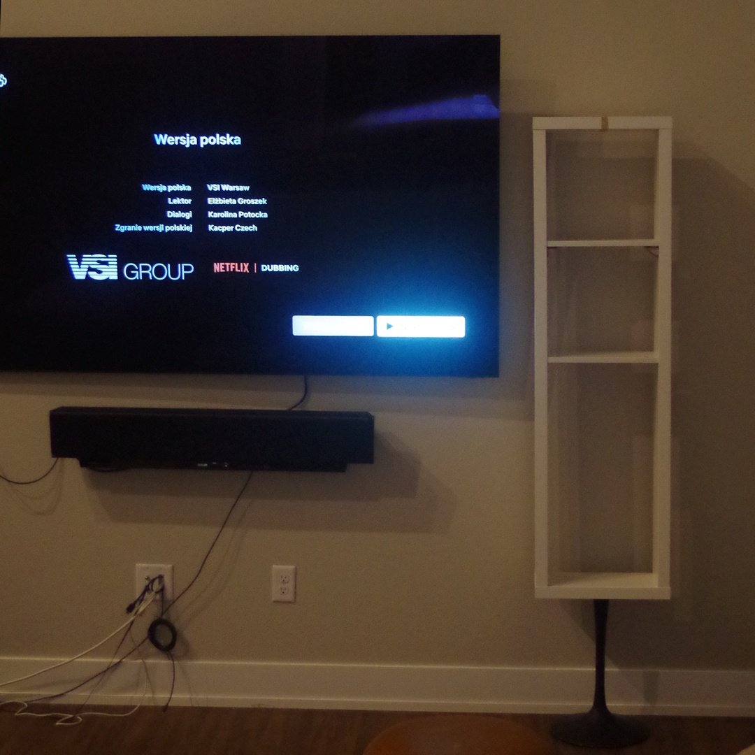

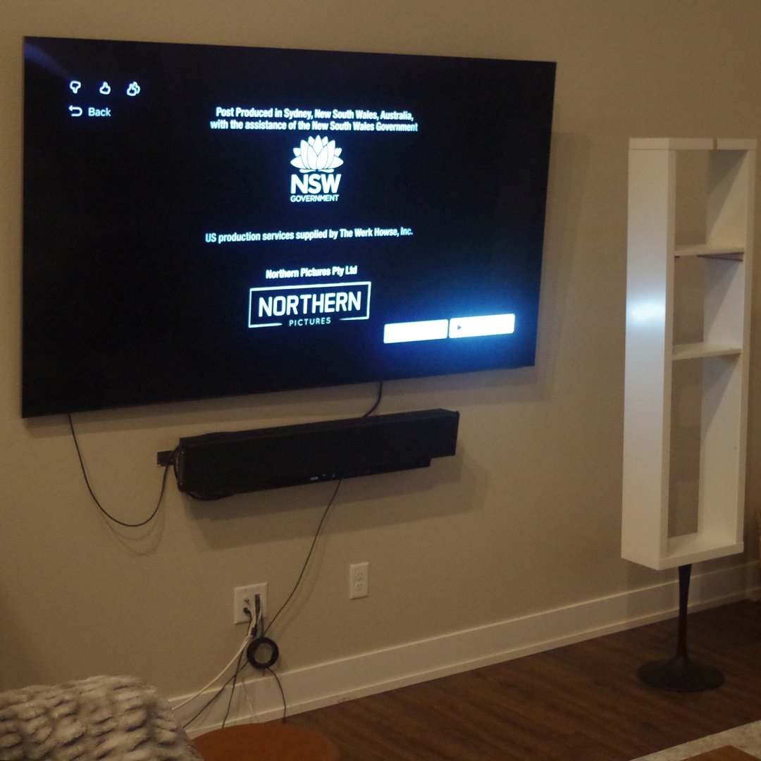

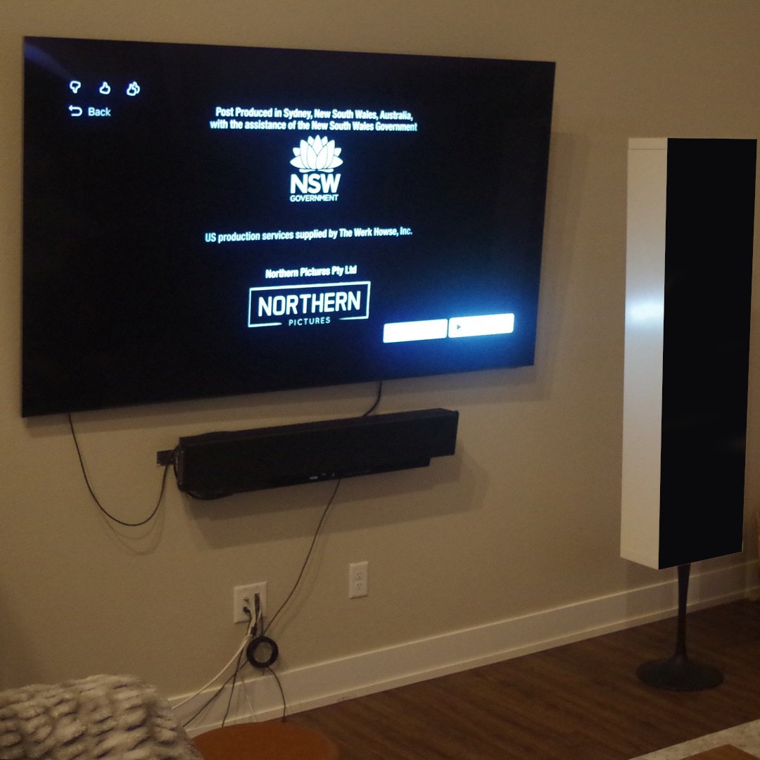

I made an enclosure out of an Ikea 4x1 Kallax shelf that I cut in half. This enclosure was the original plan.
I figured the cylinder would look better, but looking at both of them in my living room, I think the Kallax enclosure looks better, especially if I make it two-tone. I'm picturing something like this:
