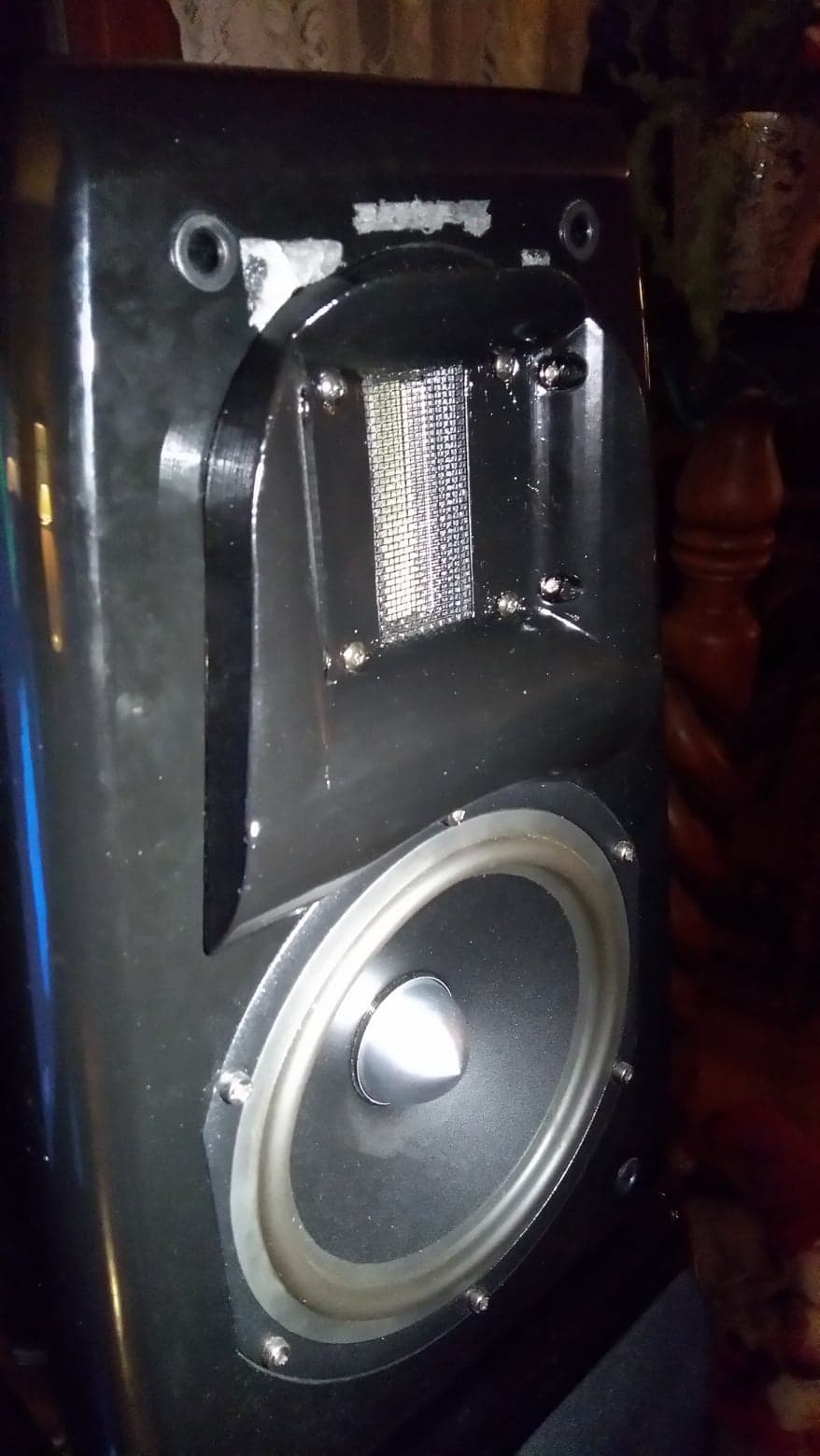

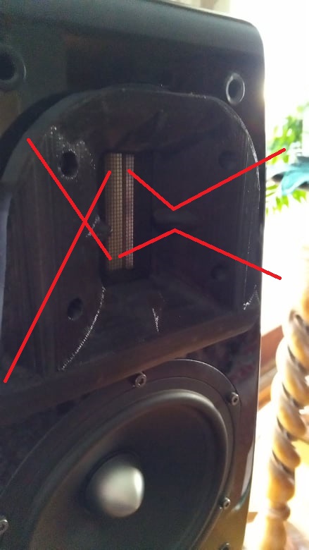

I need a spl boost from 4kHz and lower down by some 3-5 db. 5kHz has a wavelength of 6.86 cm, so I tried to make the waveguide boost waves longer than 6.86cm by having the flanges start at this distance. Do you think this waveguide will perform as expected?
If very odd polar and frequency response from your parabolic ribbon horn is expected, it's performance will be on target 😉Do you think this waveguide will perform as expected?
The guide will fit perfectly inside the frame of the speakers grill. The grill is slanted perfectly towards the rounded corners of the box. I hoped this will work to control diffraction sideways, my aim is to get a wider dispersion pattern in the 3kHz region. The original Xtz faceplate had sharp corners into the ribbon so I thought a softer roundover into the wide horn would be better. Therefore I ended up with that weird looking waveguide.
Finally got around to test the "non calculated" waveguide and it performs as hoped! It gives a good boost into sub 3.5k and all the way to about 10-12k. I dont have a calibrated mic so I can only guess on the frequencies. The Xtz 99.26 speakers have many treble adjustments on the back and I always run them at -2db treble. So the added external filter had some headroom for affecting the frequencies enough so I didn't have to make a new crossover. The adjustment and biamping terminals makes them easy to experiment with, and I made a quick dampening series resistor with something that resembles a high highpass filter at 10kHz. The speakers always were a bit laid back in the sound. Now its more forward sounding and exiting, but still with the smooth ribbon sound. It also plays a lot cleaner loud since less energy is going into the tweeter with the dampening filter. The sound also blends a lot better with the midrange, the sound lets go the speaker to a higher degree so I can place them further apart. I think a properly modelled and finetuned guide could make this a huge upgrade for speakers with the Fountek ribbon. It sort of removes the shortcomings of the tweeter. I'm still not finished with the filter but I've made a crude drawing to show how simple it is. Looking at the waveguide picture one would assume that it would play terrible cause of the abrubt sidewalls, but it fits perfectly inside the grill to make a smooth transition to the grill baffle.

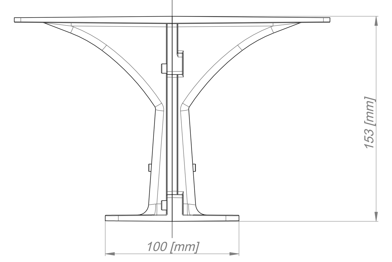

The 3D printed waveguide is designed to be glued to a sonotube that's 12" in diameter.
The hold in the sonotube measures 208mm in width by 281mm in height.
3D printed speakers are never 100% accurate, dimensionally, so I'd recommend making the hole smaller than needed, then enlarging it until everything fits.
Since the horizontal dimension is curved, the easiest way to draw it out is to use duct tape or painter's tape that's cut to 208mm in length, and use that as a template.

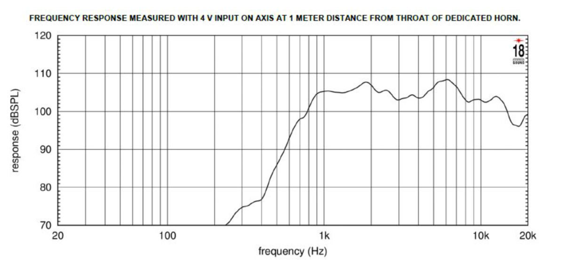

Here's a graph of 18Sound's AMT on their horn.
You can see that it plays almost two octaves lower than my waveguide does.
I think what's going on here, is that the 18Sound Waveguide is 'loading' the driver a lot more than my waveguide is. The 18Sound Waveguide is about twice as deep as mine, and the diffraction slot is likely increasing the on-axis efficiency significantly.
It might be wise for me to copy their approach, as I wasn't able to get the RT-5002 to play much lower than 2500Hz.

The graph on the horn datasheet looks different (better). Would be nice to know why they're different.
