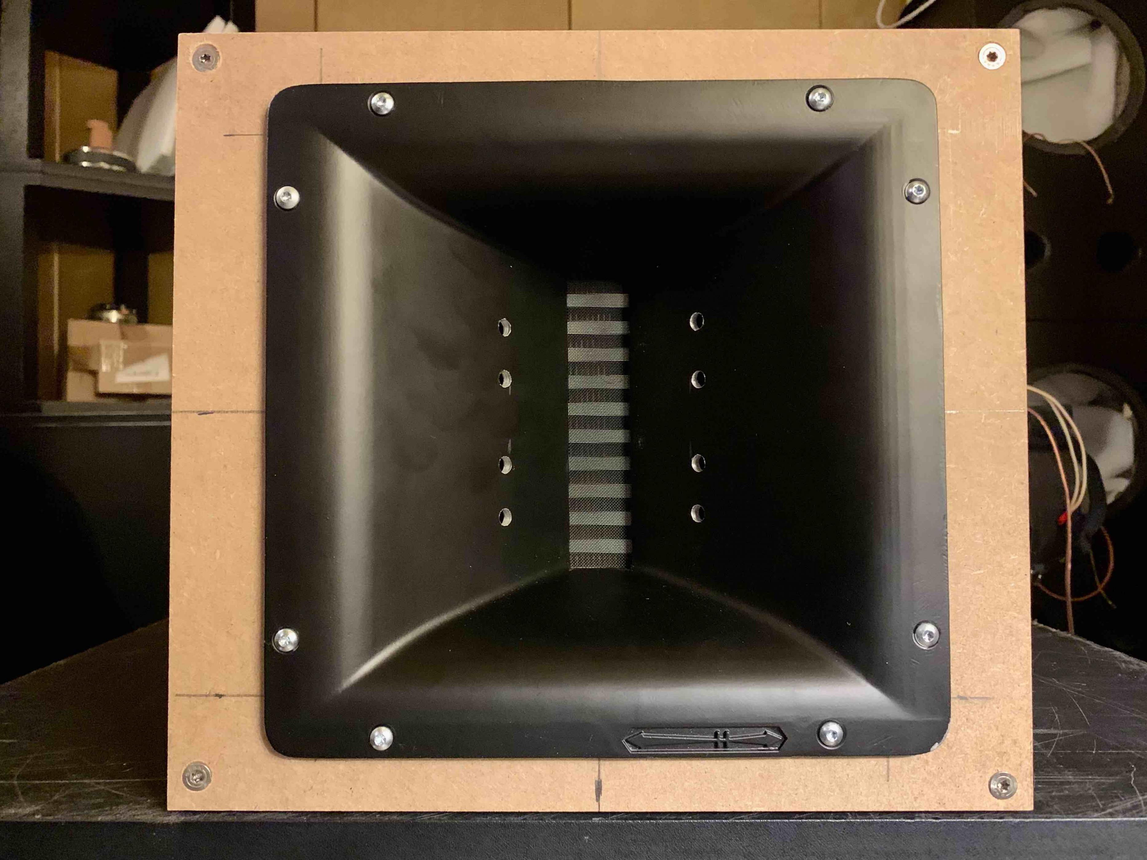

Although this thread has laid dormant for a while, I think it's the best place to post this. I finally came across a good deal on a pair of Beyma TPL-150 and figured I'd just drill some holes in the waveguide, maybe something useful would come out of it.

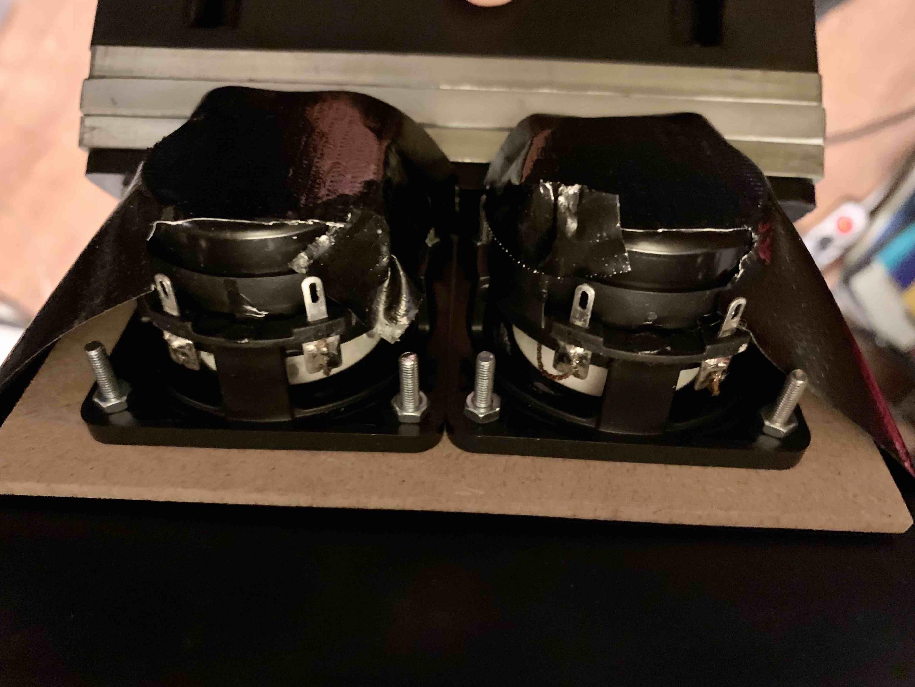

So I put four 2-inch Tangband drivers as close to the AMT as I could and drilled two 7mm holes for each driver. The location of the taps still leads to a circumferential distance of about 40cm, which equals to a wavelength of 860Hz, hardly ideal. 7mm was just a guess and I figured it would always be easier to make a hole bigger rather than the other way around. The drivers are mounted to 3mm MDF boards which have circles of rubber gasket around the holes and are tied to the waveguide with good old duct tape. The mids have no back chamber, the enclosure is about 20 liters, so basically infinite for these little guys.

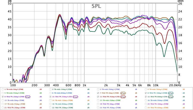

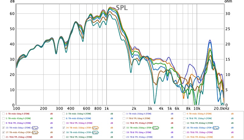

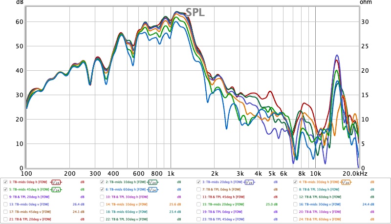

The measurement conditions were pretty bad, way too much stuff too close, a rack of clothes at the most relevant first reflection point though. The plots are FDW 1/20, the Mids and the AMT playing together was just on axis REW auto EQ and 24LR filters at 1400Hz.
For what it's worth, they sound really good. I had them on top of a Beyma 12p80 and it was really hard to tell a difference with the 12p80 playing up to 1200Hz vs 400Hz and the TB 2inchers filling in the mids up to 1400Hz when switched on the miniDSP (and eqd pretty much identical). I doubt I would be able to spot them in a blind test, but felt the TB mids sounded a little harsher but slightly more coherent perhaps. But then that's probably just my expectation (diffraction and point source benefits and drawbacks).
