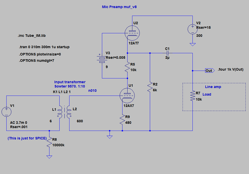

Given the lack of balance, I would call it a sort-of mu-follower. It achieves mu-follower type behaviour but using an SRPP-like circuit. The snag with adding a battery to bias the upper valve is that it adds stray capacitance to a high impedance node, so limiting HF.SY said:What you have there is sort-of an SRPP, not a mu follower.
0.33V bias for the lower valve guarantees grid current, but fortunately the source impedance is low enough that this won't matter. I mention this in case others try to copy this design for other purposes without realising this.
DF96 could you explain better what stray capacitance is added? Capacitance of battery is huge and resistance that shunts it is very low. So both can be basically ignored for the model.

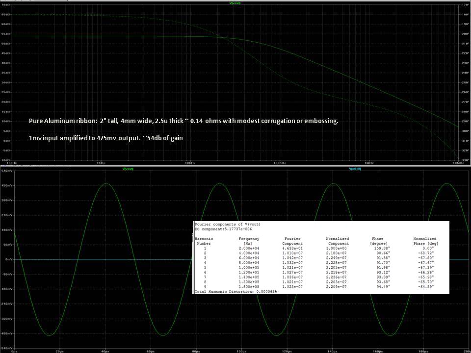

FR curve shows flat HF till 200kHz.

I've found that 6K give lowest THD. But yes, load must be 10K.
With lower load impedance THD increases.

The capacitance of the battery to everything else, not the capacitance between the battery terminals. Whatever is inside it, a battery is a lump of conductor and therefore has a capacitance. It is attached to an anode which has had its impedance raised by an unbypassed cathode resistor. Now it may be that the added capacitance does no harm, but a back of envelope calculation could confirm this.mm7 said:DF96 could you explain better what stray capacitance is added? Capacitance of battery is huge and resistance that shunts it is very low.
Calculate the anode impedance. Estimate the battery capacitance - the capacitance of a sphere with the same surface area will be near enough for a first estimate. Calculate the resulting HF rolloff. If the battery is in a chassis clip then its capacitance will be raised.

Hi DF96,...Calculate the anode impedance. Estimate the battery capacitance - the capacitance of a sphere with the same surface area will be near enough for a first estimate. Calculate the resulting HF rolloff. If the battery is in a chassis clip then its capacitance will be raised.
I see what do you mean. A capacitance between battery and something else, most probable chassis. Or tube electrodes. Right?
Tubes will stick out of chassis. so may be ignored. And capacitance "battery-chassis" will depend on area of projection the battery on chassis. If we turn battery so it faces chassis by one end (area is approximately 1x0.5 "), and it will be distanced from it at 1 - 1.5 inch, what a capacitance will be created?
Calculation gives 0.1 - 0.08 pF accordingly.
I've put this cap between battery and ground. It has no impact from what I can see on AC Analysis graph. Am I correct?

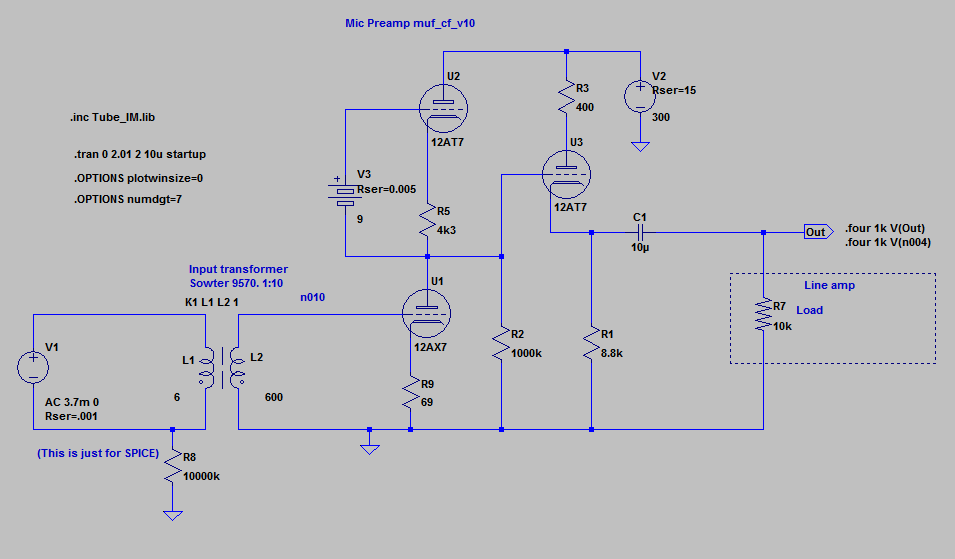

Here are 3 schematics of preamp:
1 - one stage mu-follower
2 - mu-follower + cathode follower
3 - mu-follower + White cathode follower
All have same frequency response ~ 10 - 20kHz, similar THD
and similar output voltage swing
Which schematic is better and why?

First you need to define 'better'.mm7 said:Which schematic is better and why?
Lower distortion? Lower power consumption? Lower output impedance? Better drive capability? Fewer valves/more valves?

Hi DF96,
I mean which is better to amplify a ribbon mic to line level with best sound quality, minimum distortions and noises.
Because I do not have much of expertise it is hard for me to formulate proper requirements. I'll try.
I'd rank requirements this way:
1. overall better sound (I realize that it is subjective, but still, just what do you think)
2. lower output impedance. (my load is 3.3K impedance)
3. better drive capability. (I've calculated for 10KOhm DC load, but sound quality should not degrade too much if preamp is loaded by another load.
If required I can add switchable resistors for balancing to other loads)
4. higher stability
5. lower sensitivity to RF
6. lower sensitivity to PSU noises
... whatever other things you would think are important, place them to whatever rank.

Lets turn my question another way - What are main issues are decided by these circuits?
The circuit partly sets the gain, noise and distortion and, apart from the transformer, sets the frequency response. Construction details affect hum/buzz and RF immunity. The key component is the input transformer; other components are less important although valve quality also affects noise.

but that only addresses the output buffering issues.
the input side is where its more critical as for your application. as its a tall call for one tube to get 40-60 db of gain from a 15-40ohm impedance source.
now take the third circuit double it, and on the input tale the transformer secondary one lead per grid. then stabilize the quintessential current by tying 470k resistors from grids to ground.
+24 to +32 dbu @ 200 ohms should be your target output.
then use balanced "o" type attenuation on the output to 3.2V p-p.
