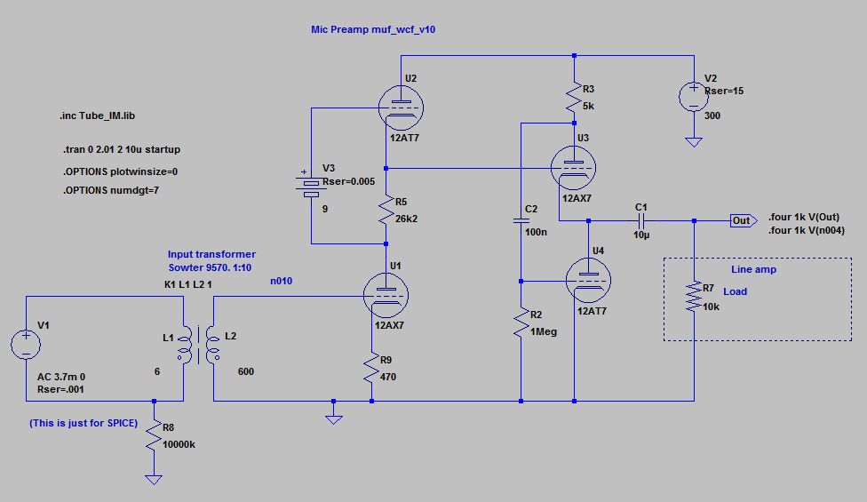

![351856d1370023094t-ribbon-microphone-preamp-muf_wcf_v10.png](https://www.diyaudio.com/forums/attachments/tubes-valves/351856d1370023094t-ribbon-microphone-preamp-muf_wcf_v10.png)
what kind of PSU will be good here? Regulated I guess?
Does it need regulated DC heater supply?
How to elevate heaters of upper tubes?
My concern here, because upper tubes are in same envelopes with the lower ones, if I elevate upper heater to 150VDC, so it is 50VDC above its cathode, the lower tube heater will be elevated 148VDC above cathode, isn't it too much?

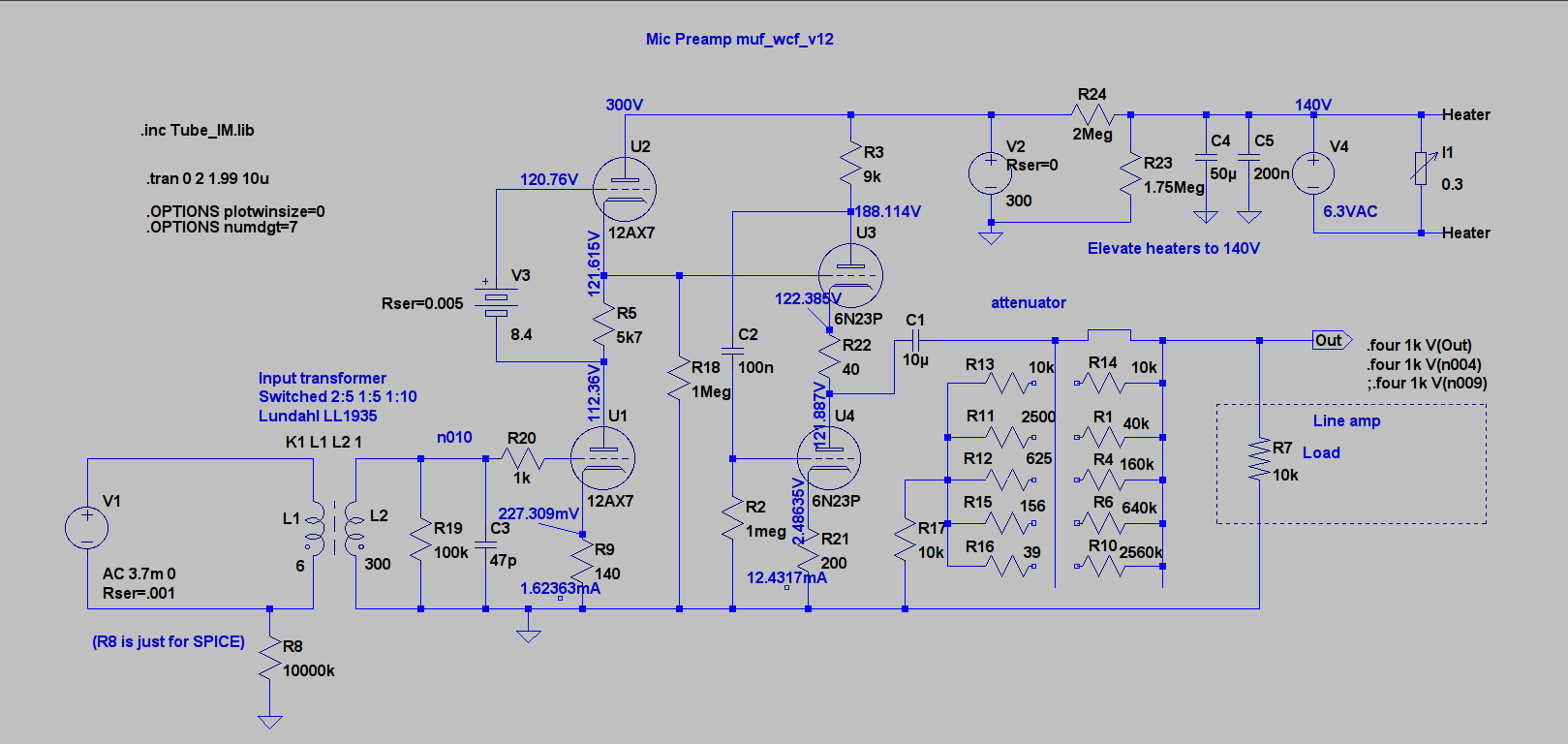

I've modified the schematic a little bit.
MuF is based on 12AX7, WCF is 6N23P just in case if load R will be less than 10K. Is it overkill?
Also I've added:
1. output attenuator. 6 position multiswitch with resistors that deviding Vout and keep WCF load always 10K. My concern it will require 2-3W resistors. Would it be better to move it between stages?
2. input RC network that should suppress RF.
3. heater elevator with big and small caps to suppress hum and RF.
I'll appreciate any comment.
There are some voltages and amperages in points that I suggested important. Could you take a look with your experienced eye?

Thanks Chris. Bias of U1 is 227mV, U2 is 900mV. THD of first stage is already 0.0009%. It is achieved by tweaking cathode resistors of both tubes. I realize that this very low THD figure is something idealistic and is existing only in the model. Real thing will produce, I hope, something like 0.0*%. But I'll try to eliminate lower Rc.I would worry about linearity operating the first stage so near zero bias with significant source impedance. And AC on the heaters isn't worth the trouble; you'll need all the quiet you can get.
I do not understand what is "significant source impedance". Could you please elaborate?
Impedance of source is quite low, it is a ribbon mic (with 1:37 transformer) that produces ~200 Z. Then it is multiplied by the input transf K1 by 1, 2.5, 5 and 10. So in last case it can reach 20000 Z. I believe it is low enough comparing with 100K resistor R19.
Do you mean I should increase this R19?
I have been reading for 2 days about AC with DC heaters. Most people says that well elevated AC is sufficient for virtually "no hum" solutions. Also there are some negative comments related to DC heating if it is not ideally smooth and has some ripples that are doubled in frequency (120Hz) thus more hear able.
I decided to try with AC heating first and test heating with a big battery if it will really decrease noise. But it may be a good idea to buy PSU that includes low voltage regulator like Glass-Ware PS-1, just in case?

The impedance you need to worry about is not R19 but the grid input impedance of the valve. This is because you are running well inside the grid current regime. Unlike R19 this impedance is nonlinear. It is conceivable that your low distortion achieved in simulation partly arises from cancellation of 2nd arising from two sources: normal valve curvature, and grid current distortion (these pull in opposite directions, but have quite different shapes). If so, you will see a rapid rise in higher orders as soon as you raise the signal level.mm7 said:I do not understand what is "significant source impedance". Could you please elaborate?
