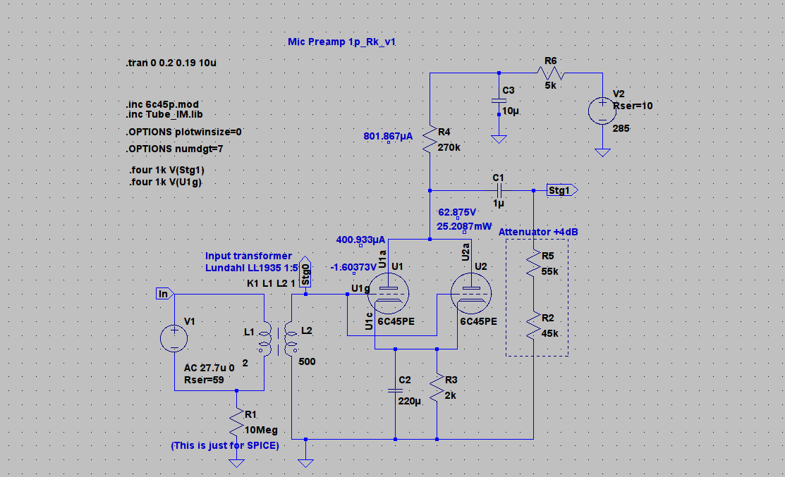

Here is another variant, where in accordance with Merlin Blencowe conclusion "For minimum noise the input stage should be passively loaded."
I've made input stage passively loaded. As well as paralleled for higher Gm.
Here are schematics of the input stage.
One is traditional with bypassed Rk.
Another is with battery bias.
Noise and transient simulation is identical for both.
Which one do you like more?

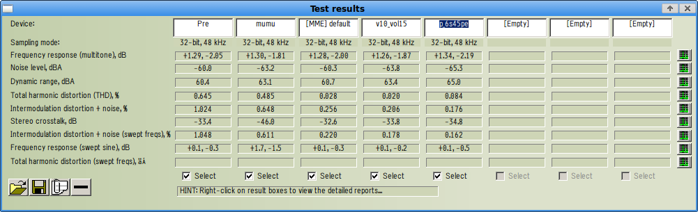

Modified existing preamp first stage. Instead of mu-follower I've made parallel SET. A little bit less noise.
It is in RMAA "p_6s45p" column.
A little bit more HF roll-off. A little bit more distortion, 2-nd harmonic.
previous column "v10_vol15" is previous mu-follower 1-st stage.

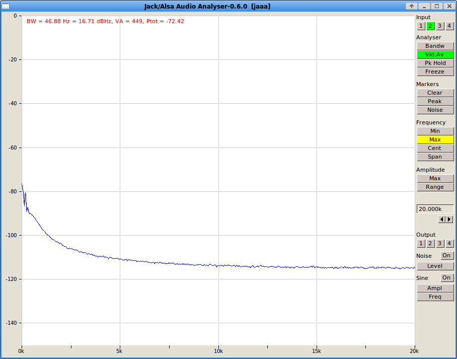

Second pic is how "no-input", open XLR signal looks like. Same is with 150R in input.
