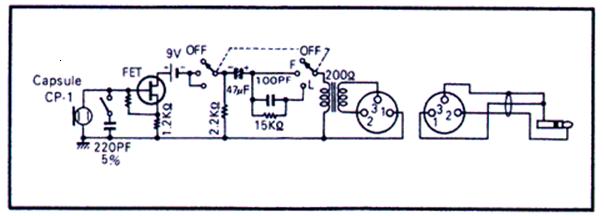

I agree the impedance vs frequency is chemistry dependent but most of the extracted models use only linear R's and C's hence no distortion per se. Nakamichi used this battery self bias scheme with great success, it's interesting to note it used a mercury battery and now folks have to hunt down a fairly obscure alkaline eqivalent. Never thought of trying to measure the distortion. In any case I would expect it to be a small fraction of the base ESR, 2.9 Ohms for a 9V alkaline at 1kHz.

I agree the impedance vs frequency is chemistry dependent but most of the extracted models use only linear R's and C's hence no distortion per se. Nakamichi used this battery self bias scheme with great success, it's interesting to note it used a mercury battery and now folks have to hunt down a fairly obscure alkaline equivalent. Never thought of trying to measure the distortion. In any case I would expect it to be a small fraction of the base ESR, 2.9 Ohms for a 9V alkaline at 1kHz.
So, your logical attack on what I said is that if it's good enough for Nakamichi, it's good enough for us? Your "appeal to authority" argument is a well known fallacy.
I didn't say anything about measuring distortion of a battery. I said: the impedance of a battery is nonlinear with frequency. It is a well known phenomena in the Electrochemical Impedance Spectroscopy field.
It's all very well stating a fact, but it's of no use to anyone unless you make some attempt to quantify it. Heck, everything varies with frequency if you get down to small enough numbers. And if it's so 'well known', then it should be easy to put some numbers on it.
In this example, a PP3 varies its impedance by less than 30 ohms in the audio band. Other batteries even less. That's negligible compared with the total loading on the transformer.
