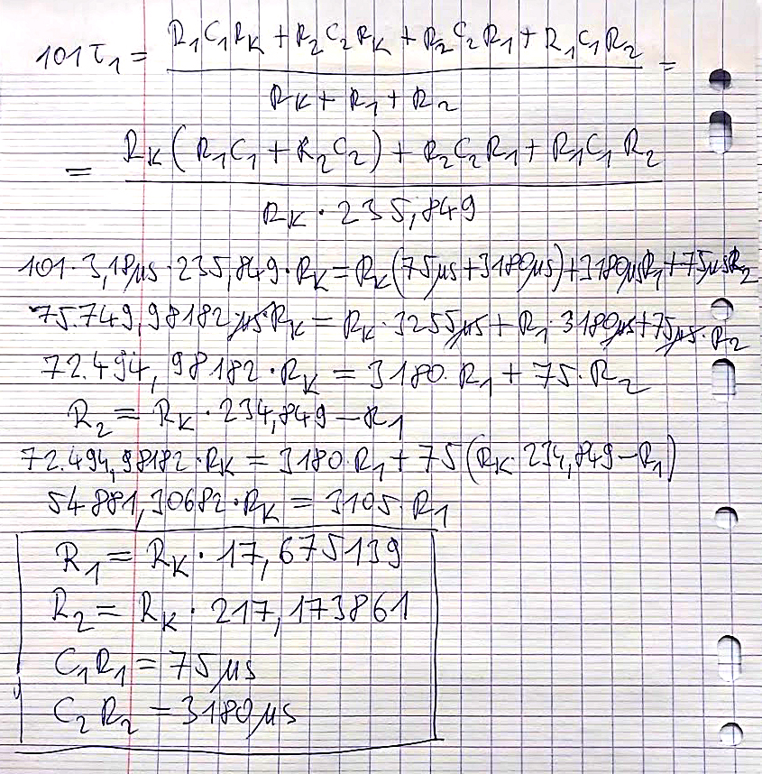

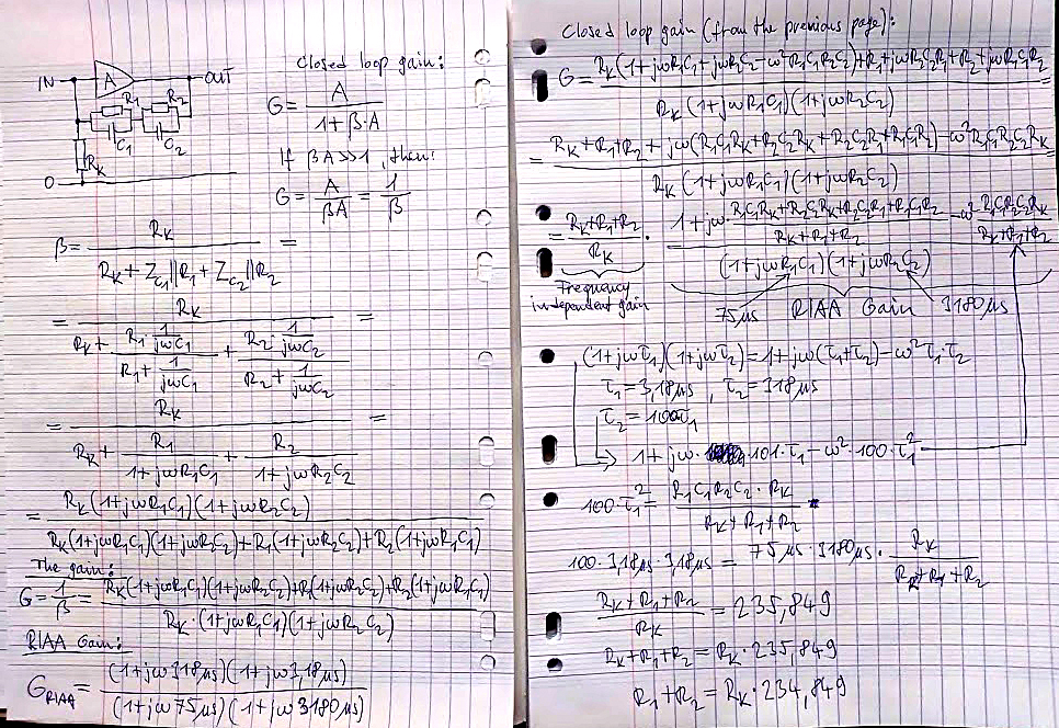

Hi!
I tried to calculate the exact values for the perfect match to the RIAA curve.
It is a bit long, so I made it on paper sheets, I took a photo of it.
I included also the 3.18us null, because it was possible. But can somebody check the math, because I maight make some mistake. I am not good at LTspice, but if somebody have time to check it it would be the best. I assumed infinite open loop gain, so it is the week point, but otherwise it is not possible to calculate it.
So Rk is the kathode resistor, R1C1 and R2C2 is in my drawing not in the circuit above.
First you have to set the Rk, then:
R1=Rk x 17.675139
R2=Rk x 217.173861
R1C1=75us
R2C2=3180us
The low frequency gain is G=235.849 at infinite open loop gain.
With ECC83 u=100 the gain is G=A/(1+ßA) =230.41
