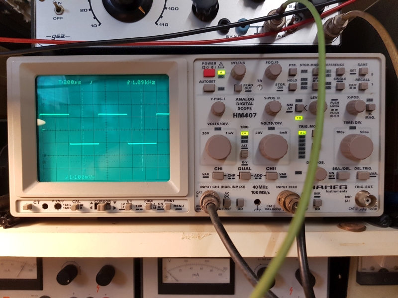

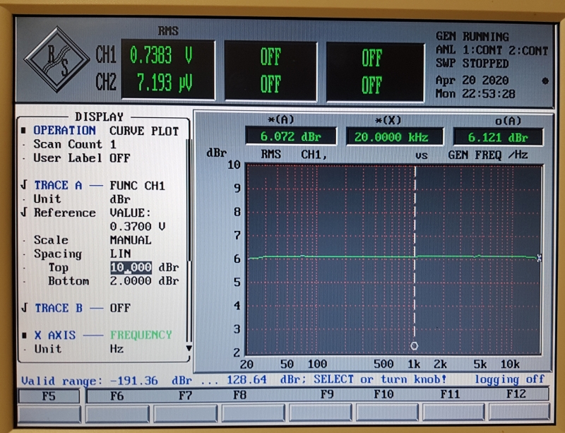

Hello ,
I use also the Hifisonix Inverse RIAA and compared it with the software RIAA in my Rohde + Schwarz UPL and it was equivalent , measured with my "Refence preamp" 😀 .
See pictures .
Kind regards , Alexander .
