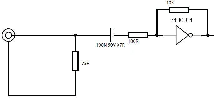

@wakibaki
bellow is digital input of actual product. What can be measured with DMM?
75R resistor? Is everything OK or something wrong with this circuit?
Please teach me, how to measure this with DMM.
My DMM will go only to 10, maybe your DMM can go to 11?

Nothing wrong here stormsonic, just measure with the DMM. The capacitor isolates the rest of the circuit at DC and the 75R will swamp everything else. You put one probe of the DMM on the centre conductor and the other on the outer. If your DMM only goes to 10, time to get a new one.
w
Ask me a hard one...
I think this WAS a hard one 😉
No offense, but I believe that the 100 ohms series resistor is effectively in parallel with the 75 ohms. The inverter creates a sort of virtual earth at it's input so the 100 ohms is effectively terminated at a virtual gnd.....
No?
