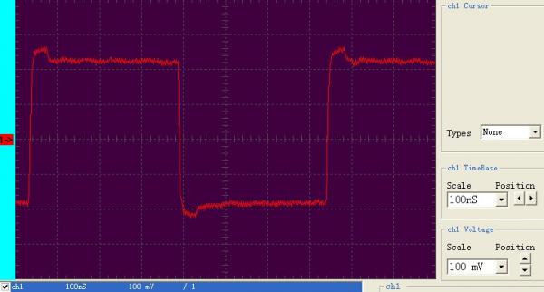

Yeah and here is real life TDR from schematic, post #174
One picture with 74HCU04 OFF and another picture with 74HCU04 ON
And input is real 75R ch. impedance with 4 m long cable
And I am not RF EE or any expert, just newbie trying to learn from experts like Joseph K, Jocko Homo & others.
Please go read some basic lessons HERE before start pesting Joseph K and Jkeny again.

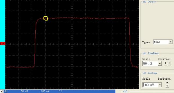

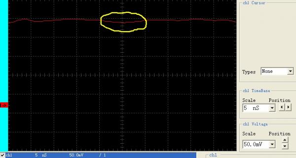

I left 100R and 10K in place and removed 75R terminating resistor and soldered a 200R multiturn trimmer to change termination on the fly and watch what will happen.
Keep adjusting trimmer until got almost perfect straight line.
Removed trimmer and measured value and got 89.2R. Soldered new terminating resistor, 88R7 value.
Here are pictures:
First picture with 50nS timebase, yellow encircled area where terminating resistor is influencing signal.
Second picture with 5nS timebase, yellow encircled area where terminating resistor is influencing signal.
To use RESISTOR CALCULATOR again: First field = 501R and second field = 88.7R and got 75.358R.
Now DMM is showing 88.7R input resistance 😀
