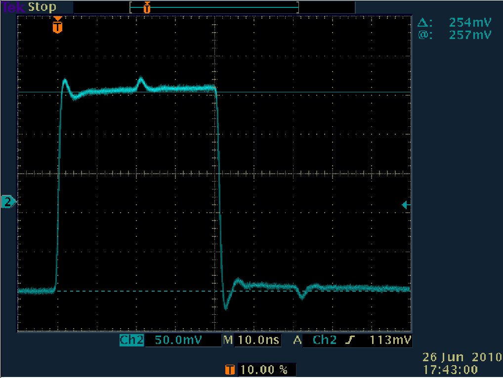

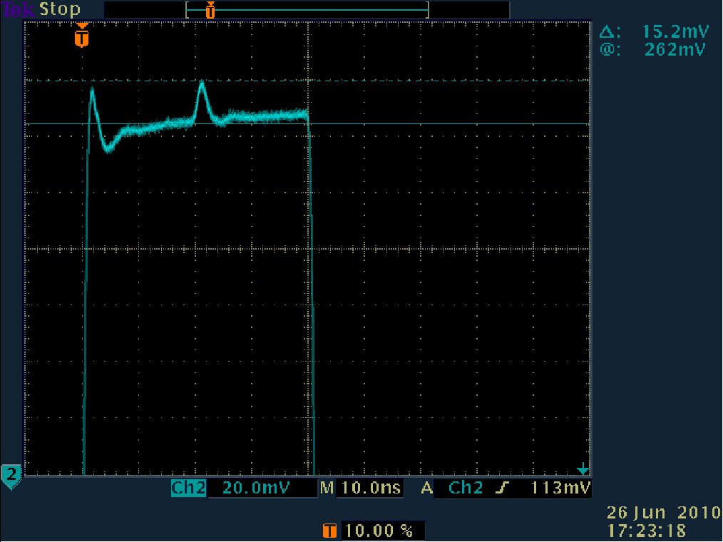

I'm again using the same 'HP generator -line-BNC tee- termination' experimental setup, with the BNC tee connected to the oscilloscope 1Mohm input.
The generator is set to produce a pulse, edges are ~1.2ns, variable width from 5 to 30nsec. The test cable has an electrical length of 10ns, so the reflection shows up ~20ns after the starting edge.
It looks like this - very similar as in the previous attenuator tests.
Because of the continuous accusations of wakibaki, I would report here again the amplitude values from the previous (attenuators) setup:
It was at
pulse height 680mV, reflection peak 40mV. ratio: 5,88%
Now from these graphs the
pulse height is: 254mV, reflection peak is 15mV. ratio: 5,88%

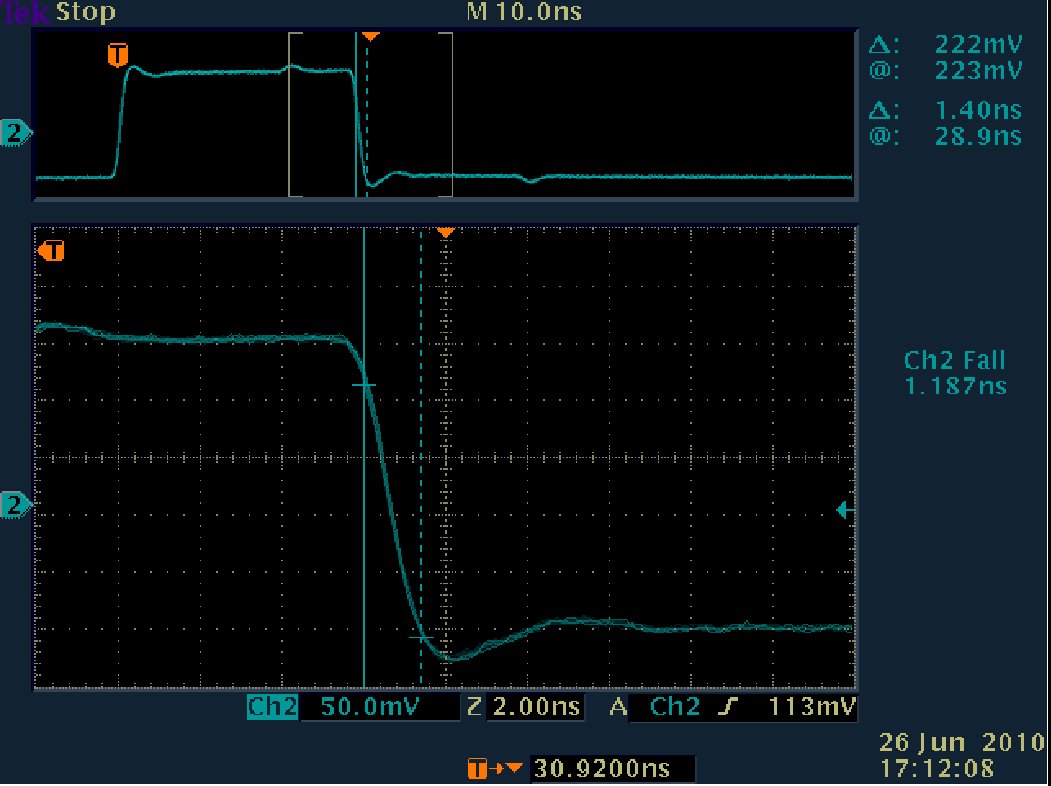

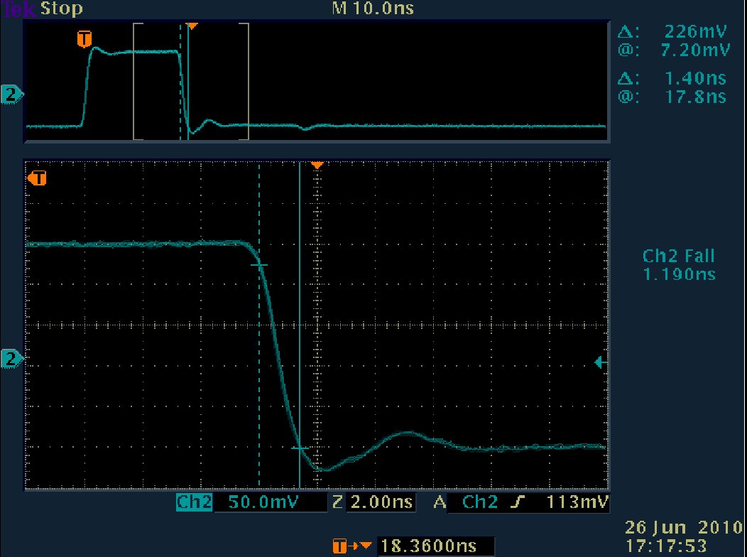

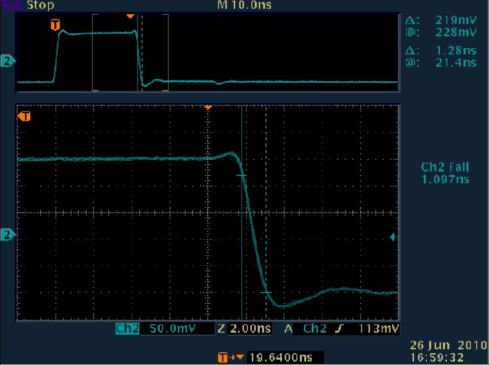

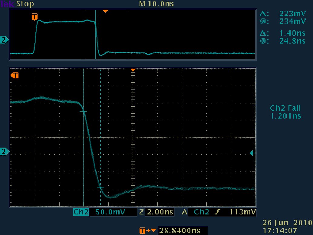

I was thinking that a possible demonstration could be the following:
The scope is always triggered on the pulse rising edge. This rising edge is exciting the reflection, which will arrive always at a fixed 20ns.
Then the pulse falling edge is varied, it is "scanning" a time interval covering /including the reflection.
The object under "suspicion" is this falling edge. As it is moving along, at a certain point it will be in coincidence with the reflection. If one can observe nothing, no deformations during this transition from before to after reflection, then wakibaki is right.
Another important point is that this edge should be constant shape, uniform in the different other points where there is no perturbation.
For control, I'm using cursors plus the built in falling edge measurement, watch for the "delta" cursor readings, and the fall time.
In the pics I'm moving backwards, 30nsec, 28nsec, reflection, finally one point before the reflection, 18nsec

I can assure You, the effect is real, I'm able to repeat it, but also, if one observes the falling edge, it's visibly changing shape. The built in scope measurement is quite an objective observer, too.
Both the cursors and the fall time give a ~100psec difference at the coincidence point.
