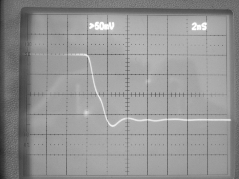

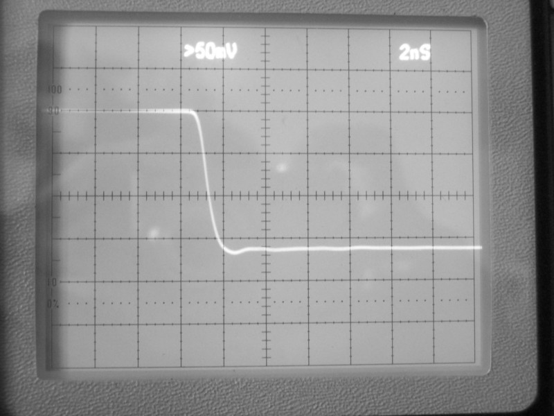

By the way, this what it looks like a Hiface driver connected directly (with a BNC "I" )
to the scope input. A USB extension cable is used for the laptop.
But be careful! The second shot is what it looks like when this "no SPDIF cable" is not terminated well..
By the way, look at the edges, and tell me that they are a strait line.
Exactly this is what happens with the smaller "wriggles" in the previous shots, only much harder to show, because of the proportions.
Ciao, George
P.S.: Compare this "nice" direct shot to the cable+attenuator one.
The small "wriggle' which is left in the middle in both shots, is not a reflection, a perturbation on the driver output.
Can I ask Joseph K - the "direct no SPDIF" (properly terminated) scope shot seems even better than the "cable + attenuator" scope shot - any room for improvement here using an attenuator on "direct no cable" connection?
The overshoot in both scope shots is not the small wiggle you are talking about I presume? Is this from the Hiface transformer or the driver, do you reckon? Is the samll wiggle of significance & any idea what is the origin of this?

By the way,
It took me ~half an hour to assemble a demonstration of the effect of reflections on the falling edge of the previously used HP generator. The scope is a good old 7104.
The first shot shows the generator signal.
the second shot is where I had deliberately introduced strong, fast reflections so that they partially fall on the original edge. Note that "strong" is not a big amount anyway!
Also note that the fall time of the original edge is ~1ns, close to the real life value ~2ns of the Hiface driver.

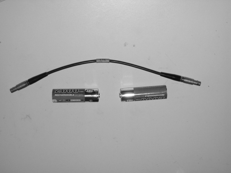

By the way,
We had to go to considerable lengths with very fast rise times, a very expensive oscilloscope and long, long cables for a university lab demonstration of reflection in digital systems,
