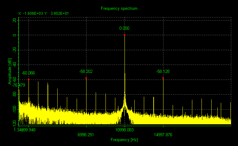

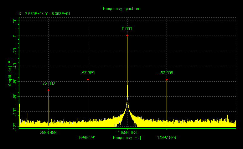

Just as a preview, here are 2 FFTs of my built in RealTek card feeding the analog inputs of an M-Audio USB Fastrack Pro. One is the signal with built in jitter, the other without jitter.
You can see there is a lot of mess down low. But I left the markers in the same place so that you can see the difference. It looks much, much cleaner using the same card for in & out.

Not quiet the perfect equipment for analogue waveform analysis as the loopback test would suggest, probably? Would you have the same for loopback graphs? We have a high noise floor & spuriae reaching up to -60dB - hmmm. So this would be the base level. You don't happen to have the cards that SY is intending to use, do you?

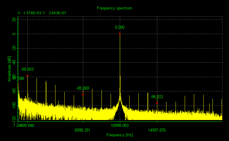

Here is the loop back signal with built in jitter in the same card. (M-Audio). Much cleaner.
Don't know how much of the noise above is the Realtek output and how much is the clock mismatch.
I'll look int the rms values. I do not have the same cards as SY.

Indeed it isHere is the loop back signal with built in jitter in the same card. (M-Audio). Much cleaner.
Yes it could be from either but the important point is it's showing the full system noise & resolution i.e if this was your measurement system you would have some knowledge & appreciation of what can be revealed by it? Maybe Joseph K, T or indeed SY have something more to say about this.Don't know how much of the noise above is the Realtek output and how much is the clock mismatch.

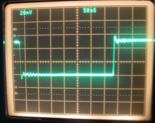

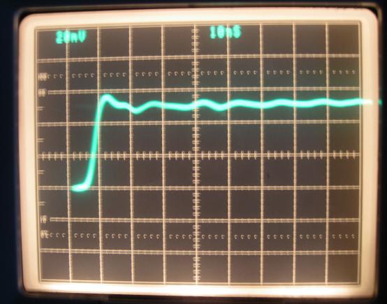

Eh, what did you state already - remind me. What scope/speed? etc
Why did you use a 72R termination - you know the SPDIF standard is 175ohm, don't you? You need to give some detail about this set-up for your credibility.

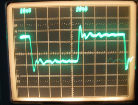

Here's the previous 20ns scope shot with attenuators
Compare & contrast with SY's

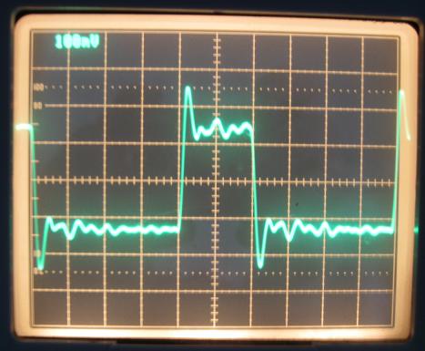

Looks the same, just lower. The attenuators work.Hiface spdif signal at receiving end, setup as before, two attenuators.
- Digital Source
- RF Attenuators = Jitter Reducers
