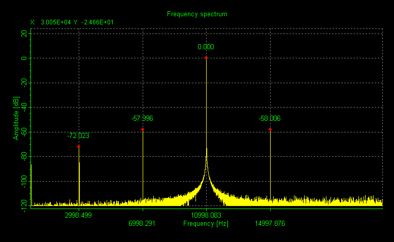

Maybe you are missing the basis of what's gong on here. It is claimed that these devices reduce jitter. They may, or they may not. But what is important to most of us is the resultant analog signal. That is what we listen to - not the spdif signal.And please don't tell me that measurements of a single frequency wave is the same thing as a musical passage.
FFT is a very powerful tool. Jitter can be seen in an FFT of the analog signal. A singe tone makes it very easy to see. Have a look at the signal below. It should be a single peak at 11Khz. The extra spikes are because of the jitter. On a decent system, you can hear it. If jitter affects music, it will affect a single tone. If jitter is reduced, then you will hear the difference and see it on the FFT. It's that simple. The effect would be the same on a complex musical signal, but it would be much harder to see. And probably much harder to hear.
The scope shots are also interesting. The Hiface interface seems to have a lot of overshoot and ringing on the spdif signal. Does that effect the decoding of the signal? Probably not.
For me the only question here is: Are the test instruments sensitive enough to detect small amounts of jitter?
Is it? You take jitter as a single number! Maybe looking more into the type of jitter & the spectrum of it would prevent it being treated as THD was treated in the past - a single numberMaybe you are missing the basis of what's gong on here. It is claimed that these devices reduce jitter. They may, or they may not. But what is important to most of us is the resultant analog signal. That is what we listen to - not the spdif signal.
FFT is a very powerful tool. Jitter can be seen in an FFT of the analog signal. A singe tone makes it very easy to see. Have a look at the signal below. It should be a single peak at 1Khz. The extra spikes are because of the jitter. On a decent system, you can here it. If jitter affects music, it will affect a single tone. If jitter is reduced, then you will hear the difference and see it on the FFT. It's that simple.
MaybeThe effect would be the same on a complex musical signal, but it would be much harder to see. And probably much harder to hear.
