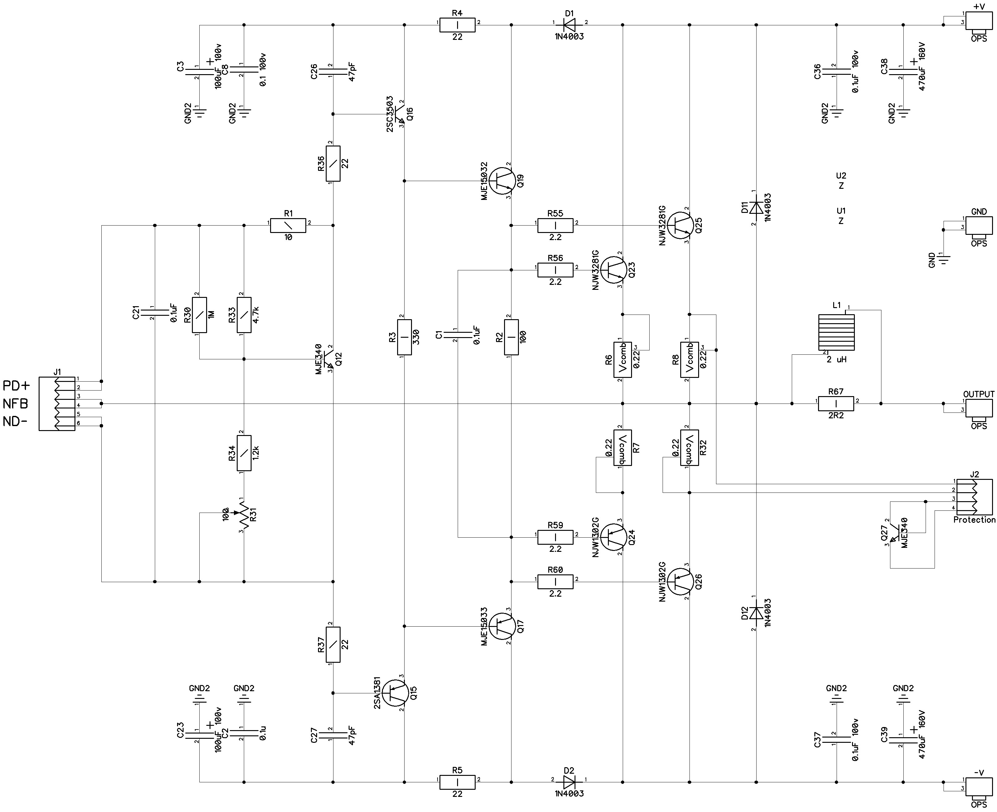

Hi Jeff,
Do you have a working model of this OPS? I'm going over it because it didn't work. Do you have a schematic with the correct values for the VBE multiplier? The schematic I have shows D3 in circuit and NJW3281/1302 for the outputs. I have to assume that if D3 is bypassed then the other resistor values must change as well.
thanks, Terry

I've got some boards assembled, but have never installed output devices yet. All the values in the schematic are what Valery simulated to work. We added the LED into the schematic after for future use wit hexfets. What is the board doing?

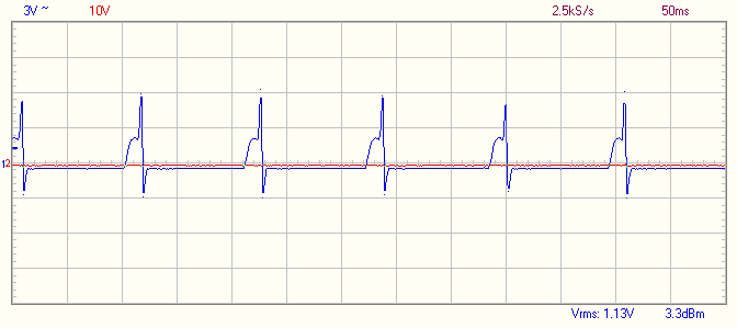

mini-OPS
Gentlemen, please start with R34 = 1.2K or even 1.3K
R31 trimmer is in maximum R position.
This will ensure the minimum bias.
I fighting everything right now. What is the testing procedure for stand alone OPS? I have tried each of the IPS I have built and they all act different. The X4 and the VFA both cause the light bulb to light and let only about 5V rails. The CFA doesn't bias the circuit at all. I'm presently trying my best to go over each transistor again and making sure I have no sold joints or bridges. I did this twice before but hopefully I missed something. I tried hooking up the IPS's stand alone by shorting all of the pins for the PD+, NFB and PD-. The X4 shows good vb-e for each of the TO-126 transisors but I haven't tried measuring the tiny ones yet. I need to familiarize myself with the layout so I am not trying to touch the legs with a probe.

Terry, the approach is right - it makes sense to test the IPS boardsxstandalone first, to make sure they work as expected - no offset, VAS current is 5.5 - 7.5 mA, they amplify the signal.
