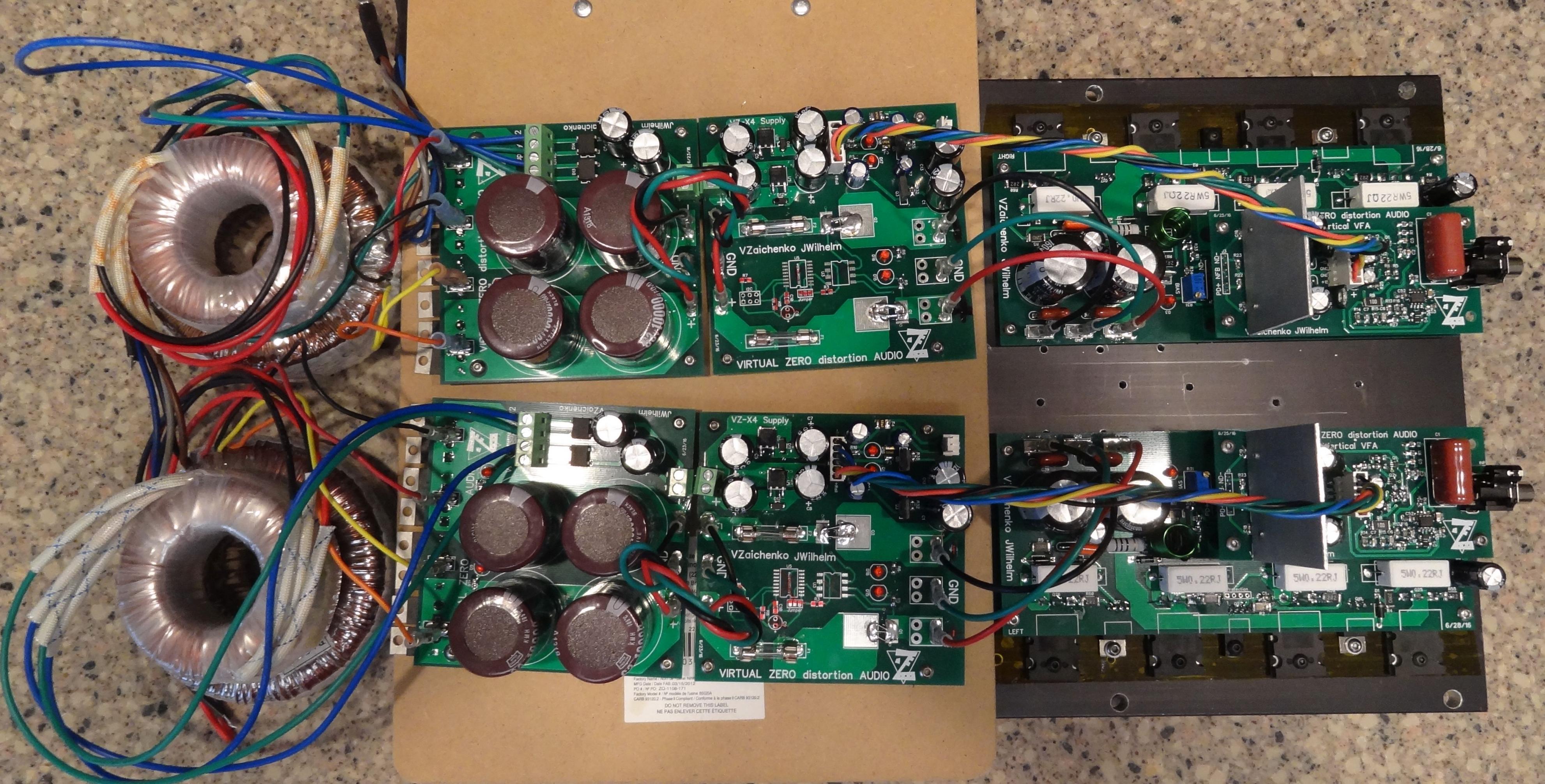

Ready for testing
Well, just about ready for testing. Man this thing burns up some real estate. 😱
I need to clear off my bench before I can do any more. I also want to read back through the thread to refresh my thinking before I start testing. I want to be sure I understand how to adjust everything before I go any further. I have all three IPS sections ready but I think I will start with the VFA since it seems that is the most stable.
Blessings, Terry

Hi Terry,yours is a little different output board.
Terry's building the Mini Modular output boards. It uses the same input boards as the NS series, but is a smaller simple EF3 design. It's basically the same as setting up a Slewmaster. It also can be adapted to Hexfet output devices. The input boards can be run standalone with 100R jumpers to NFB as we did with most other modular input boards.
Your tests will diffidently be useful as nobody has run this one yet. You are using BJT outputs. The LEDs on the output boards should be removed and jumper wires installed. The LEDs are for Hexfet outputs.
I wish I had realized this. I used MJL21193/94. Those have proven troublesome with an EF3. I will change those out before I test. These boards have been quite a journey.
I think Valery has already simulated these with MJL21193/94 and said they were fine. I need to read back through the thread to be sure though.

My biggest issue with the surface mount parts is that I don't have them. Every time I think I have all the parts I need, I discover I am still missing something. I have placed orders 5 times trying to get these boards completed. I know if I want to stay in this hobby that SMD are inevitable so I am learning.
