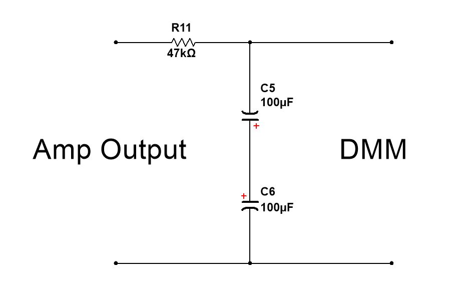

Thus a scope is the better tool for this test measurement.I wonder if this has to do with the sampling rate of your voltmeters.
Higher sampling rates on the DMM, until the digits are flashing so fast that you can't make out whats up 🙂
One servo test that Bob C. recommends is very low freq at full signal, see where the servo clips. see p 169.
Right, the result very much depends on what exactly you (or Fluke) treat as DC.
That 8V peak - for how long was it there? If some 100mS, it's not DC any more ))
For proper measuring, you need to integrate over some time.
I believe, the attached circuit would be a perfect "calibrated" integrator - exactly the one we use at the input of speaker protection.
Interesting,i will use this circuit together with an electronic analog voltmeter.Right, the result very much depends on what exactly you (or Fluke) treat as DC.

I've added the filter to my meter readings. the offset climbs very slowly to 33mV at 20kHZ clipping. Sine sweeps are much improved. hard clipping will creep up to 100mV. This is with the input board running standalone. I can see a test fixture to place the input boards on in the near future. he weight of my test probes keeps unplugging my 100R jumper plug.
With the filter in place, my Fluke 18 reads the DC offset exactly the same. The cap must be charging so it can actually read it now.
Well, this is a rather acceptable level of the offset. Fluctuations within +/-50mV (even +/-100mV) are no harm at all.

Try the AC filter, you can watch the servo in action quite clearly on the output of the input stage. It's working, but is definitely less effective at hard clipping.
I ran the Vertical CFA with the AC filter in place. The servo was operating acceptably but slow on it. The change to a 1uF cap really picked up the speed of correction. It zeros out faster on power up too.

When I apply a large signal I can watch DC offset appear, then zero itself out. With the 4.7uF cap it's pretty slow at 20kHZ, but with the 1uF cap it's much faster. If I apply a very high input signal (5V P-P) offset slowly climbs, and then creeps back down, then levels off around 35mV.
A fresh test with your DC detection in place and a 1uF integrator cap might solve the triggering issue. Your speaker may have expired in the couple seconds it took for the servo to correct the offset.
